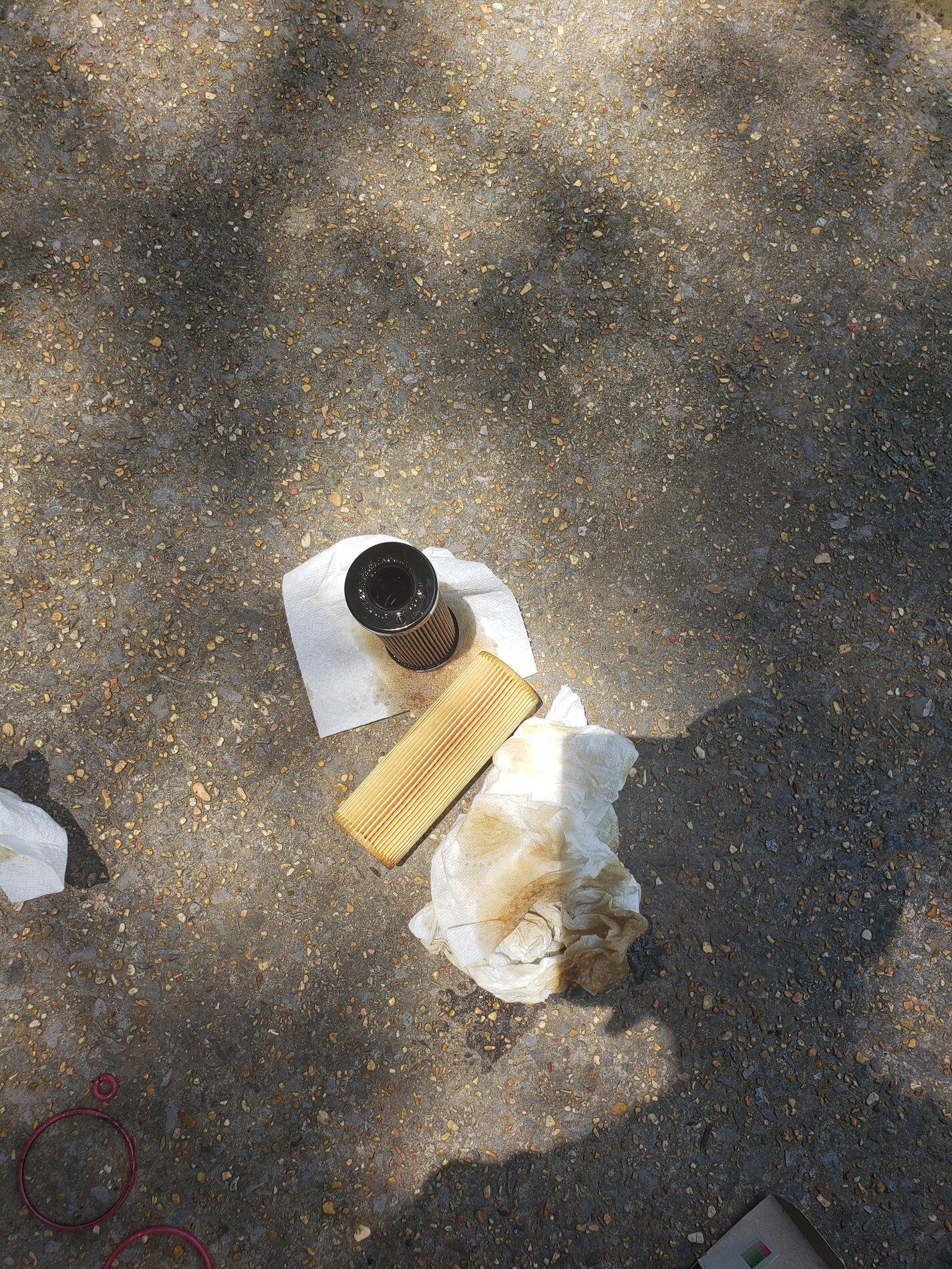

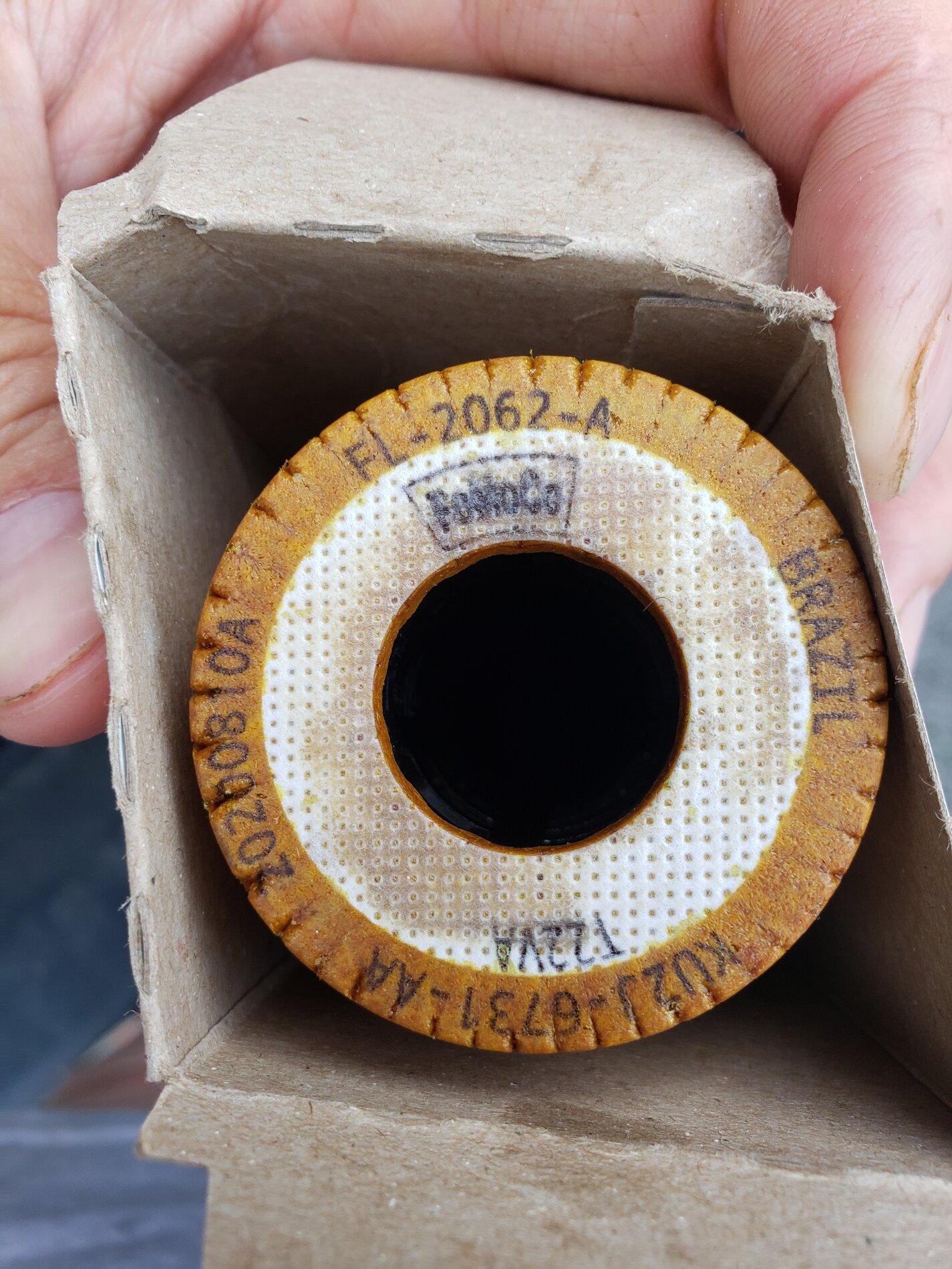

I had trouble getting a filter...you can't just walk in to O'Reilly and ask for a 2021 Bronco filter. I got the part # from Ford and O'Reilly had them, but not OEM. But Wal-Mart had Motorcraft, and had one left. But question for those who know: why does the new one not have the black caps? Is this normal?

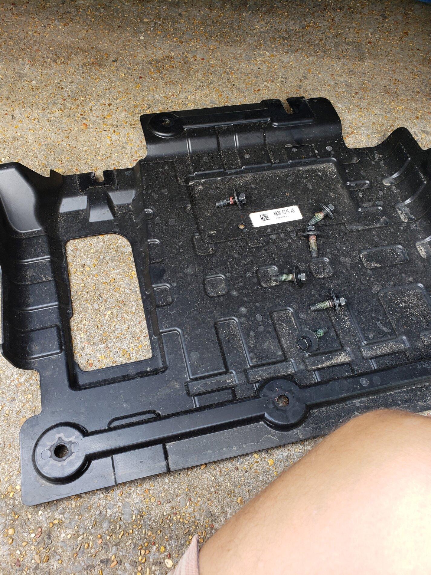

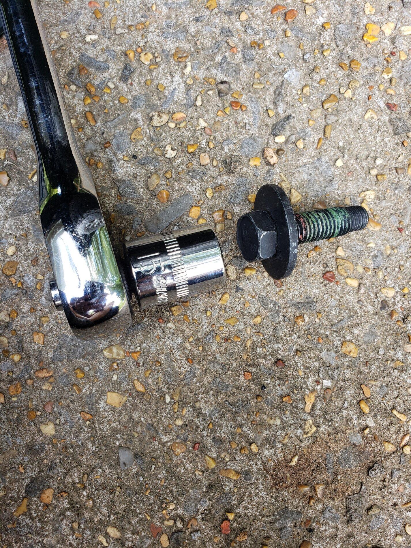

Anyway...I removed the skid plate-factory BB plastic one-using a 15mm socket to take out 6 bolts. My 15yo handled socket duties.

Confession: I haven't changed my own oil in years, so I've never used the plastic plugs. It was easy to take off (a quarter turn), and they weren't joking about it coming out quickly.

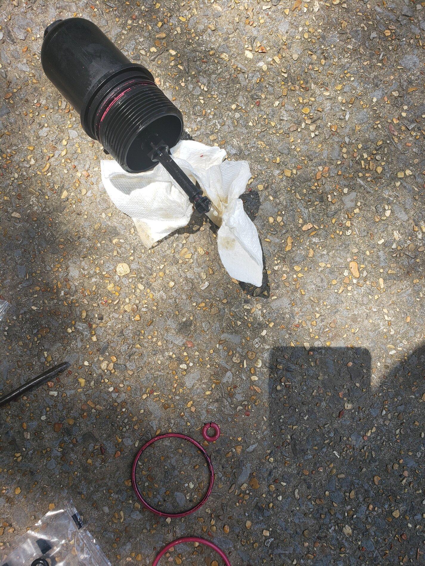

I also have never seen the top-of-engine filters, so I watched the video to find it. I didn't have a set of large sockets with me camping, so I had to use Vise-grips to get the housing off. No trouble.

I didn't install the new filter because of my questions about the caps, but I changed the rings. As in the video, I cut the small one with a razor knife to get it off. Getting the new one on there required some patience to be sure.

Nice, looks almost exactly like my Grand Cherokee filter. I'd not worry about the different color caps, just different manufacturer I'd guess.
Different colors would have been fine. But there were no caps on the new filter.

Round dots are parts that come with the filter. If you get the cap it comes with all the yellow square parts. Color of the filter ends shouldn't matter as long as the height and diameter are the same. The politically correct answer from the dealer is, "you should only use Ford or Motorcraft parts on your Ford vehicle OR parts that meet OE engineering specifications."

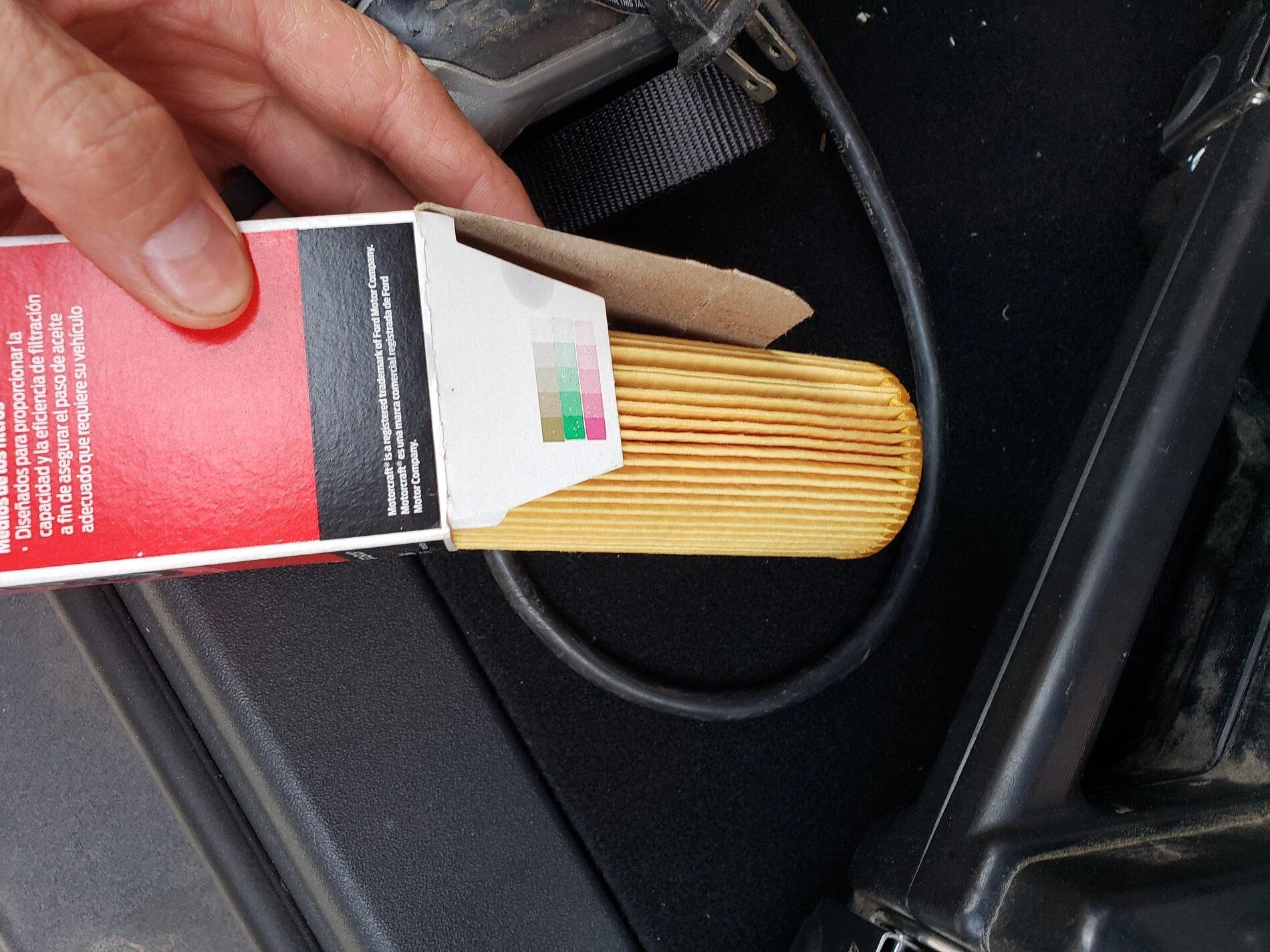

I got an OEM Motorcraft 2062 a. But it didn't have the black plastic caps at either end of the filter as shown here:
Ford Bronco A First Oil Change Experience on 2021 Bronco – Using OEM Oil Filter 20210722_124246
the new filter is laying down while the old is standing up. Note the black plastic cap facing the camera on the old one vs the bare ends of the new.

That replacement filter doesn’t look right to me. I have done my 2.7s several times and the Motorcaft filters always looked like your original. Maybe you transfer the ends now? I would have hesitated too. It’s ridiculous how fast and far the oil shoots out!

Automakers will specify a visual difference in factory installed filters vs replacement filters.

As difficult as it is to take off the small o-ring and put a new one on; makes you wonder if you're local Jiffy Lube even bothers changing it.
