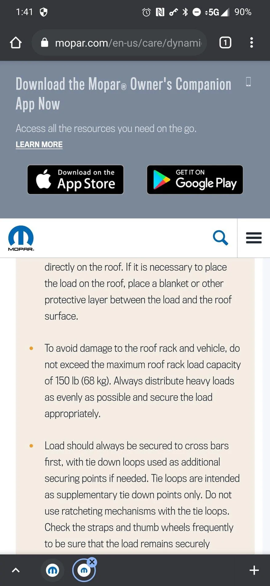

Why bring up Wranglers or Jeeps. They aren't made by Ford and Ford's ratings aren't taken from the Wrangler. They're a different vehicle, made by a different company altogether.
Because they're load ratings. They're dictated by physics and materials construction. The Wrangler is analogous to the Bronco due to both being convertible off-road SUVs. It has nothing to do with an issue 30 years ago with two completely unrelated other than brand vehicles.
The dynamic rating for the Mopar rack (closest to factory rack you'll get with a Wrangler) is 150 dynamic. That rating exists because you're anchoring a rack into a structure largely consistent of fiberglass/SMC. Any more weight than that and you risk ripping it out of said fiberglass/SMC top during harder driving due to the limitation of those materials. The Bronco also has a removable SMC top. Now, if you were to attach to rack to say, a steel reinforcement it would have considerably different properties before yielding. Going to an aftermarket rack that is anchored properly to a sturdier point allows you a far higher carrying capacity. Your concern then would be exceeding payload which is generally frowned upon. The payload on the Bronco is somewhere in the neighborhood or 1200 pounds which allows for plenty of weight for the rack, your tent, some gear and the people in the tent/truck.
