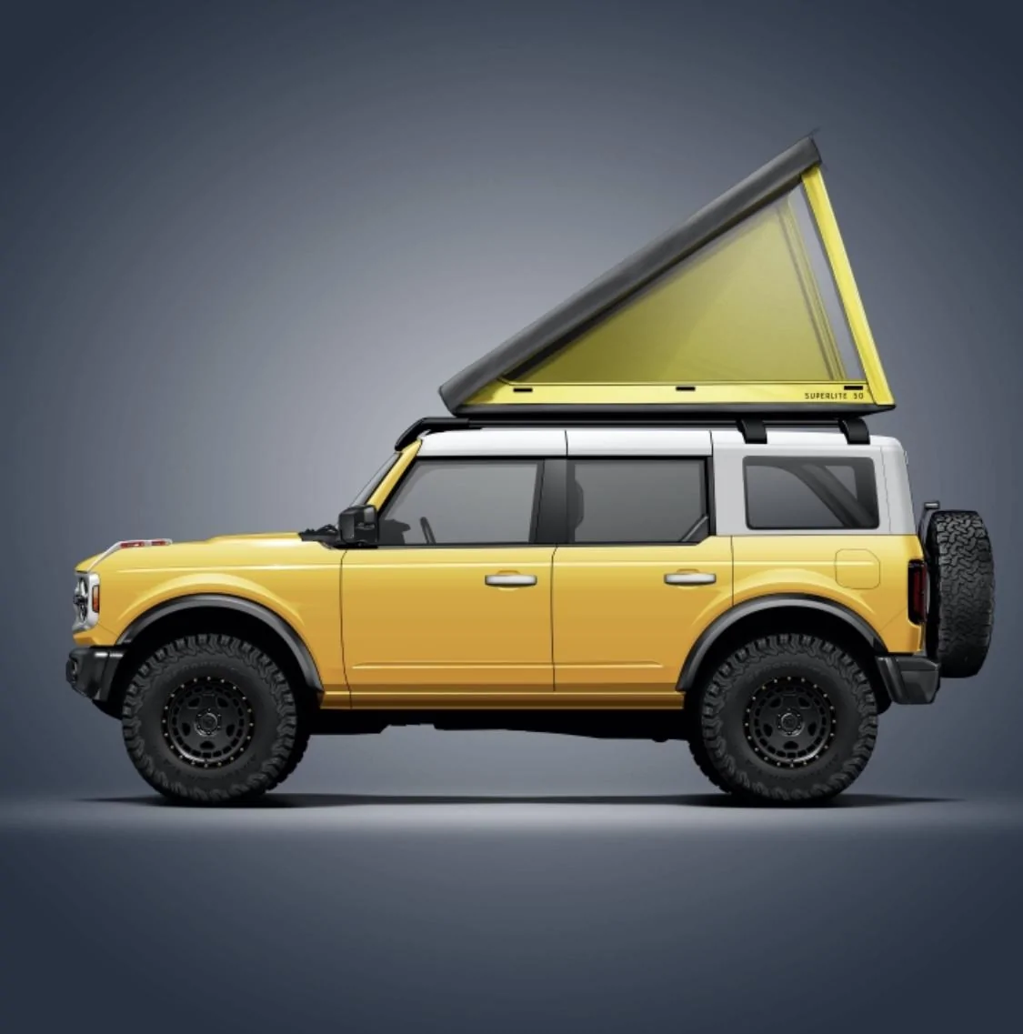

I am hoping this fits given it’s one of the few RTTs that is not overweight for the roof rails but the length might be too long for 2dr.
On the Instagram post from GFC (where this CGI render came from), they commented in the comments that it will work for the 2 dr.
