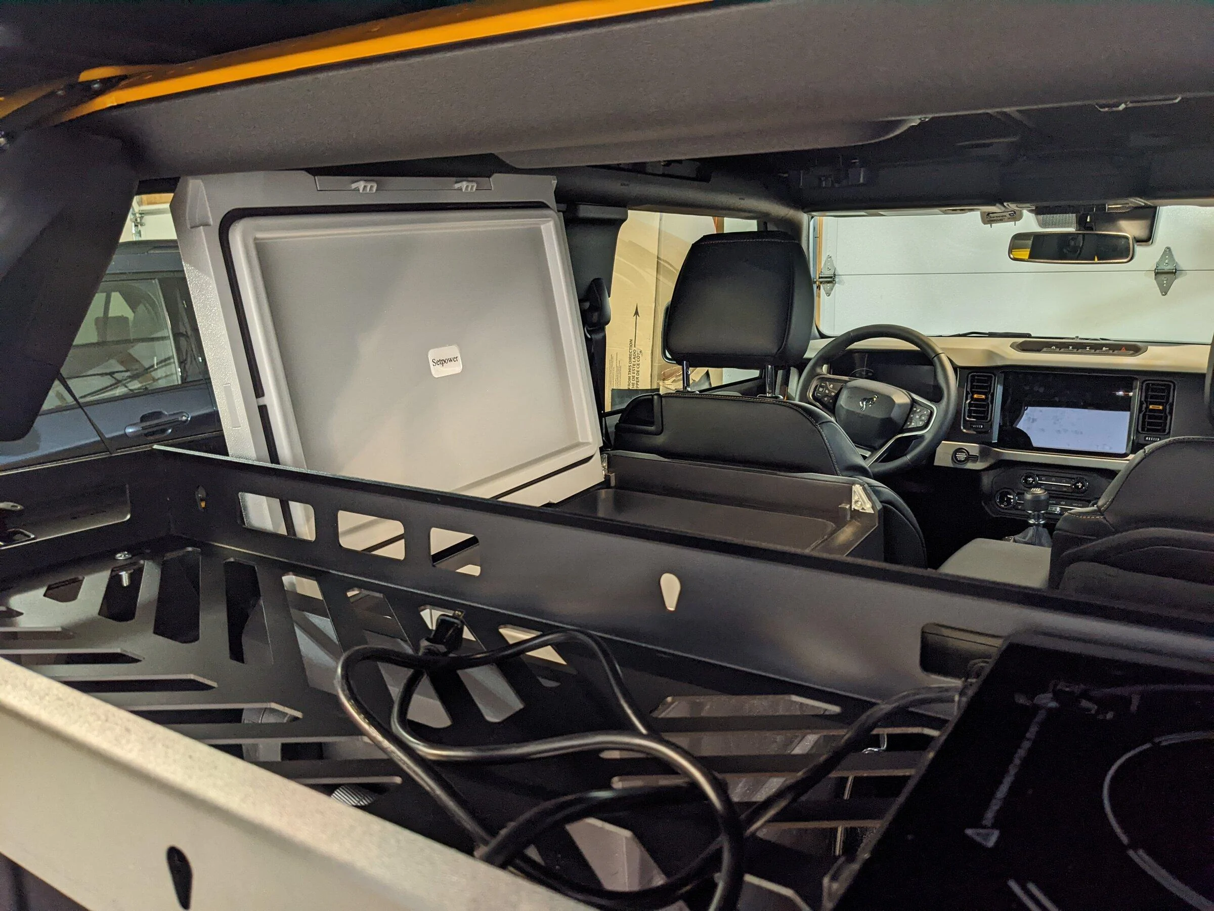

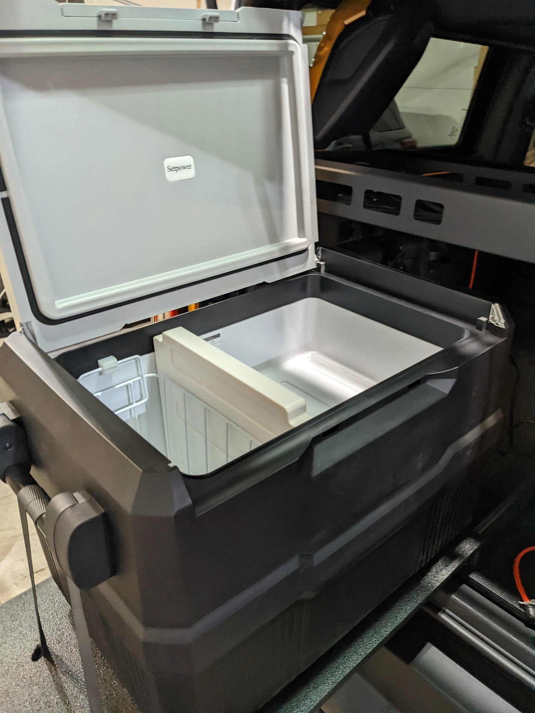

Actually that fridge is right next to that single rear seat, so easy access. Only minor "Drawback" is the fridge door touches the roof just before the door could stand up on its own, so it takes a little extra effort haha
Oh I thought the shelf was still above and blocking it. So I'll change to 10/10

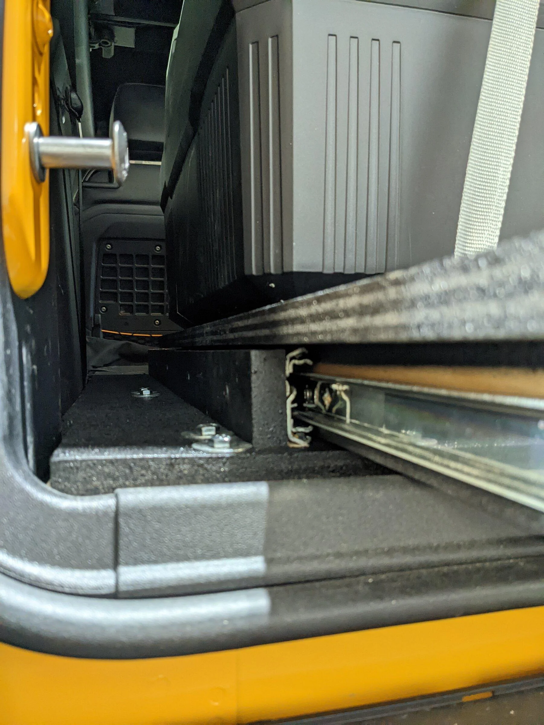

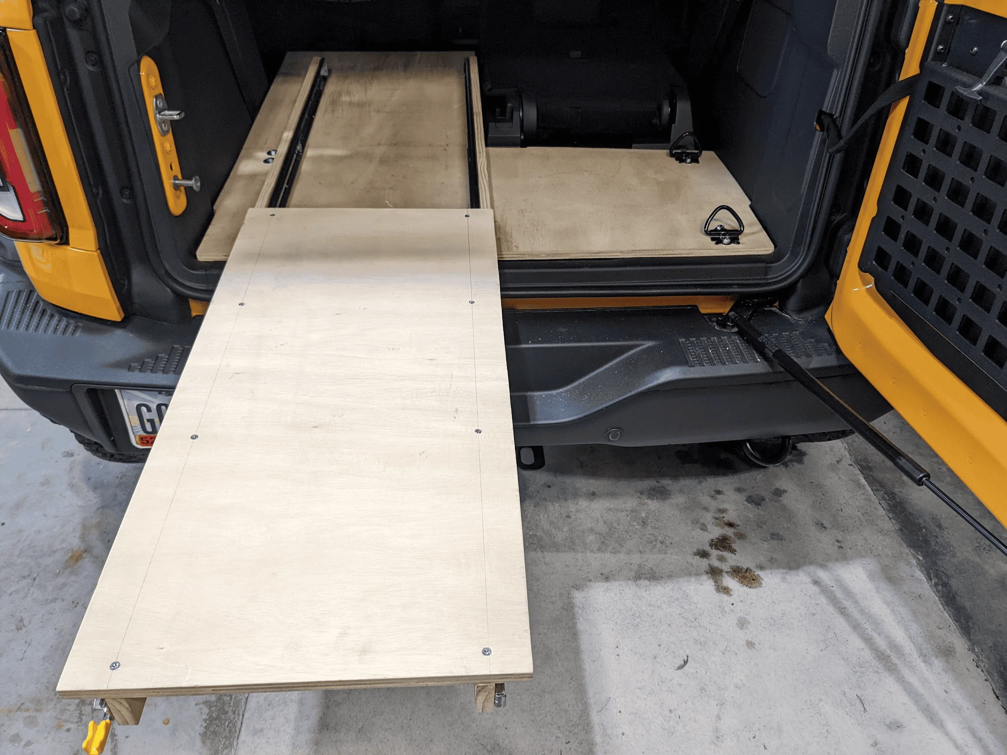

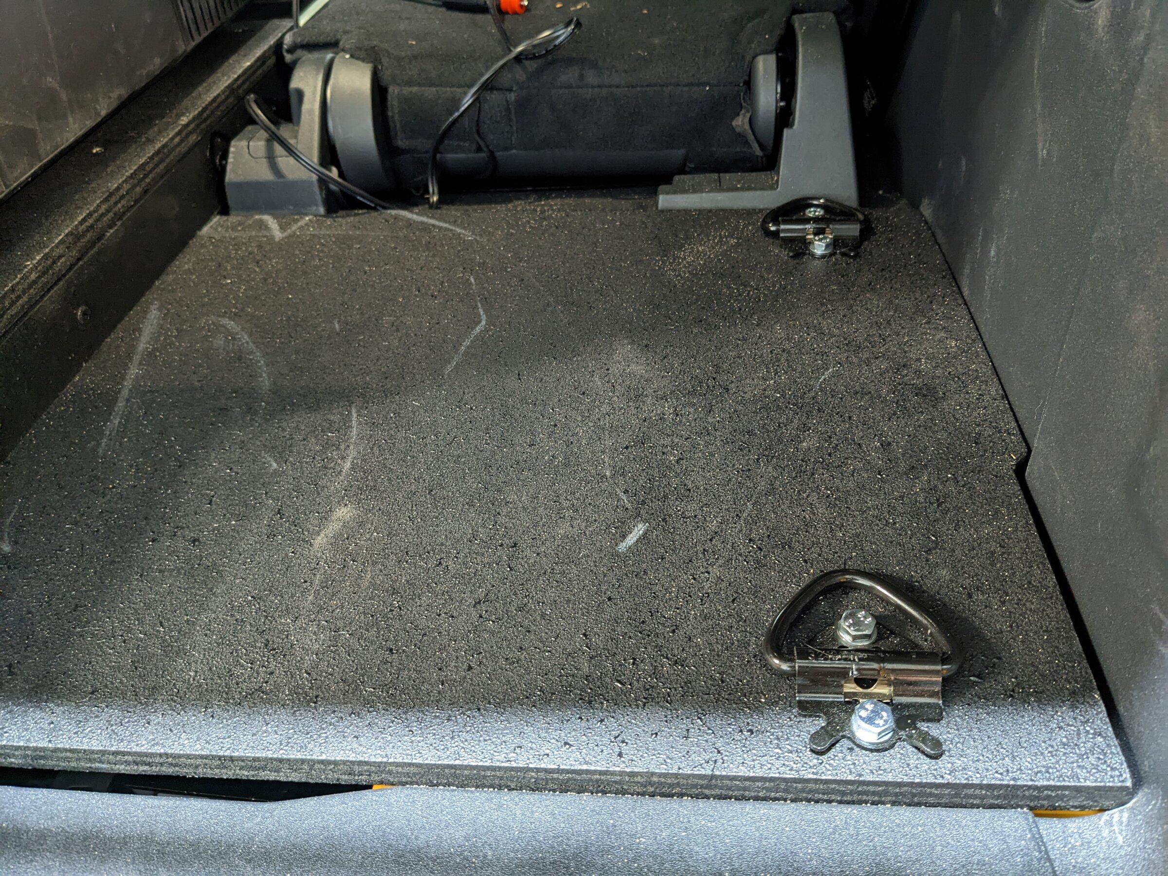

Yeah, I built it with 3/4" plywood Can unstrap the fridge and could slide out the top shelf, but that would leave the 2 inch high lower slide wood pieces. The whole thing, including the floor, comes out with 8 13mm bolts.
It barely clears on both ends when it's in and out. I got lucky. And I forgot that moving it back a little to clear the shelf makes it so the door can fully open.

Can you say more about the things you didn't post links for?
Like... Do you like the Setpower cooler and which model is it?
Did you answer the questions somebody asked about the slide out? Did you make it or buy it from somewhere?
How was is deleting the driver's side back seat? Any issues?

Thank you for posting so many pictures and I will be watching for more.

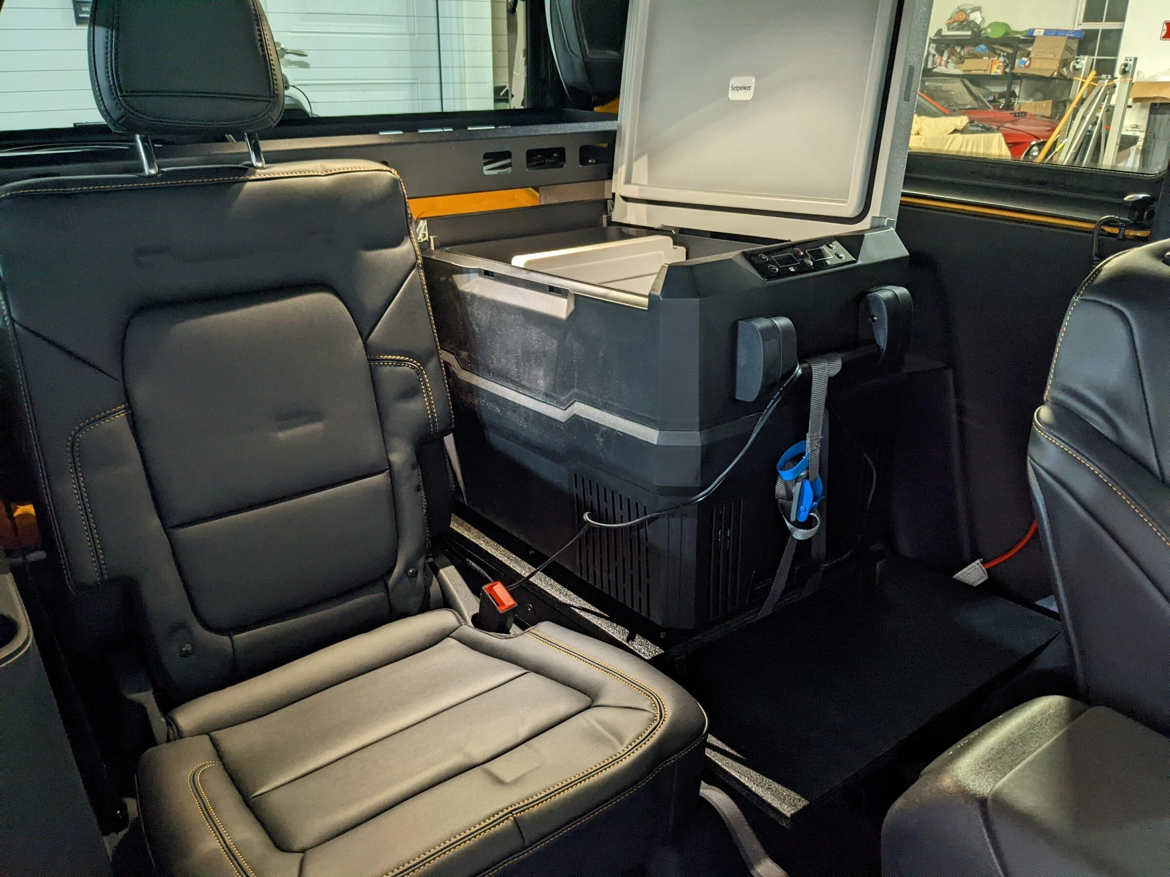

It's a SetPower RV45d. Dual zone (Freezer option). https://www.setpowerusa.com/collections/rv-series/products/45qt-rv45d-portable-freezer-fridge
Removing the seat was easy, but you do have to take the belt latch off the removed seat and plug the wire harness back into the Bronco and stuff it under the floor so you don't throw an error code.

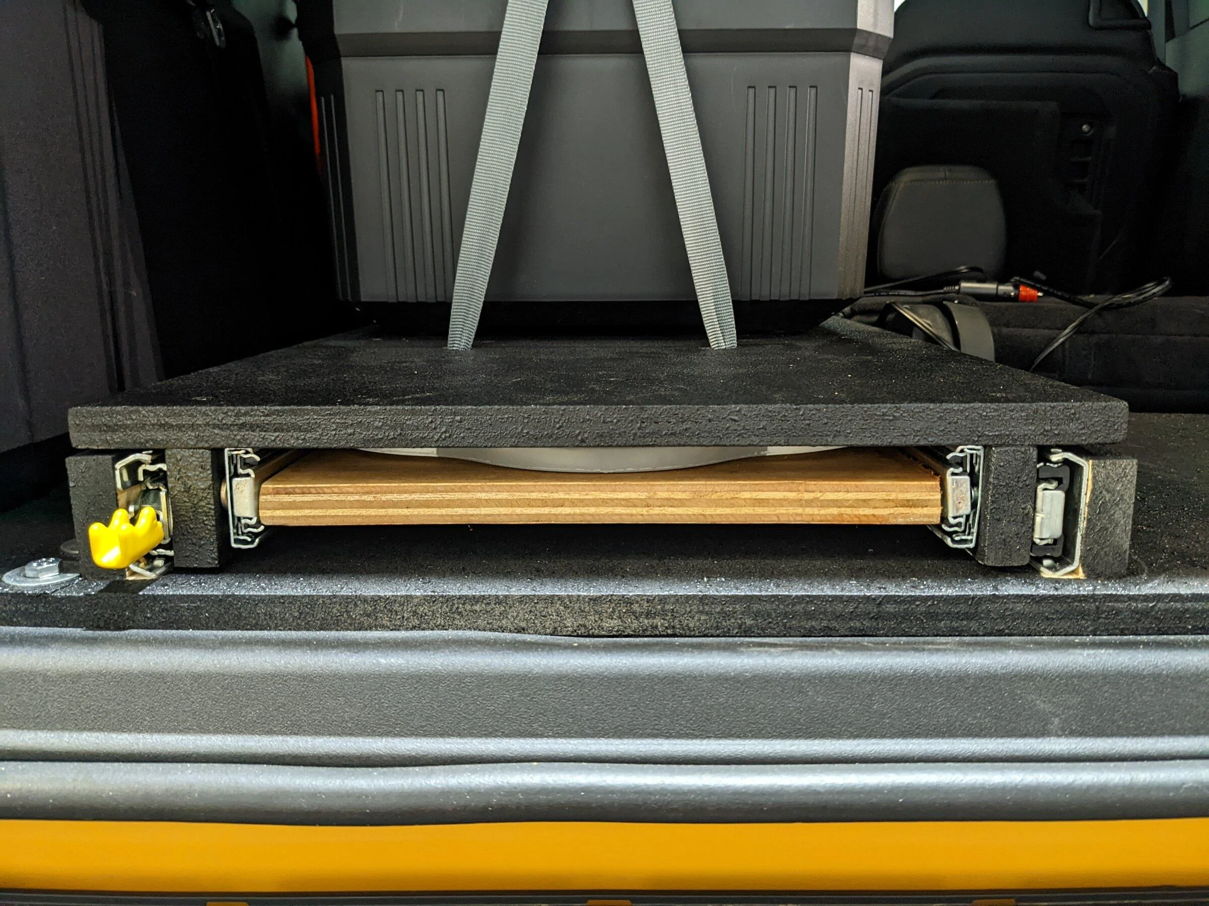

I made everything out of a single 4x8x3/4" pine plywood sheet and I also bought a 2"x8"x6 foot 3/4" pine board for the slide attachments.
I removed the 8 bolts holding the tie down points. I just measured and cut for the main floor. I'm not expert wood worker, but this was pretty easy. I then ripped 2 inch tall pieces to "T" onto the base to attach the slides to. I bought longer bolts to reattach the tie down hooks on the passenger side and washers on the drivers side. Several Home Depot trips to find the right hardware to use with the drawer to make it strong yet have the clearance to allow the slides to work.
The factory 8 bolt locations are the only thing holding it on. I don't have any bolt down point up near the front seat and it is in there good.
Slides:
https://www.amazon.com/gp/product/B00PHL3RF2/ref=ppx_yo_dt_b_asin_title_o03_s00?ie=UTF8&psc=1
https://www.amazon.com/gp/product/B08YY839QC/ref=ppx_yo_dt_b_asin_title_o08_s00?ie=UTF8&psc=1

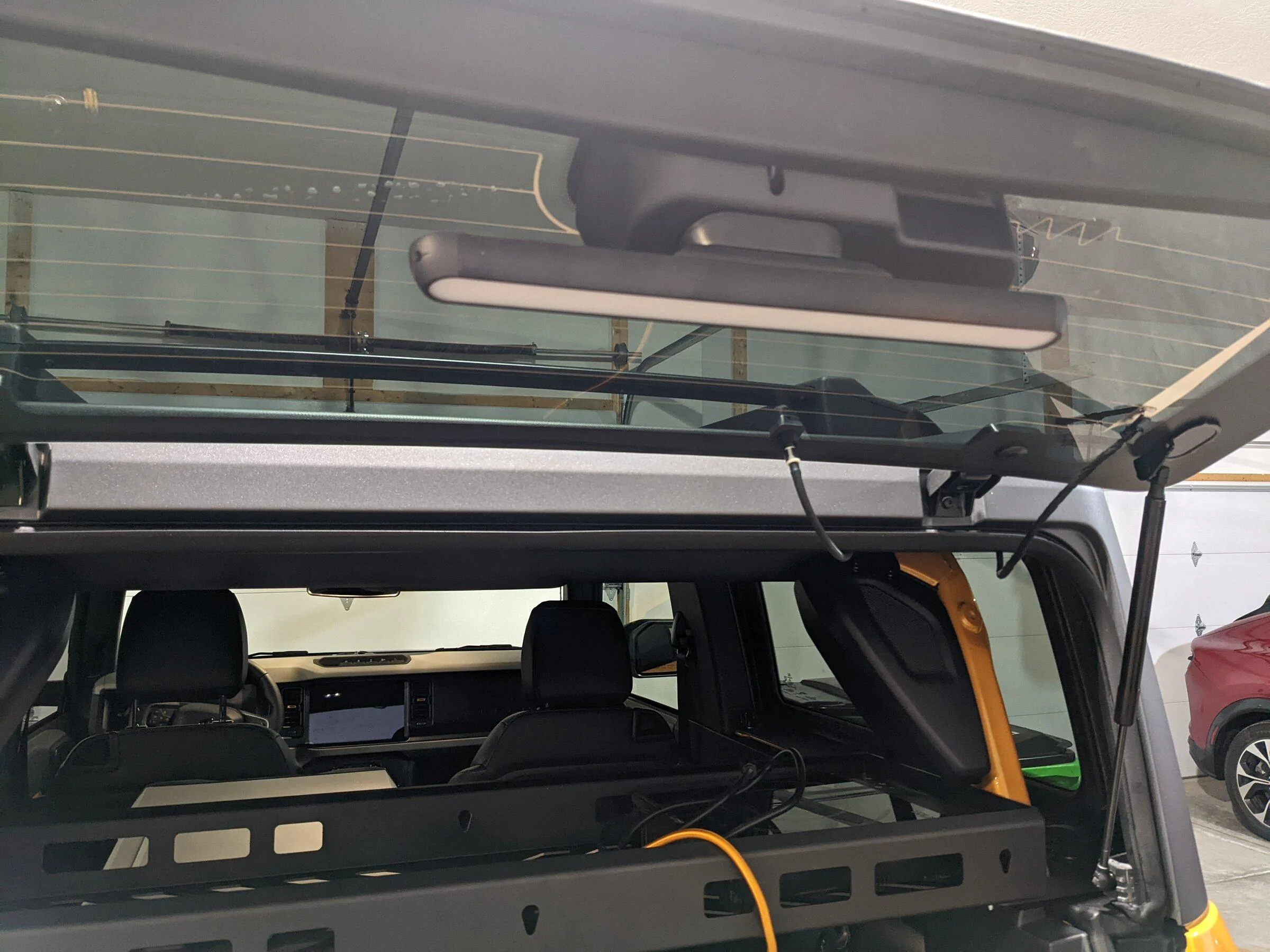

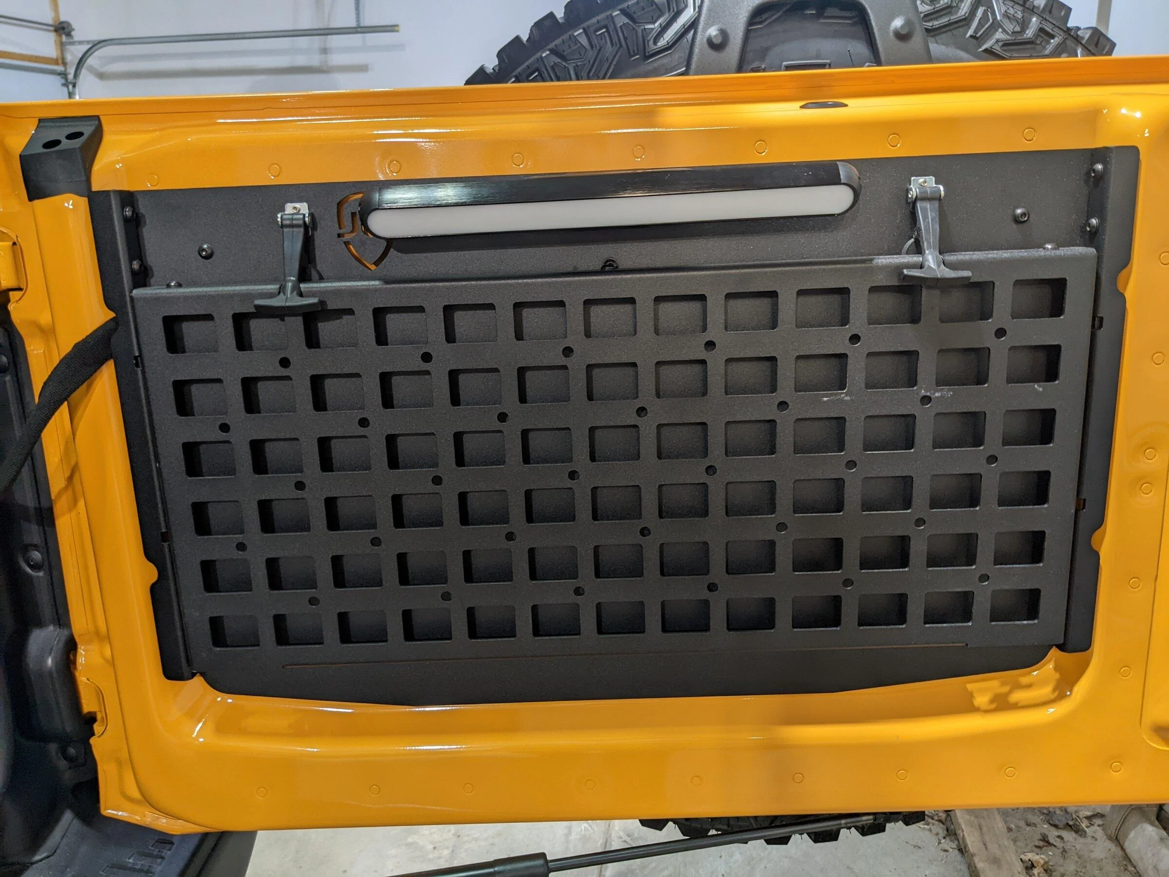

I found this cool light on Amazon that is USB rechargeable and has 2 mounts. I put one mount on the tailgate table and the other up on the rear wiper motor.
https://www.amazon.com/gp/product/B08LGJGJ97/ref=ppx_yo_dt_b_asin_title_o04_s00?ie=UTF8&psc=1

Nice work! Any negatives on the JCR table?
