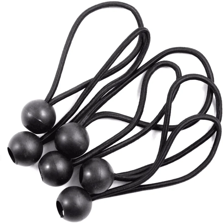

How’s that moon shade attaching to the factory roof rack? Anyone have thoughts on how to attach to just the hard top? Thinking of pulling the trigger on these but struggling on how to attach it without damaging the roof, I dont have a rack at the moment.

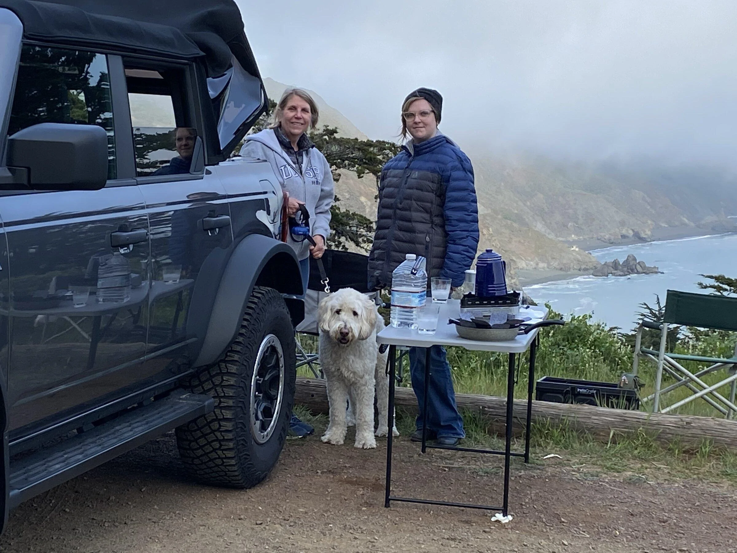

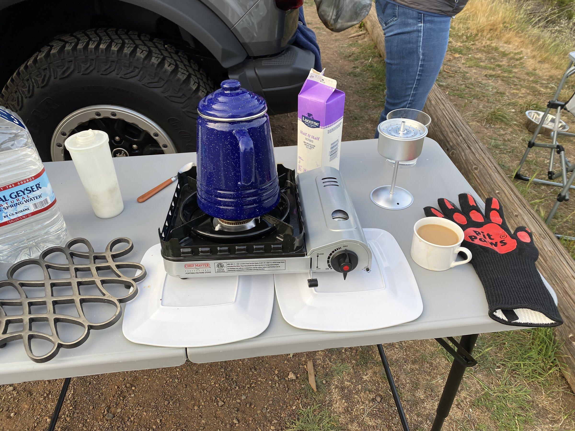

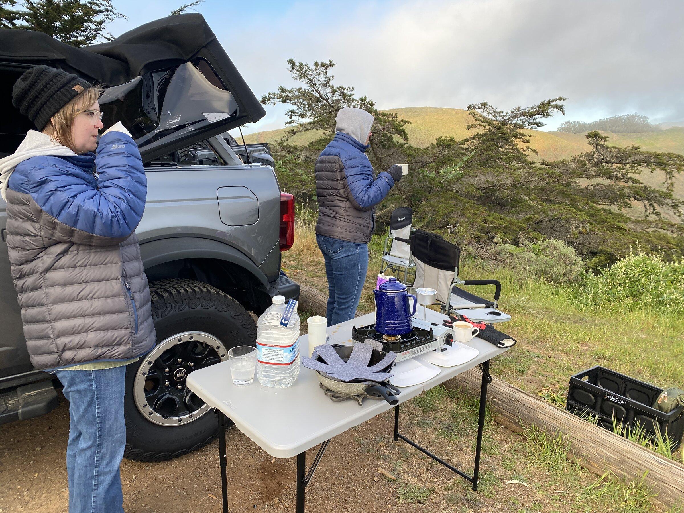

nice! where's the nuclear powerplant go?
what exactly are you implying???😃😁😂
The 110 ac outlet in the Bronco puts out 450watts tops….
and that induction cooktop needs probably at least 1 kilowatt to boil water.
Hmmmm what is going to power this???
I hear and see what your saying.
I like the overland concept and in a way I am very jealous…. Replace the induction cooktop with a 15000 btu butane cooktop and problem solved…

I think you may have missed this..
Went with the Zendure SuperBase Pro 2000. Got in on it through the Indiegogo campaign. I thought I'd have it by now. Hopefully it's worth the wait
Lake Tahoe Traveler
Jul 21, 2021
190
557
Sf Bay Area, CA
2022 Bronco 2dr BL SASQ, & 1975 Bronco Ranger
Where does this thing go in the Bronco????
I see it has wheels….
Personally if I had that thing I would tailgate with a big screen TV and satellite dish.
Of course I’d have a trailer to bring all this stuff😀
All I’m saying is…
Space is a valuable commodity…
Sometimes …Less is more.
But in this case I am jealous..that is a great power unit. Thanks for pointing this out.
I'm just using two ball bungee cords to attach it to the back roof rail.
