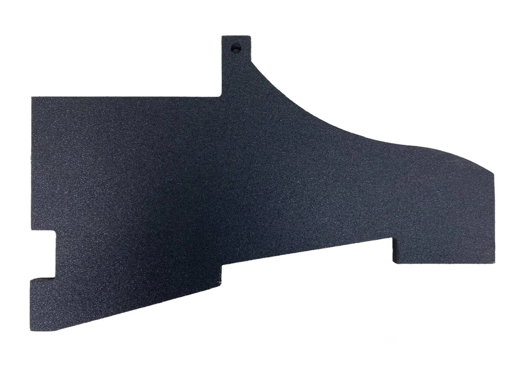

I have a '23 4-door SAS and trying to think of ways and locations(options) to add 2 aftermarket amps.
I purchased the amp rack (see pic) to replace the factory SUB and AMP location ,but it doesn't have the space for a SUB amp and a Speaker amp in the small space it offers. Does anyone have any crafty ideas to get this install started?
I'd like to keep install the amps in the back area/trunk, no under steering wheel since they won't be the kicker small size ones.
Maybe a slightly elevated trunk floor?
Pics would be appreciated.

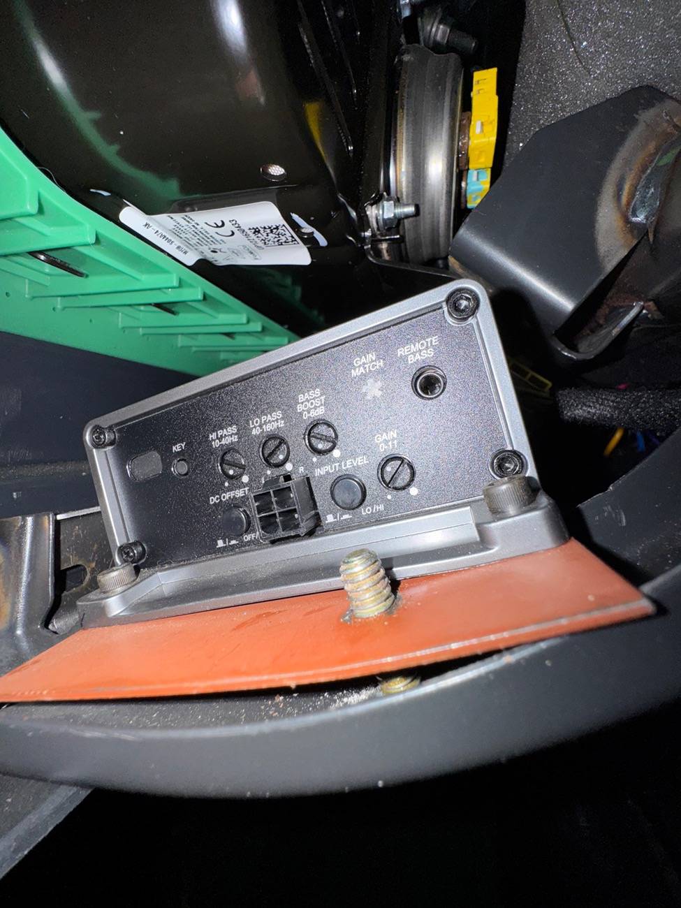

Above glove box kicker key500

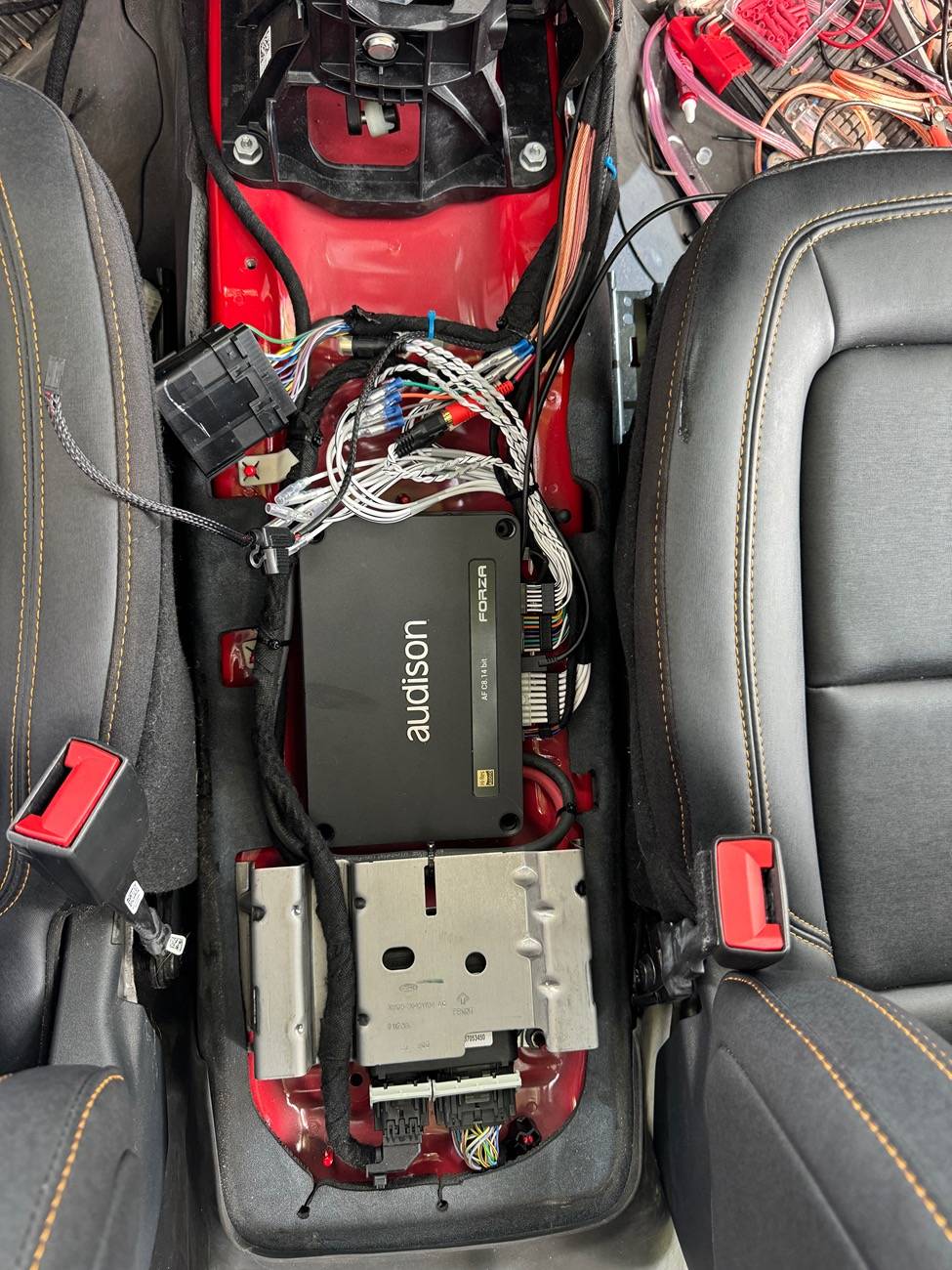

Under armrest/cup holder Audison 8ch

My 200.4 went under the steering wheel and worked great. When I do my 500.1 it’s going in the factory sub/amp location.

Is being hidden a requirement? That makes it a good bit harder. The typical locations: front dash near/in the glovebox (Mountains 2 Metal has a nice bracket that fits some equipment - made for a radio but a lot of amps or processors will fit it). The center console has a good bit of room (@404 build there is nice)

Depending on the size of the amps, the amp rack from MTI Acoustics will allow you to mount an amp on the front and back of the amp rack.
3 amps in my system; 2 mounted on the MTI rack, and 1 under the passenger seat.
that's the same rack I purchased.
  • Do you have any pictures of your amp rack with the amps?
I would guess it's hard to access once installed and panel in place.
  • Which amps did you end up going with and speakers? the options are endless and I'm looking for more quality sound , then quantity of Bass.
