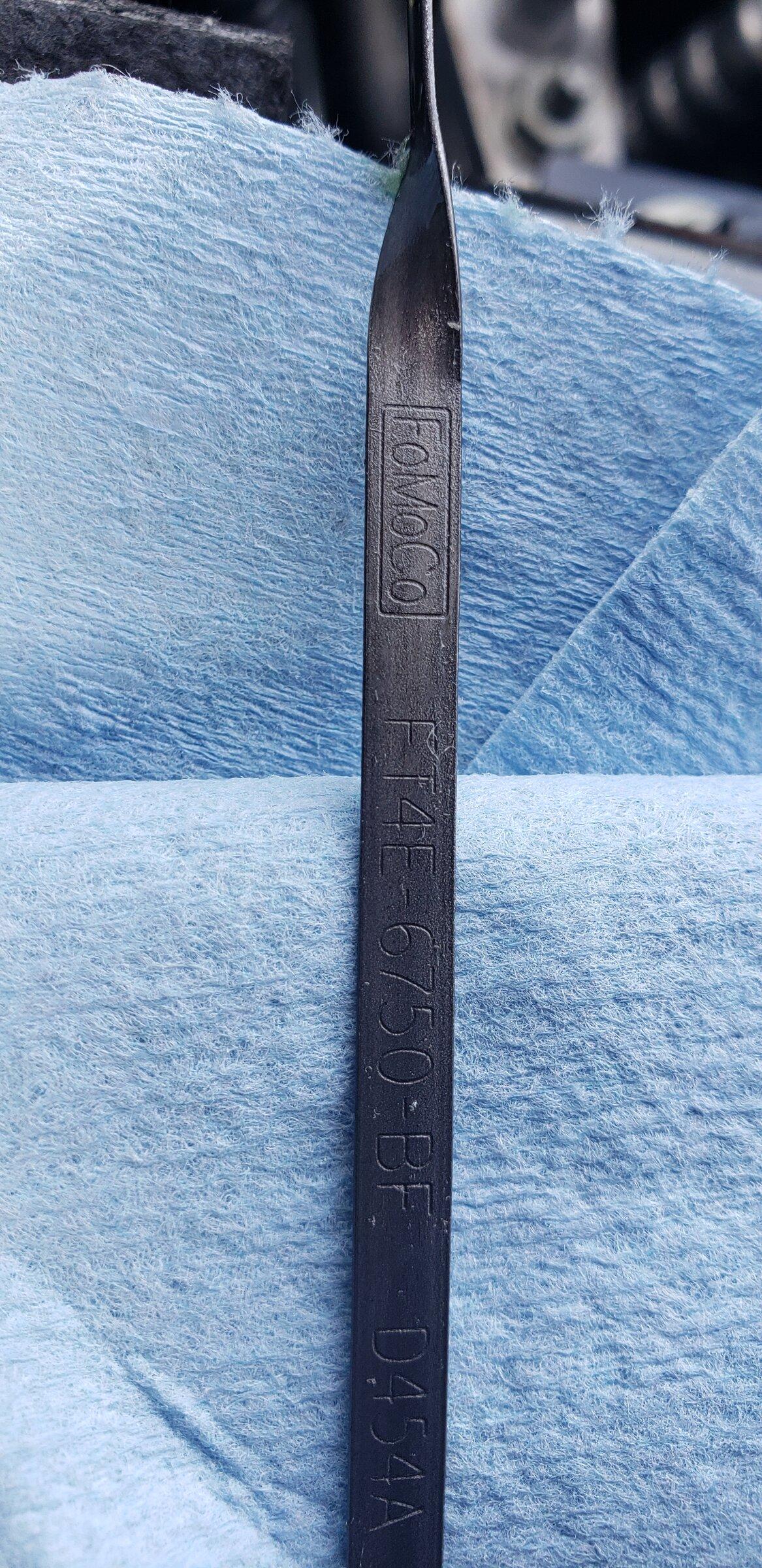

Yep mine is a 22, picture attached. My p/n is ET4E-6750-BF D454A
Awesome thanks
These guys know more they might wanna see it with the oil checked to see the level…

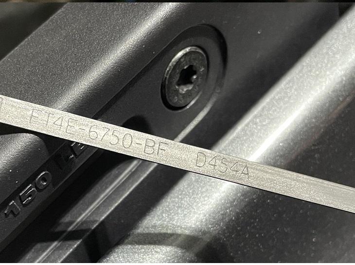

I contacted Ford customer service through the chat feature on Ford.com
The person that helped me said the dip stick part number for my VIN (2021 Badlands with the 2.7L) is MB3Z-6750-B
My dipstick part number is FT4E-6750-BF.
Online customer service couldn't help beyond that and directed me to my dealer.
I called my dealer and talked to two people and transferred to a 3rd. They want me to bring it in and check it out themselves. They said they'd even do an oil change from start to finish for a more thorough examination. I'd do that if they replaced my fresh Amsoil with Amsoil and an Amsoil filter.
The only problem with this, well besides the amsoil, is they would have to let it sit and drain for hours to be able to get most of the oil out. I don't know if they would be willing to do that, or even know that they need to do that.

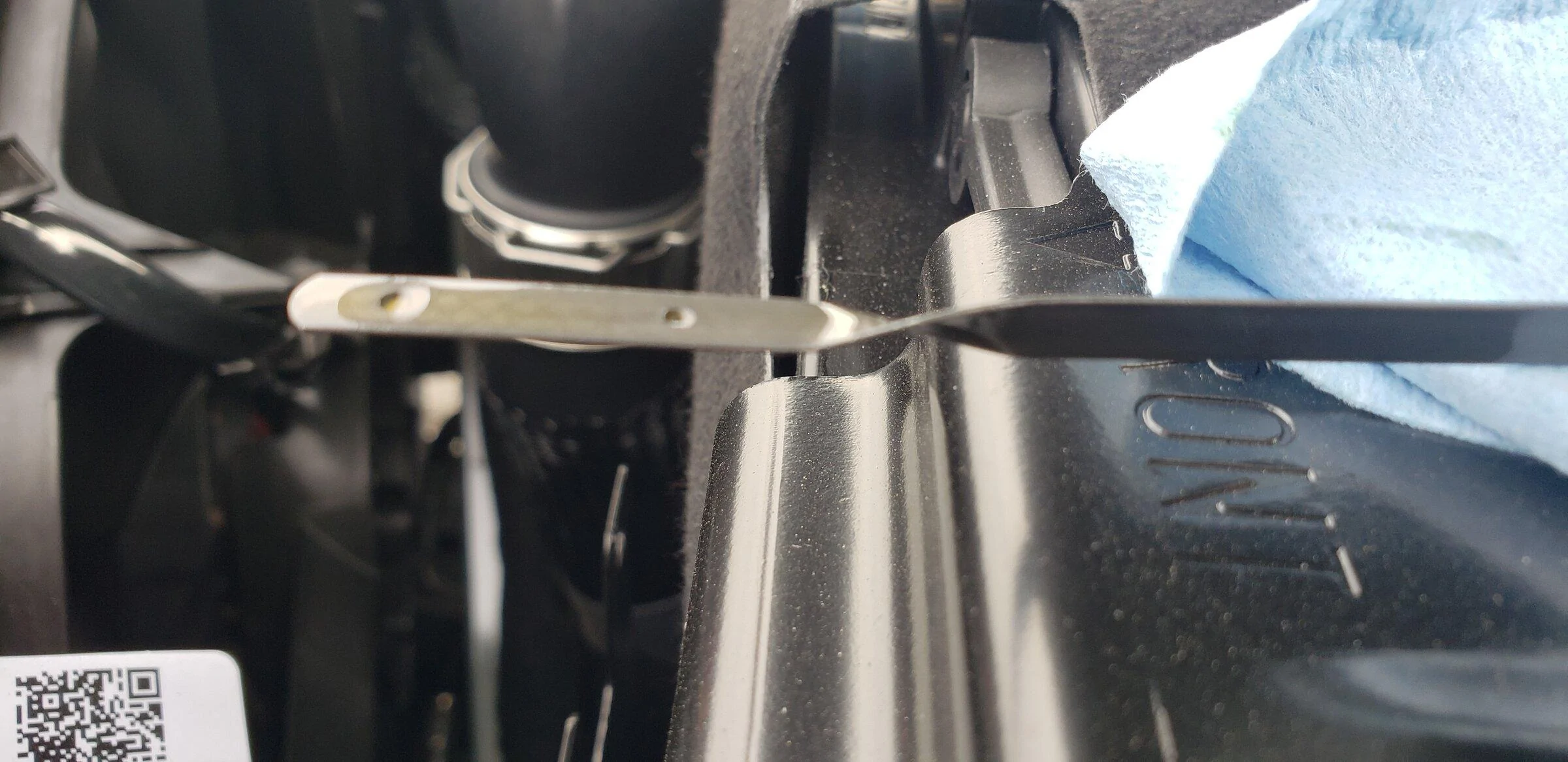

I didn't check this morning, was running late. But this after a complete warm up and a 15 minute cool down. Best I can tell it's right at the 2nd hole.
