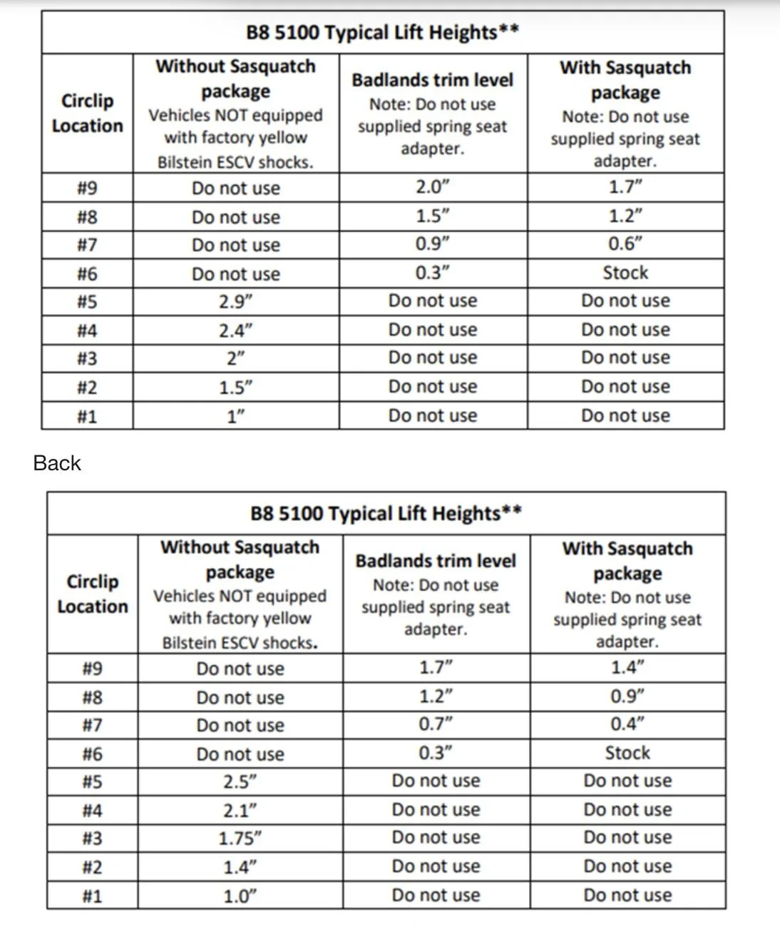

Bilstein 5100 go up to 2.5-3” with the use of your stock springs. $650 or less, depends where you purchase.

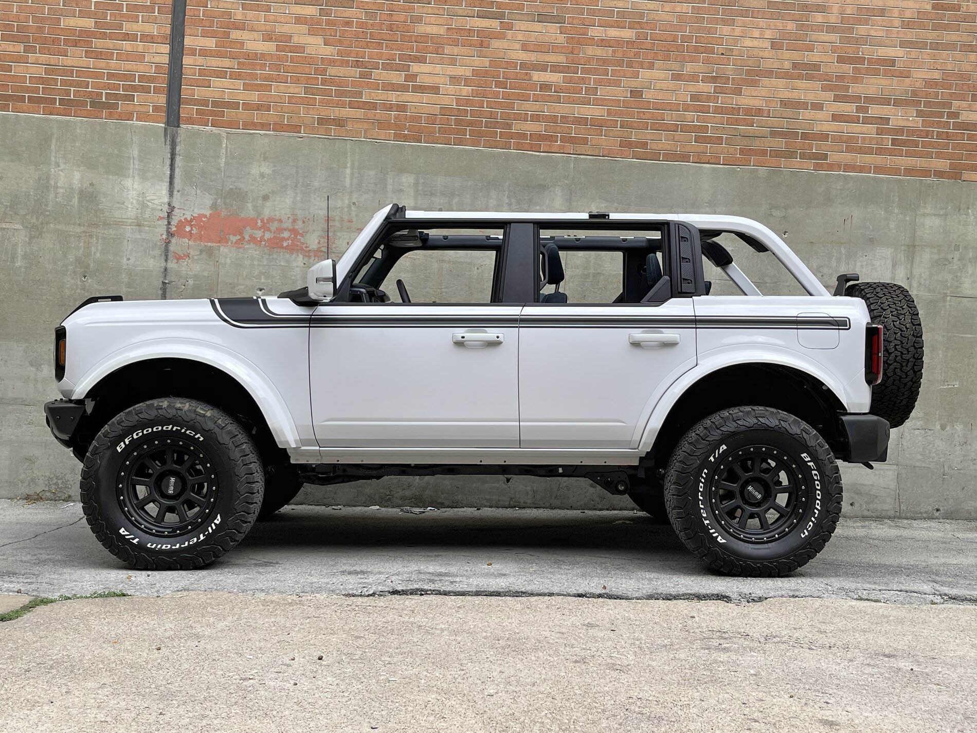

But then take a look at the @Maxlider_Bothers_Customs Bronco with a 4" lift and 35's and it looks perfect. I don't know if its a 2 door vs 4 door thing, but this thing is sexy
Good info here. Personal opinion: I'd stick with 2" or less, fewer unintended consequences.
