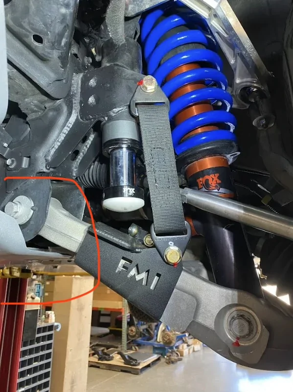

side question, what skid plate is this that is covering this bracket?

that part is the stock front skid plate in the front then our under chassis skid plate kit we make for the Bronco Raptor.

Thanks. I have a badlands not a raptor. One of those brackets on mine took a hit and is slightly bent.

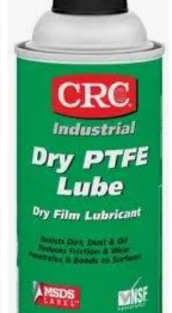

Squeaking can happen with those rod ends. This spray is at most NAPA's and works great for me.
I have taken my Foutz long travel down to Baja and KOH every year and I cant kill them (yet). Its been like 2 years.

Yea good point Jason. Thanks.
I also frequently use TRIFLOW to lubricate the bearings. It has teflon in the lubrication which helps restore the teflon liners in the bearings. You can buy it from autozone and a bunch of places. its easy to get but here are a couple of links below. The only difference in this is that its a wet oil lubricant not a dry one so it can attract dust / dirt but it penetrates well into the bearing.
