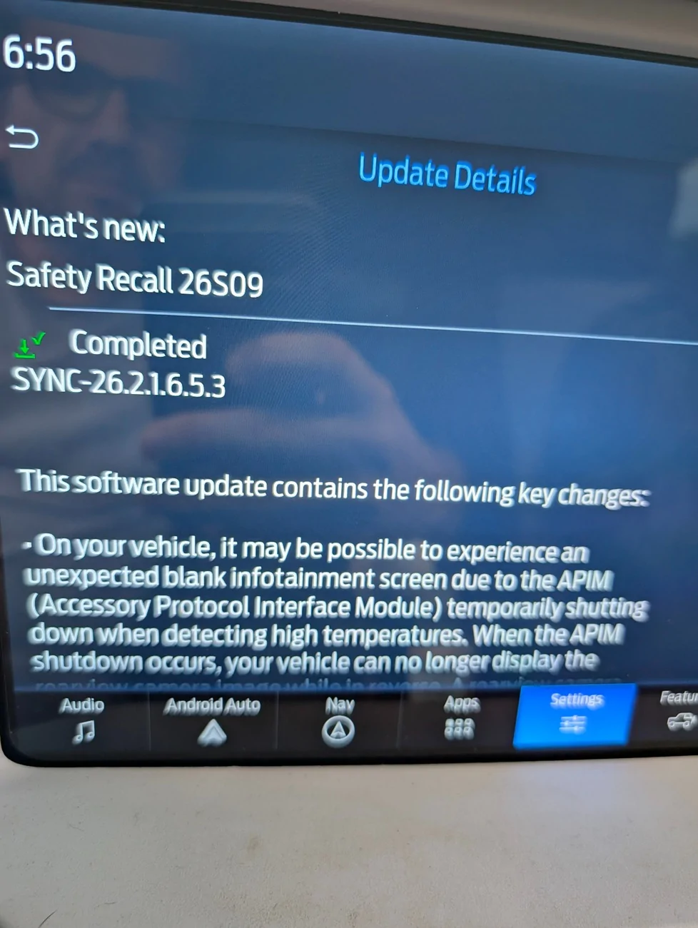

Just saw this... (24 heritage)
Ford Bronco Blank Screen Safety Recall Update (SYNC-26.2.1.6.5.3) PXL_20260526_225614025

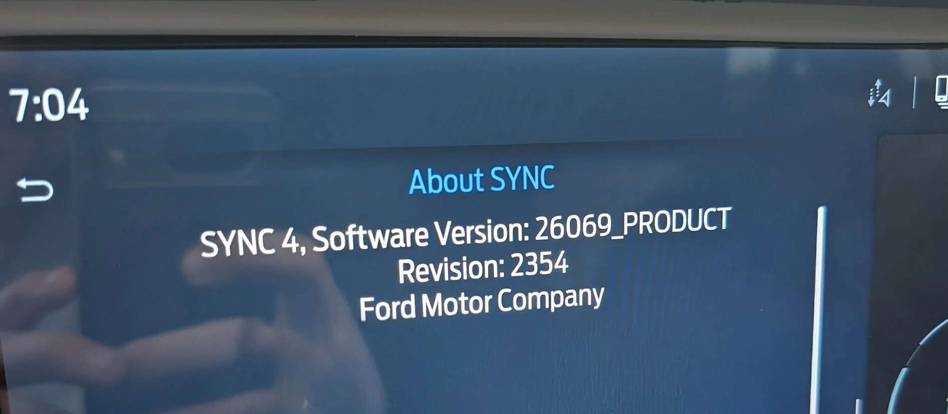

here is my software version
