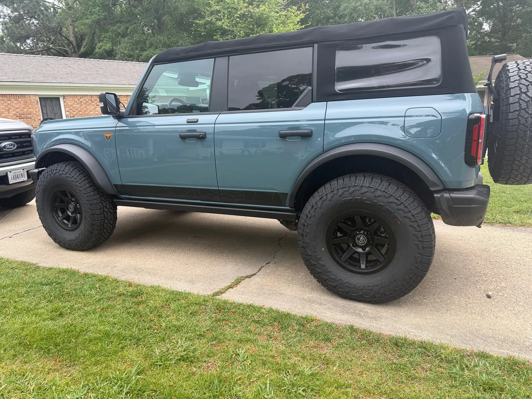

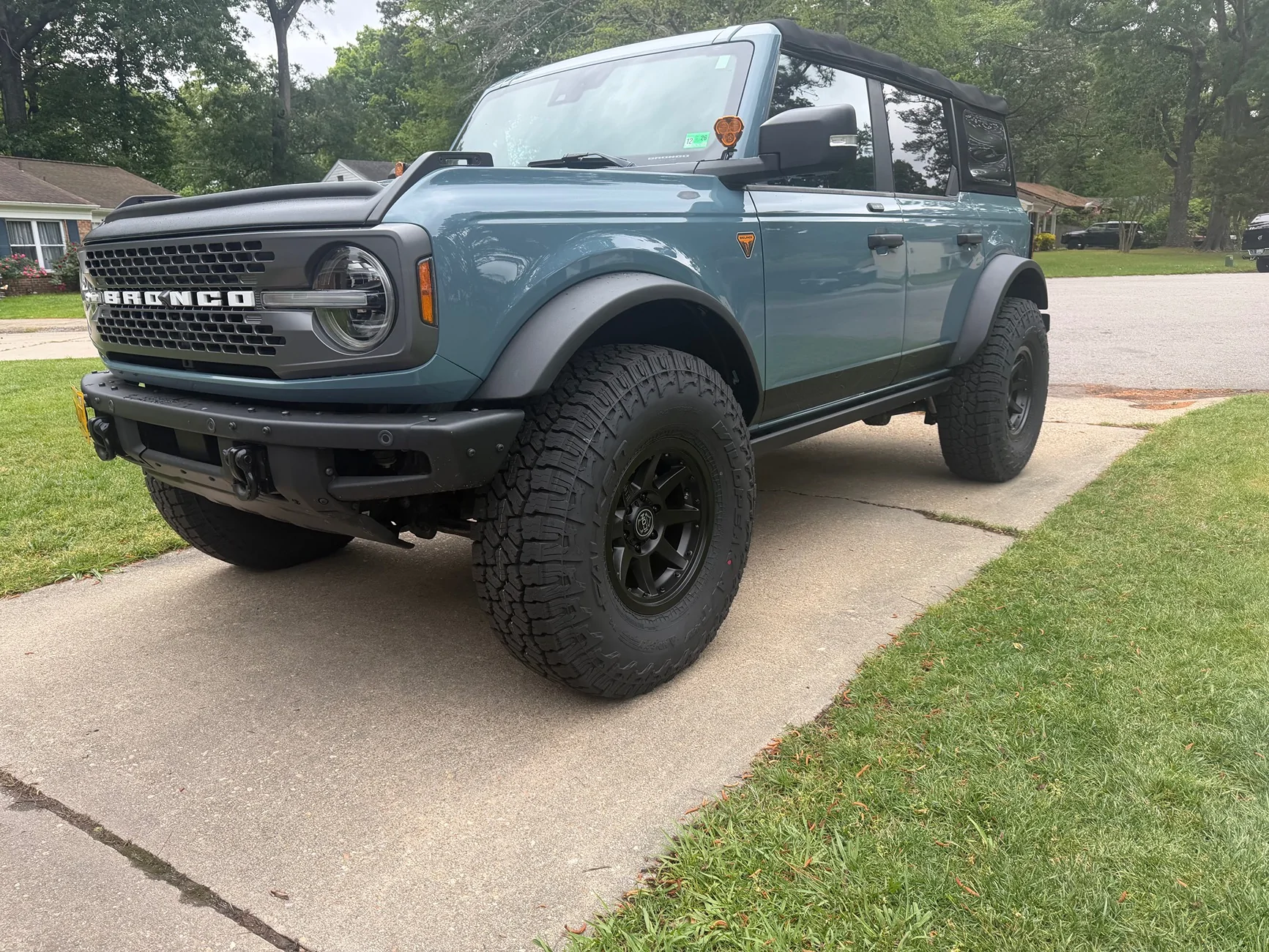

This post is long overdue, been on here a long time with little input and a lot of info taken away, so I’m trying to give back what I can. Always willing to answer any questions on my build, the Idea was to Build it to handle 37s correctly
2021 Badlands Sasquatch, 2.7L, Soft top.
Current Setup
Power
  • Ford Performance ProCal 4 Tune
  • Flowmaster Axle-Back Exhaust
Suspension

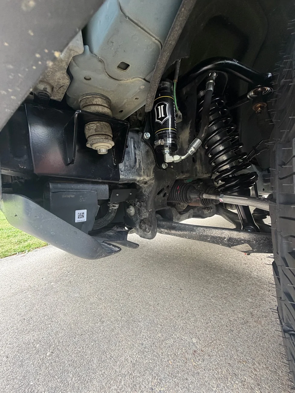

  • ICON Stage 4 (2–3” lift for Sasquatch)
Steering / Strength
  • Ford Performance Severe Duty steering rack
  • JKS max tire clearance kit
Wheels / Tires
  • ICON Rebound Pro 17x8.5
  • Falken Wildpeak A/T4W – 37x12.50R17
Armor / Support

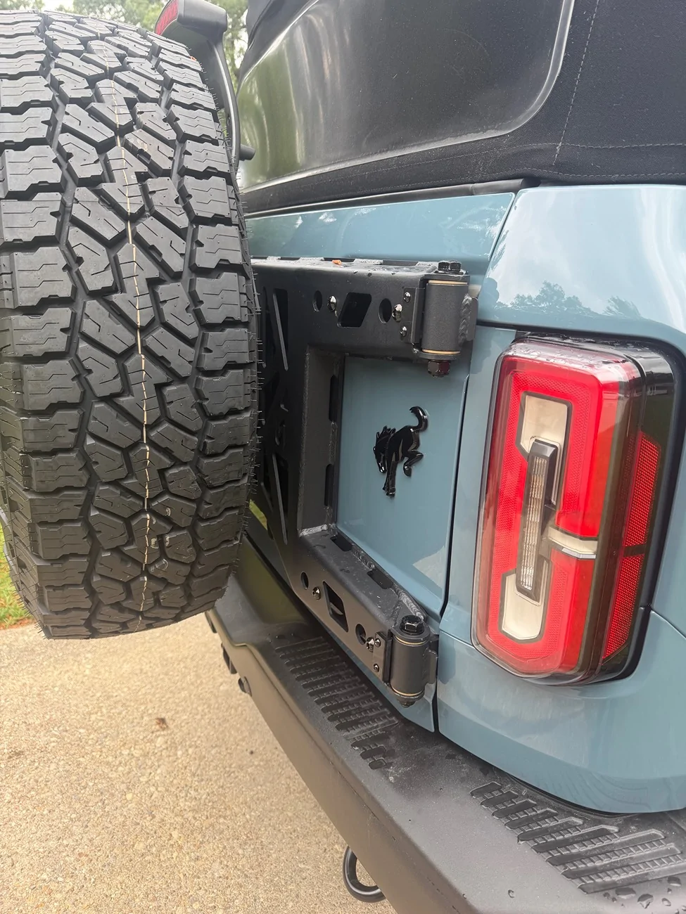

  • TOR Tire Carrier + Tailgate Reinforcement
Air
  • ARB Twin Underhood Compressor
Lighting
  • KC flex era 3 Ditch Lights
Audio
- kicker hideaway / cs speakers with key amp 200 ( kit from trail seven)
impressions
  • Drives better than stock Sasquatch
  • Steering feels solid on 37s
  • Suspension is controlled, not just lifted
This is how the truck should have come from the factory.
Where do I Push It Next?
  • Regear or keep running it as-is?(mainly a daily driver)
  • Adjustable track bar worth it at this point?
  • Anything I’m overlooking

Go ahead and get the needle adapter needed to keep those Upper ball joints greased and keep the grease on the UCA zerks where the bushings are. They will creak if you don't.
As inexpensive as a track bar bracket is, I'd recommend just going ahead and doing it. Adjustable is cool to have (I do not currently) but with the amount you are lifted, the bracket will suffice.

You only need an adjustable track bar if your rear axle is pulled too far over to the drivers side. My guess is that it might be only about 1/8 inch to 1/4 inch... should be fine. One way to address that (and help with handling - rear steer over bumps) is to mount a track bar relocation bracket. I do not see any picks of your track bar. How flat is it? The flatter (horizontal) it is the less rear steer you will get. Rock Jock makes a nice one that adjusts the passenger side of the track bar upwards about 2.5 inches... I think it is about $100.... I found it one of the best investment I have made
