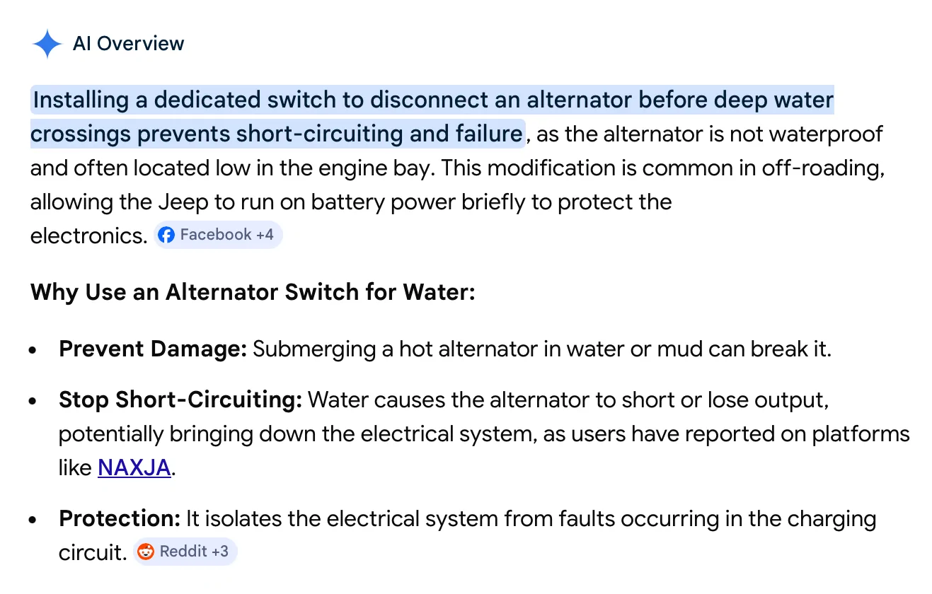

I don‘t have any problems in deep water. Only thing I think I may do (That a lot of jeep owners do) is maKe it where I can switch off the alternator and run on just battery when I go through water crossings. Then after a few minutes switch back on the alternator.
It's still going to pump junk into it as the belt will still be spinning it around :wink:
yes agreed, but I’m strictly talking about water crossing with fairly clean water.

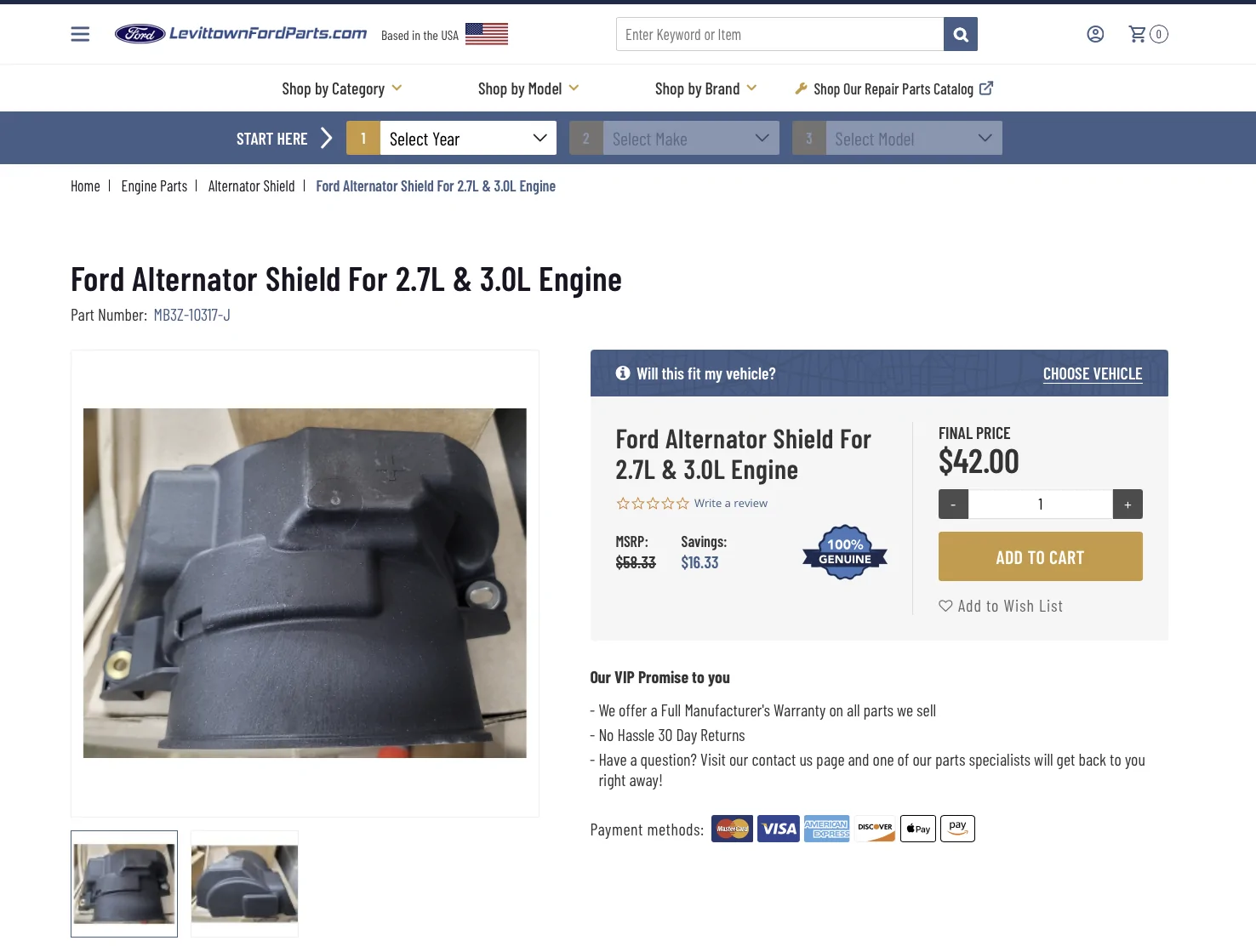

What year are those Bronco's? I had mud do the same to mine (2021) and had the new shield part put in....... The first couple years these were not installed, it was an updated part on newer Bronco's.
There is a difference between mud and very muddy water. This was very muddy water..the alternators are not sealed with the new shields. Muddy water will still easily get in Past the shield. The broncos were 2021, 2022 and 2025.
