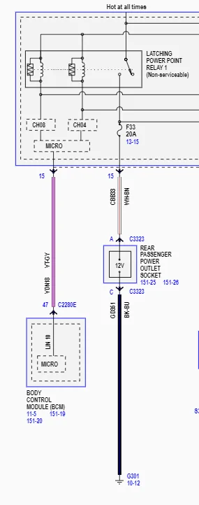

Only hot with key on. Could you wire it to make it on all the time? Yes. You risk running the battery down depending on how much current you are drawing and for how long.
Correct me if I’m wrong, but being an AGM battery would suggest that it would take a LONG time for that to be an issue, no?
Only thing I can say is, a draw is a draw. Is a gel cell/glass mat/deep cycle going to hold up better than a standard duty lead acid? Possibly. What I can say for sure is the several that have gone dead on the lot are nearly impossible to bring back to where they pass a test on Ford's equipment. Either they were defective from the jump or they don't like it after being discharged.
Not an expert but the biggest killer to batteries is short trips that don't allow them to top back off, heat, cold, vibration and a lot of constant deep discharge cycles.

Can someone who has taken delivery put this to bed. I need an always hot 12V in the center console, or I'll have to wire something in. This thread has conflicting info and the Owners manual alludes to both possibilities.

If there isn’t a load on the circuit it makes no difference if power is there. The connection can be live but without something drawing current, it matters none.
I am running a test now. I'll report back in 30 minutes.

Confirmed: Console AND Cargo 12v both turn off after 30 minutes.
Thanks for testing that out. That’s really too bad. The simple solution would have been to follow Jeep’s lead on this, allowing the owner to swap a simple fuse and keep it ”live” even when the vehicles off. Heck, it’s even explained in the owners manual how to do it.
I didn't expect this situation either. In my 2016 Transit - both are hot 24/7.
What are the options here? There has to be some way of modifying this.
Any ideas @flip ?
