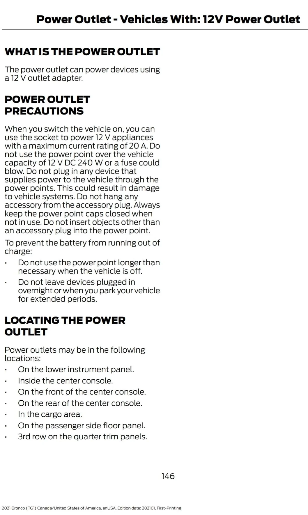

FYI, here is the page from the Owner's Manual related to the power outlets. Also, I didn't see anything about a manual switch or fuse position that changes the power outlet operational state.
