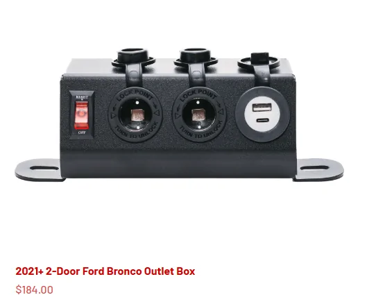

  • The Power Hub: A Redarc BCDC1250D DC-DC charger, mounted on a Genesis Gen 3 Lid, acts as the central logic gate. It ensures the alternator charges the rear bank efficiently while keeping the house loads completely isolated from your starter battery.

Hub / DistributionGenesis Gen 3 Lid/Plate$185.00Genesis Power Hub$799.00

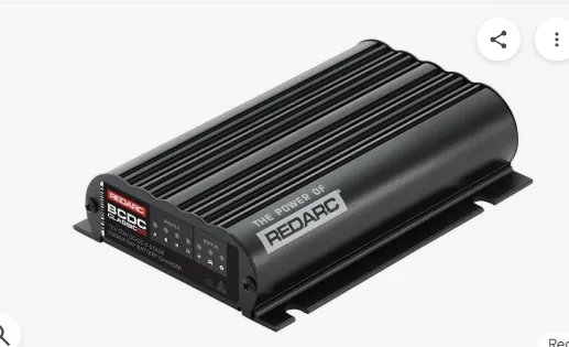

  • Batteries: (2) LiTime 100Ah Xtra Mini – $480.00
  • Charging: Redarc BCDC1250D 50A DC-DC Charger – $690.00

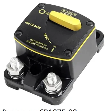

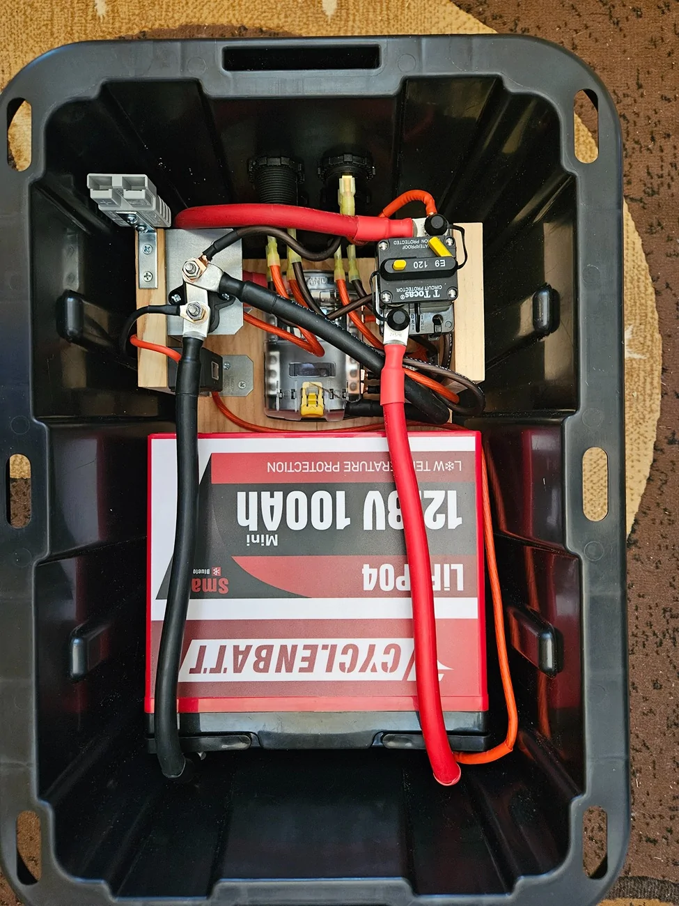

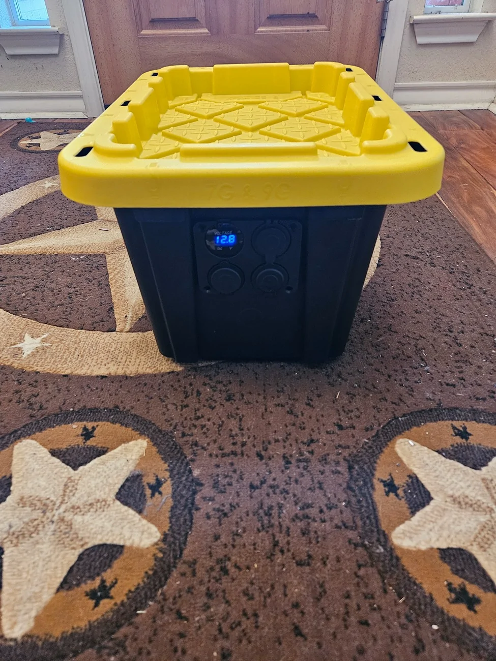

Awesome to see! I did a 100ah one in a home depot crate and currently working on another smaller one in an ammo box. Right now just have it set up as DC but great thing about building these is you can add/change components to fit your need.
Ford Bronco My 2dr Sasquatch project for 200Ah off grid power vs prepackaged. 20250810_161018
Ford Bronco My 2dr Sasquatch project for 200Ah off grid power vs prepackaged. 20250810_160932

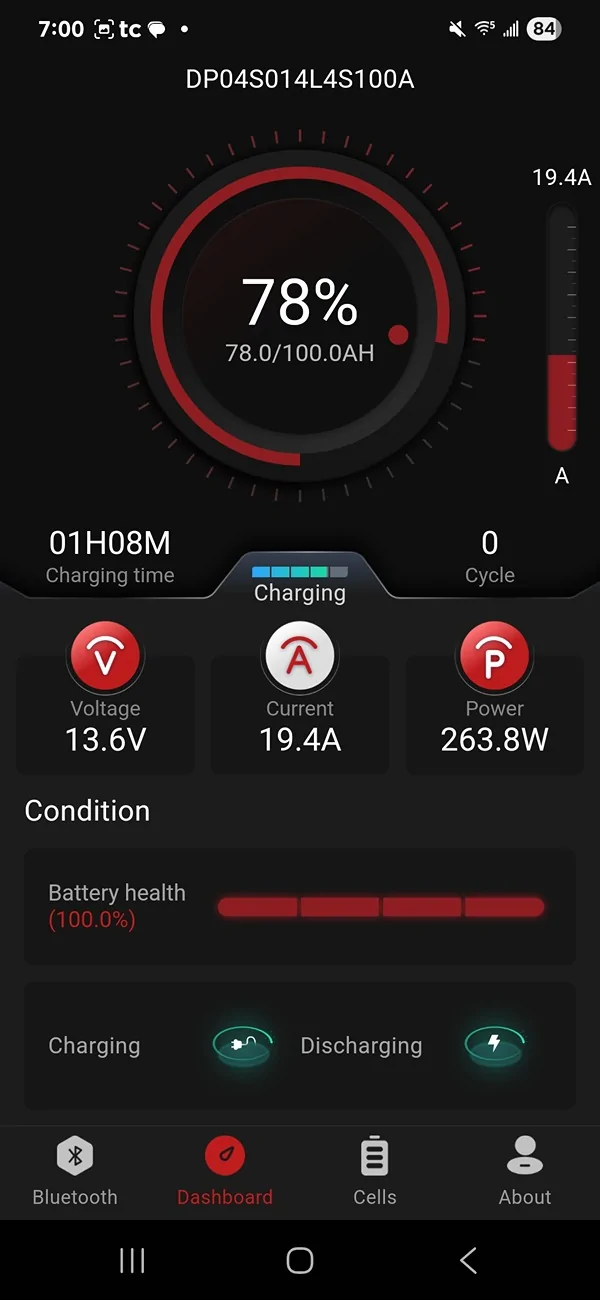

On a side note, if you haven't bought the batteries yet, check out the cyclebatt mini's. Bluetooth feature was a pleasant surprise in being able to monitor and control features within the battery itself.
Ford Bronco My 2dr Sasquatch project for 200Ah off grid power vs prepackaged. Screenshot_20250726_070053

Great to see. I have everything except dc-dc. I just bought form factor where two are on side with rubber mat with cubby tray pulled.
