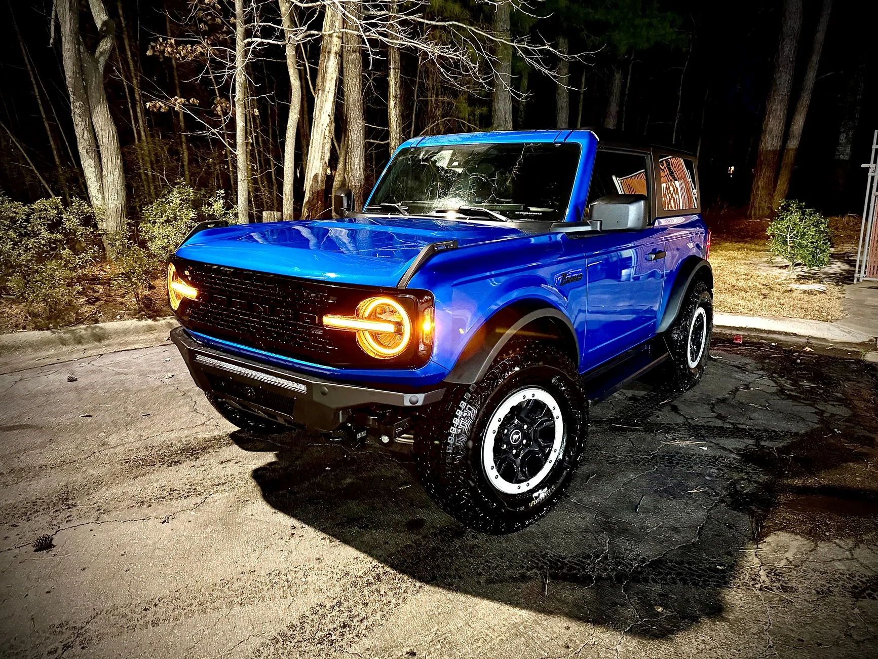

Hey everyone,
Some of you might recognize me from my 2.7L EcoBoost performance thread, where I collaborated with ZFG Racing to build the first 12-second 1/4-mile 6G Bronco. While I originally planned to go even further with larger Garrett turbos on that build, I ended up selling it before reaching the finish line.
I’ve since moved on to a 2021 2-Door Base Bronco (2.3L + 7-speed manual). To be honest, a base model with no lockers wasn't originally on my radar, but I got it for a killer deal so I couldn't pass it up. My goal isn't necessarily to build the fastest 2.3L Bronco in all the land, but I’m going to have some fun pushing its limits and sharing the data with the community here and on my YouTube channel.
Ford Bronco Little Engine, Big Power: My 2.3L Bronco Performance Modification Build BroncoFront
Vehicle Specs
  • Year/Model: 2021 Ford Bronco Base w/66K miles
  • Color: Velocity Blue
  • Engine: 2.3L EcoBoost
  • Transmission: 7-Speed Manual (Getrag MT-88)
  • Gearing: 4.46 Gears

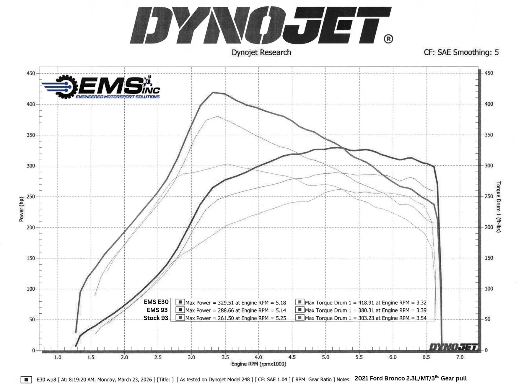

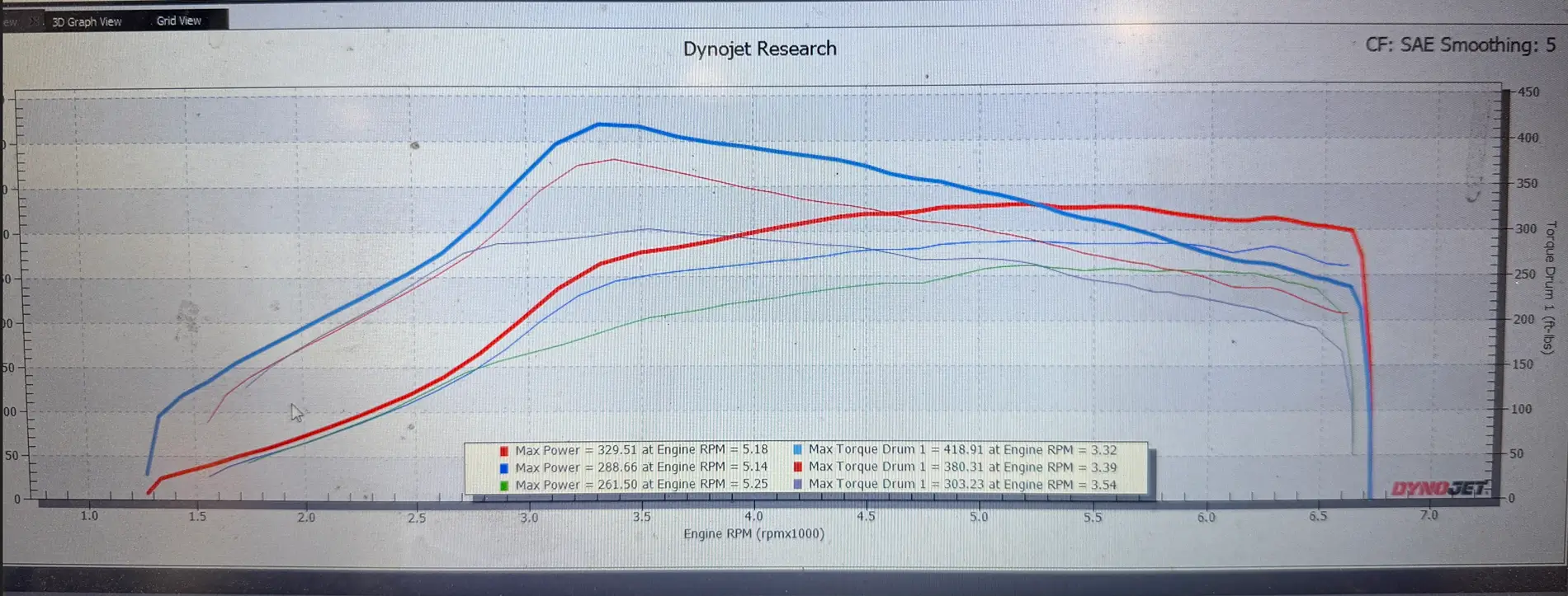

For those unfamiliar with Ryan Martin and EMS, he's widely regarded as a one of the best tuners for 2.0L and 2.3L EcoBoost platforms. His track record speaks for itself. He has tuned more 2.3L Mustangs than perhaps anyone else in the industry. EMS currently holds the title for the fastest and quickest EcoBoost Mustang in the world. Ryan offers a wide spectrum of tuning options, ranging from conservative street maps for drivability to dedicated off-road setups and high-output race tunes.
Ryan and I spent significant time troubleshooting the HP Tuners MPVI4 as we ran into some problems, but everything is all good now. I’m planning to put together a detailed write-up or video guide to showcase the process, but now that it's working it's really super simple.
We have officially started the custom tuning process and currently dialing in the 93 Octane map, with an E30 tune scheduled immediately after. Once the tunes are perfected, I’ll be heading to the dyno to pull official numbers for the stock, 93, and E30 setups. From there, I’ll begin a phased rollout of performance mods, returning to the dyno periodically to track the gains.

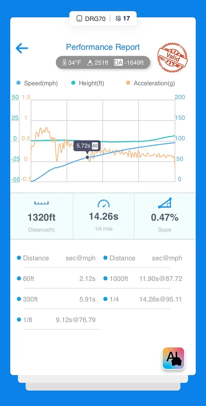

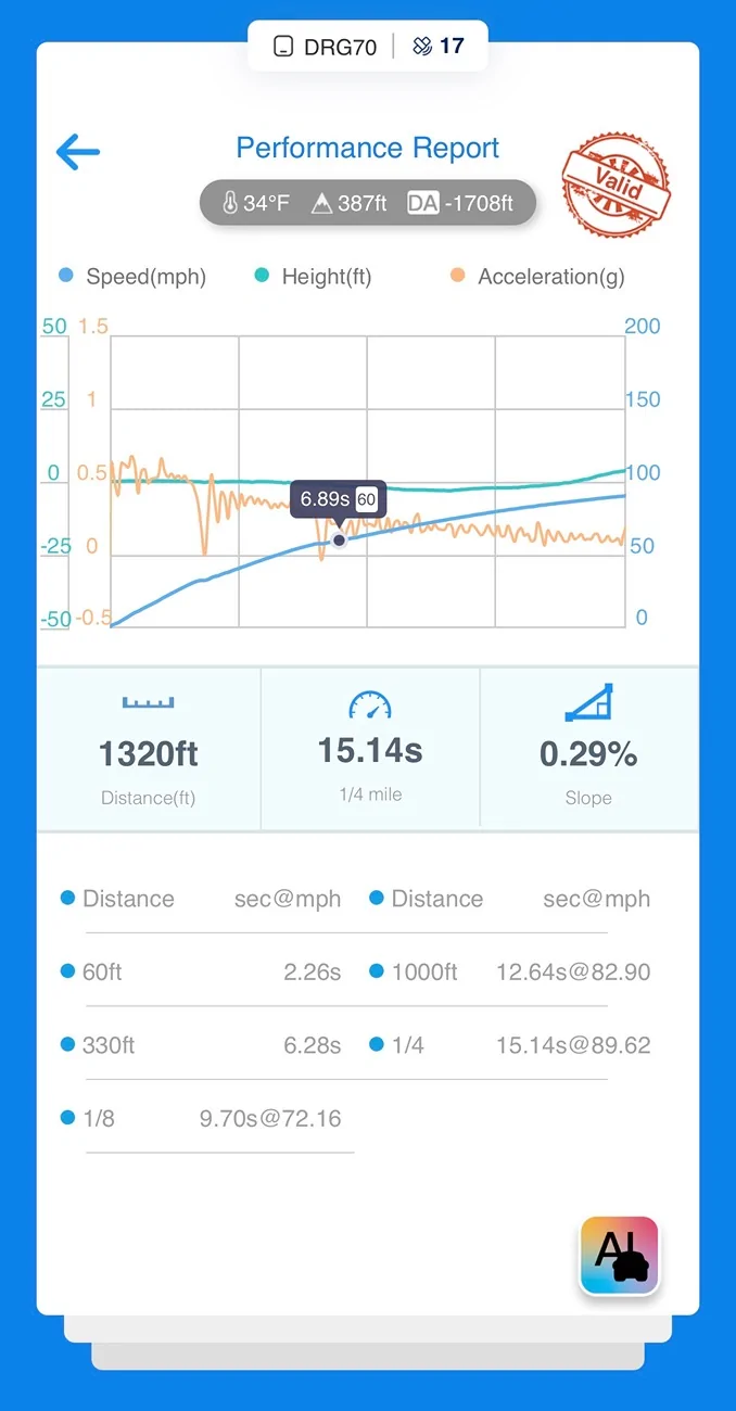

Dragy: 0-60 & 1/4 mile
Baseline (Stock)
93 Octane
Ford Bronco Little Engine, Big Power: My 2.3L Bronco Performance Modification Build IMG_1677
93 Octane Custom Tune
W/MBRP Exhaust, NGK plugs, and CVFAB Intercooler
Ford Bronco Little Engine, Big Power: My 2.3L Bronco Performance Modification Build IMG_E1852
Ford Bronco Little Engine, Big Power: My 2.3L Bronco Performance Modification Build ColorDyno
Ford Bronco Little Engine, Big Power: My 2.3L Bronco Performance Modification Build EMSBroncoDYNO

The baseline video is completely stock with 93 Octane. Even before the colder plugs and exhaust.
I'll do Dragy runs when 93 and E30 tune are finished.

Awesome! Ford Performance tunes are rather conservative for all of the Bronco engine options, so I expect a custom tune to be quite a bit better. I'm only on the 1st revision and it already pulls quite a bit harder, but we'll see how she feels when the 93 tune is wrapped up.
