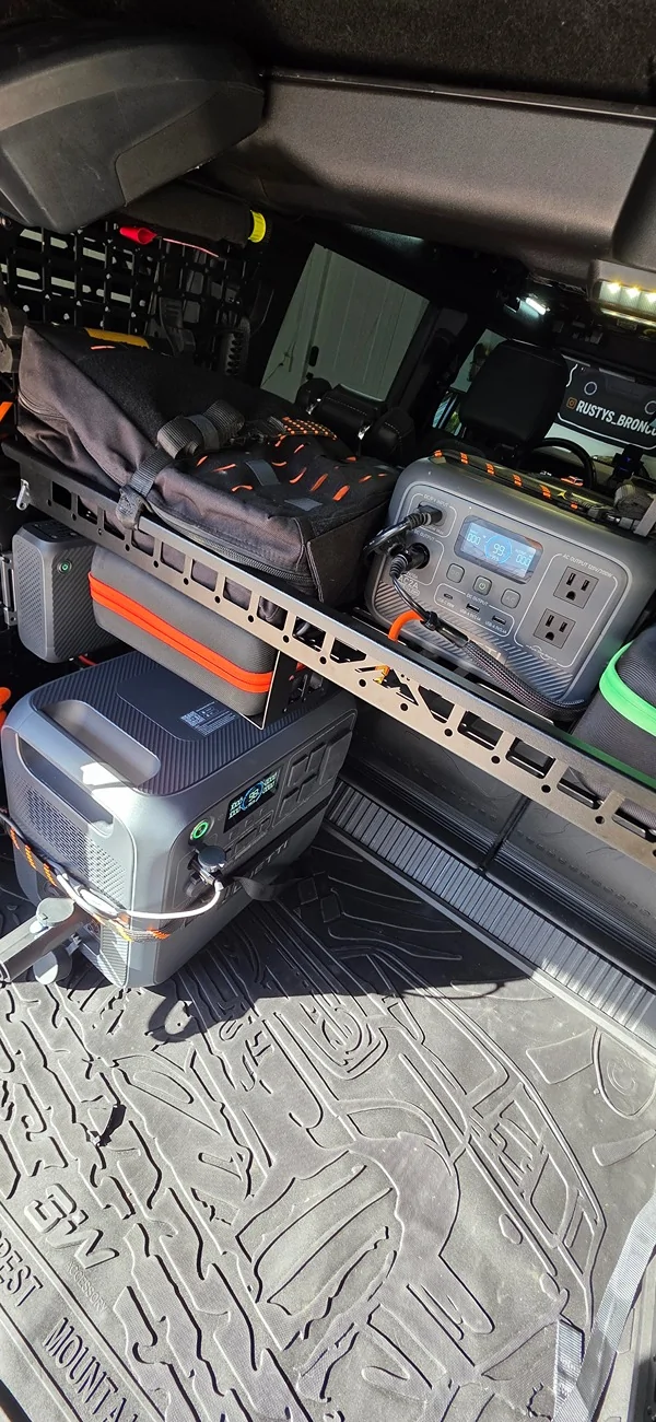

Bluetti Charger 2 enters the chat. I installed it as a permanent part of the Bronco. Install was easy. I routed the main charge cable down the driver side firewall, passed through the factory firewall gromet, and ran everything cleanly to the cargo area. The unit is mounted directly to my cargo molle panel so it is secure, out of the way, and part of the build instead of loose gear. Now anytime the Bronco is running, it is actively charging my power stations instead of just draining things and hoping Thor, the Thunder God, holds me in his favor.
For power storage I run two units that cover different roles. The Bluetti AC2A is my smaller, portable unit and it lives on my cargo shelf. That is my grab and go power for a heated blanket, charging camera batteries, running my diesel heater, and the random small stuff that always pops up at camp. It is light, easy to reach, and simple to deploy outside the truck.
The Bluetti AC200L is my larger battery and it stays in the Bronco full time as the base power source. It runs my Starlink, keeps my 48qt @WolfBox fridge cold, and handles the heavier loads when we are parked. The game changer is that this system can support the truck’s battery with its reverse charging capabilities, so I can easily carge the OEM battery while running my auxiliary switched lighting, including my roof rack lights, without constantly worrying that I am setting myself up for another Ocala morning. It also supports adding solar as a power input, so you can still charge your gear - even when the truck is parked.

Just to add to this, I would agree the bi-directional is the way to go, but I also keep a Gooloo GT3000 jumper, it doesn't take up that much space and its useful if needed on other vehicles.
Wise move. The little grey/orange box suspended below the shelf is my little @WolfBox battery jumper. Added redundancies, but also helpful when I find someone else dead on the side of the road.

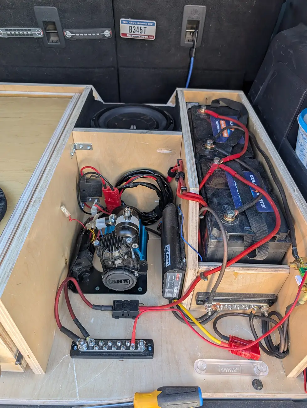

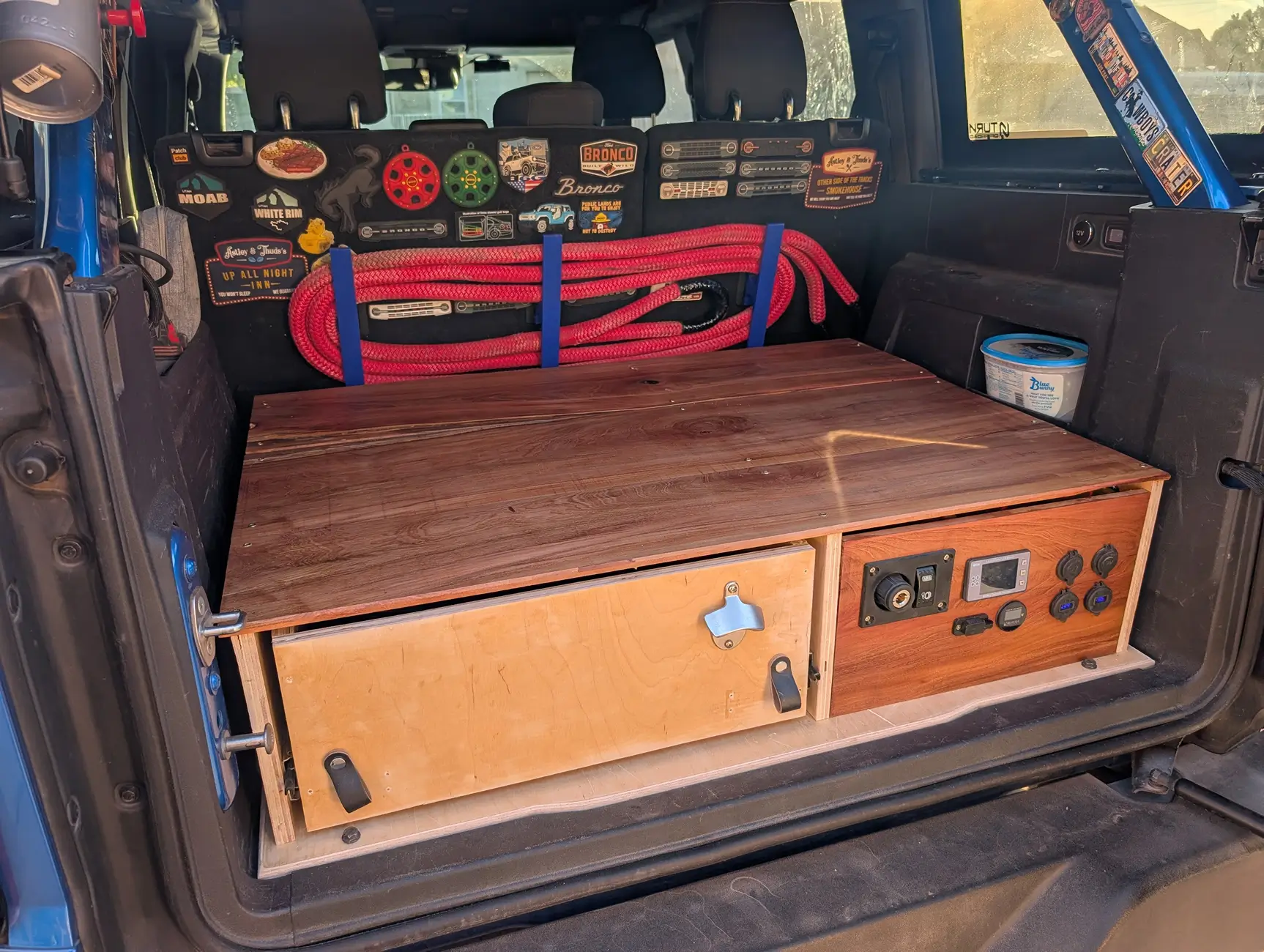

I've posted this in other threads, but this is mine. Built into the rear of the truck for storage, and serving a few other purposes. It's got 100Ah of juice for all manner of camping gadgetry, and instead of having some reverse charging voodoo, I can just keep a jump pack in the drawer that can be charged from the aux batteries.
Finished product:
