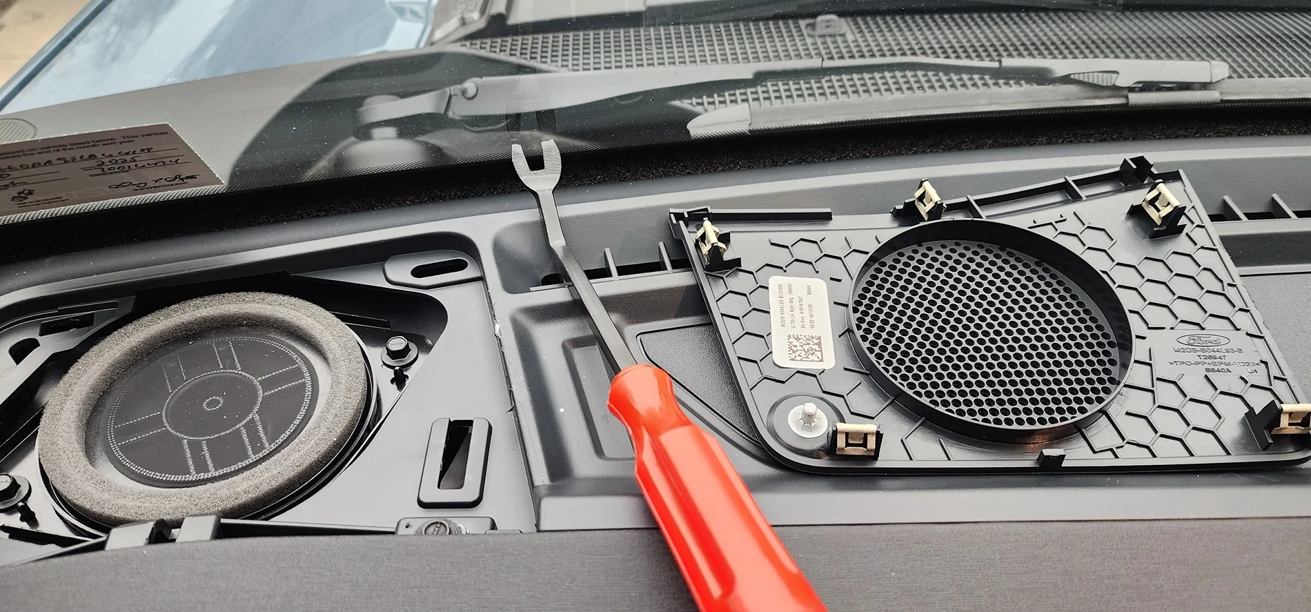

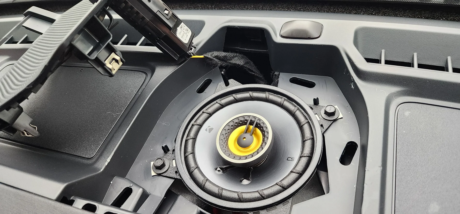

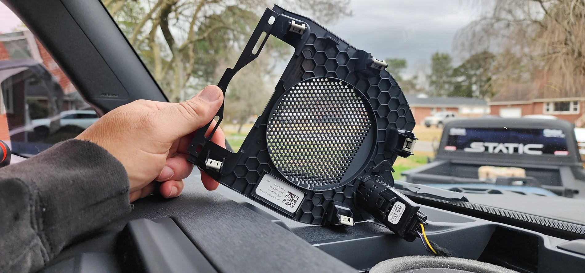

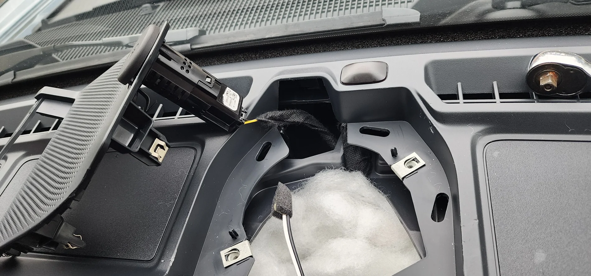

So I started with outer dash speakers. Pulled grills and this was simple. Remove factory speaker, stuff hole with Poly Fill, and install Kicker 4" in place with metra harnesses. Literally plug and play here.....
Ford Bronco B&O Stereo System Upgrade on 2025 Bronco Raptor 1000028289

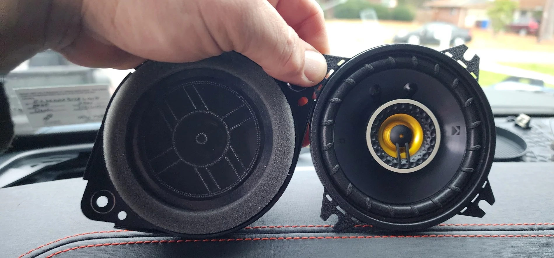

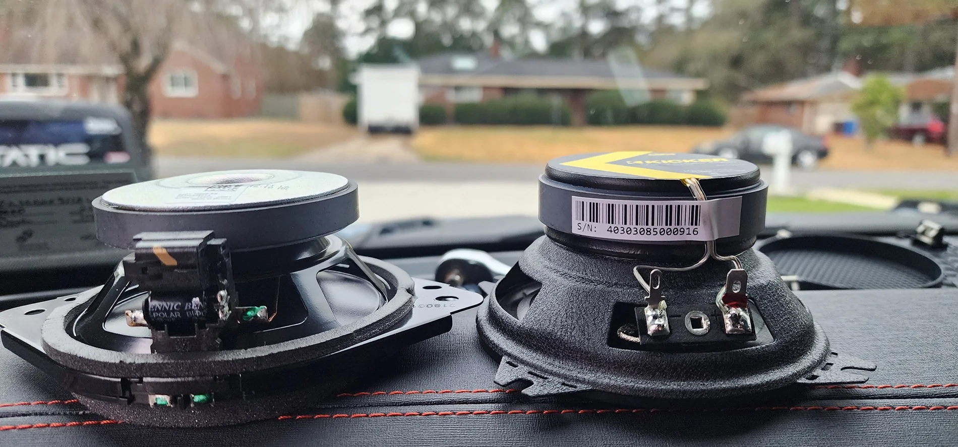

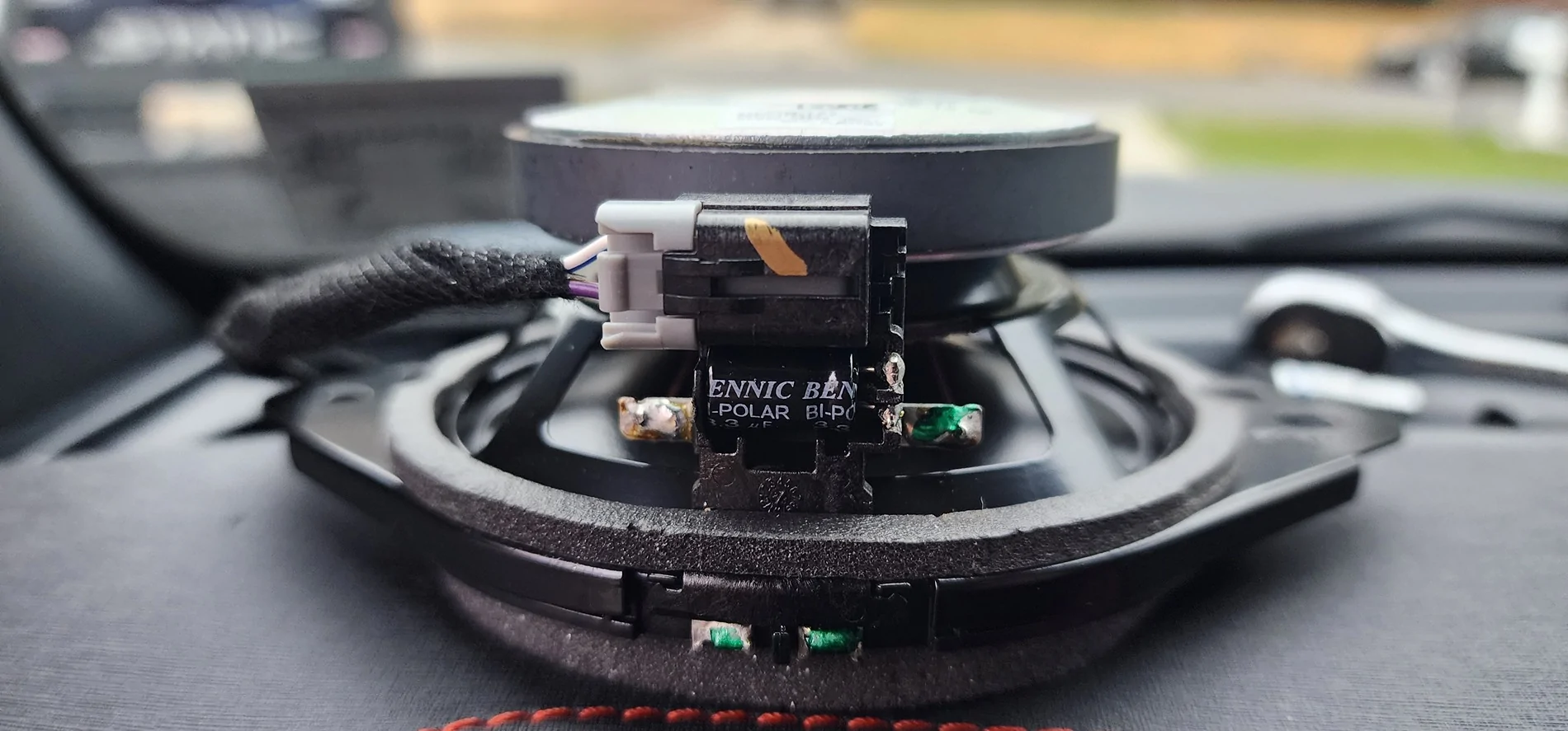

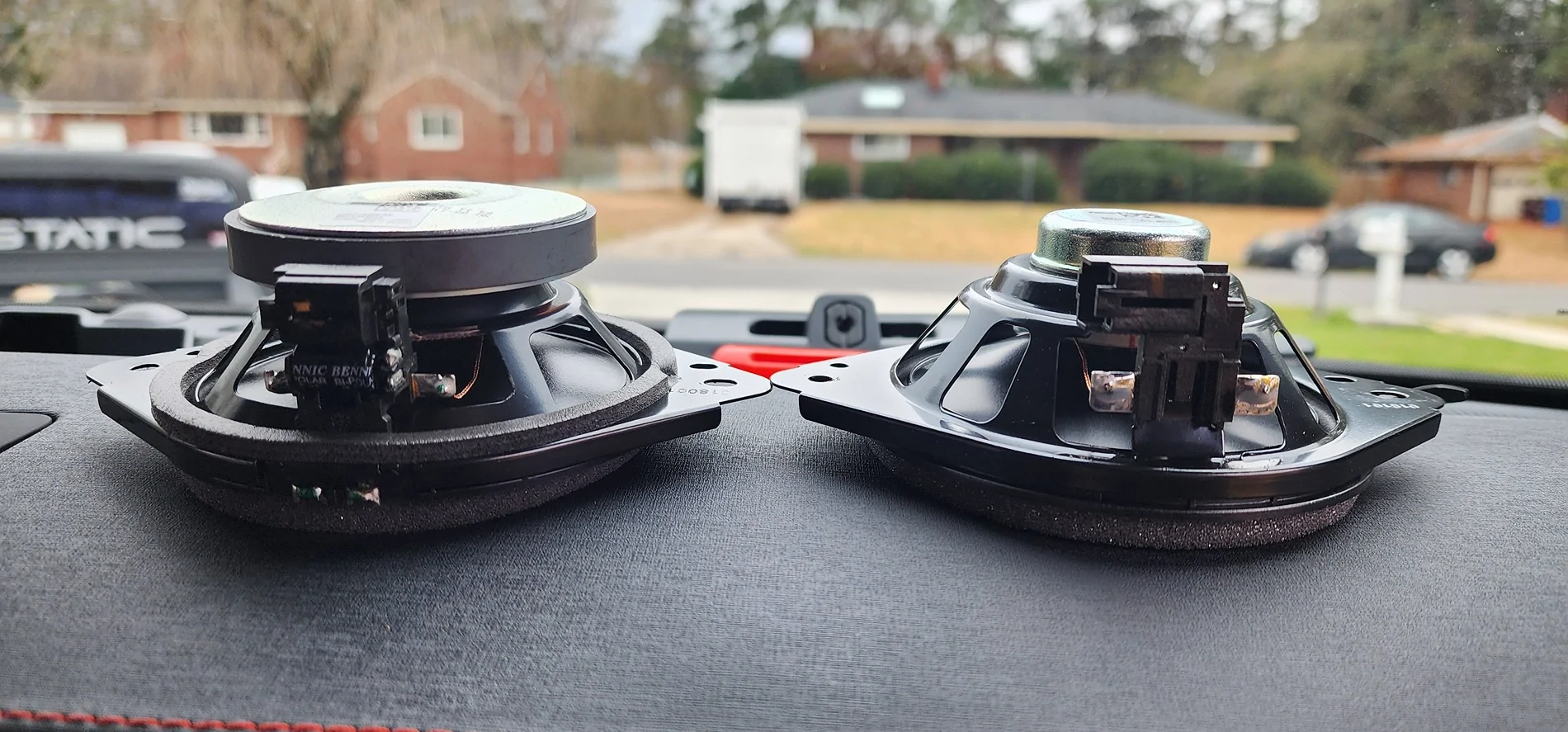

I did find in this 2025 b&o that the stock speakers have bass blockers installed from factory. Thought that was interesting....
Ford Bronco B&O Stereo System Upgrade on 2025 Bronco Raptor 1000028290
The side by side isn't dramatic, but still apparent the kicker is better...

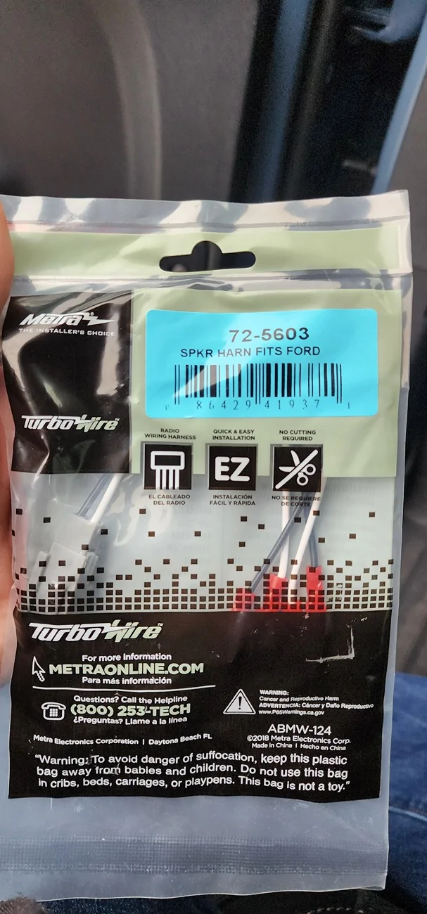

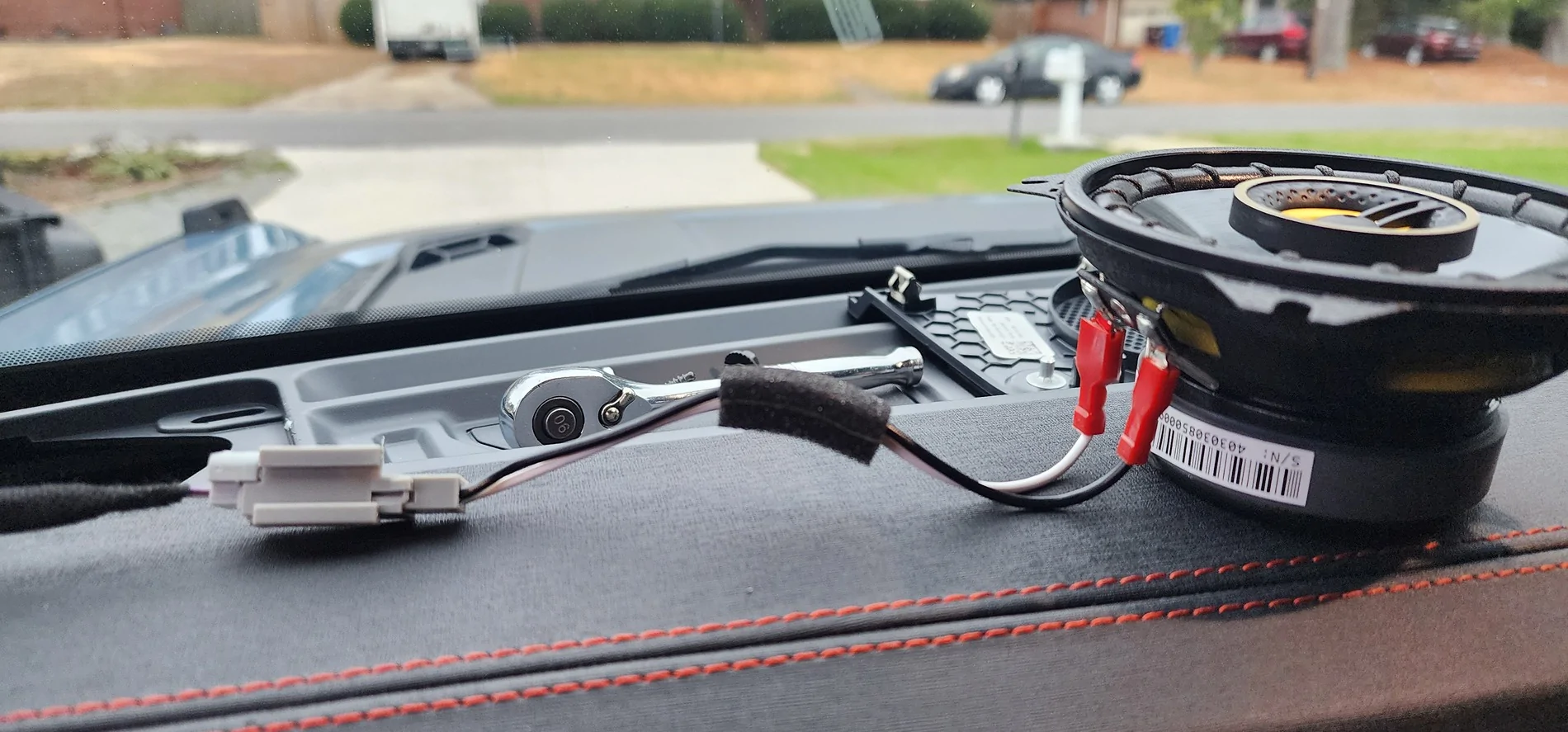

Picture of the metra harness. I used Sonic Electronics for all the coaxial speakers, and they included harnesses for free.
Ford Bronco B&O Stereo System Upgrade on 2025 Bronco Raptor 1000028293
Ford Bronco B&O Stereo System Upgrade on 2025 Bronco Raptor 1000028294

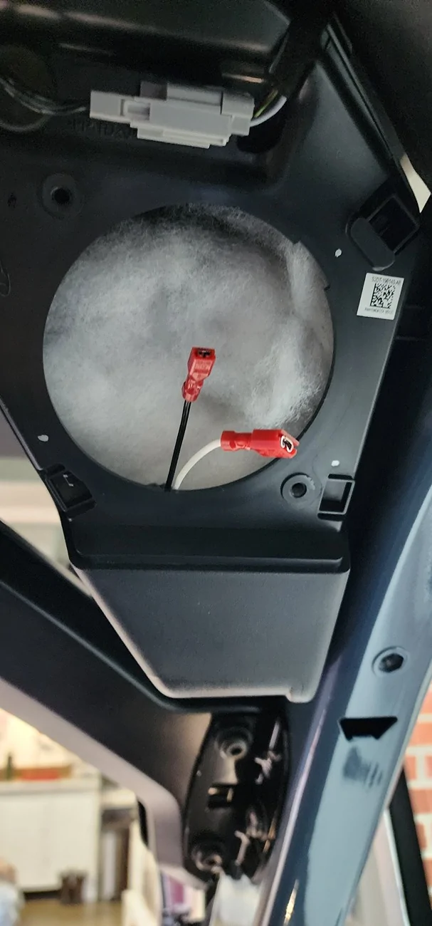

Now as I said i did stuff holes with poly fill to hopefully kill some dead space behind the stock speakers...

Here we are with Kicker installed...

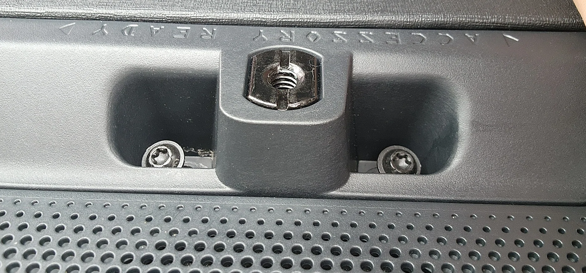

Next we go to center channel. This wasn't hard at all, but the 2 T20 torx screws can be tricky. Just a weird angle to get to, but with screwdriver with t20 it was no problem
Ford Bronco B&O Stereo System Upgrade on 2025 Bronco Raptor 1000028297
Heres a shot of clip location on center grill

Stuff the hole again

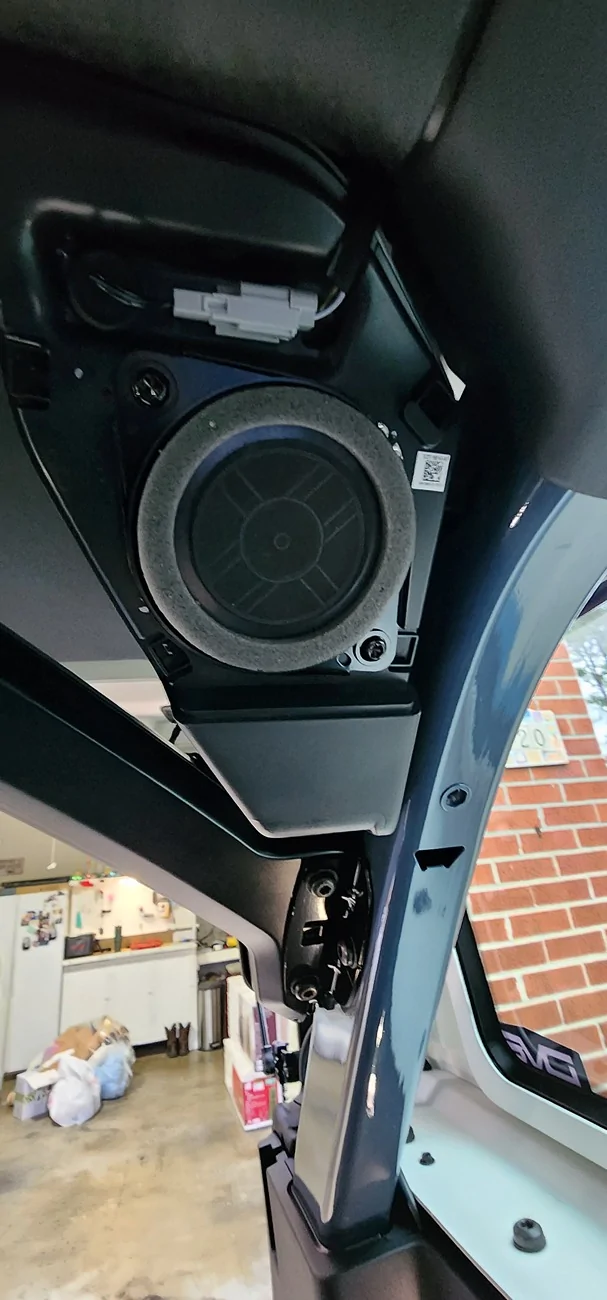

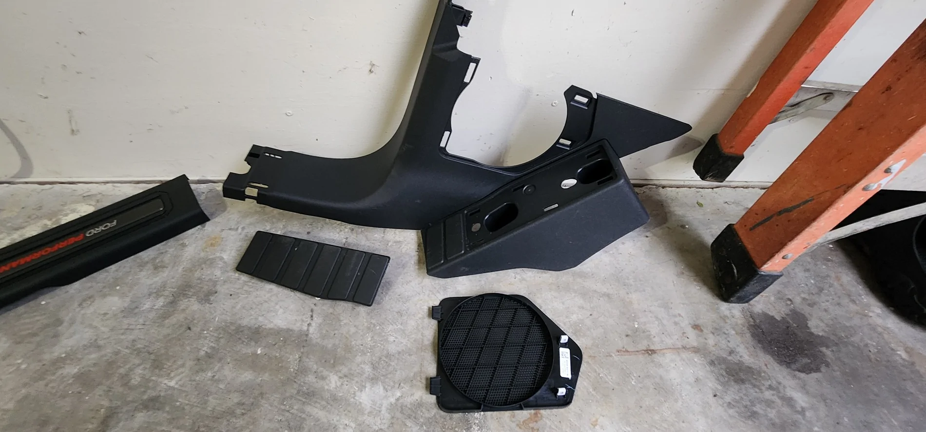

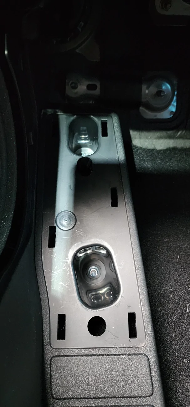

Now onto the kick panels. Removed trim inside door sill.
Ford Bronco B&O Stereo System Upgrade on 2025 Bronco Raptor 1000028306

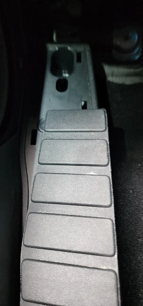

Remove top of dead pedal to access 2 10mm nuts
Ford Bronco B&O Stereo System Upgrade on 2025 Bronco Raptor 1000028307
Ford Bronco B&O Stereo System Upgrade on 2025 Bronco Raptor 1000028308
Once those nuts are removed the panel comes right off no problem

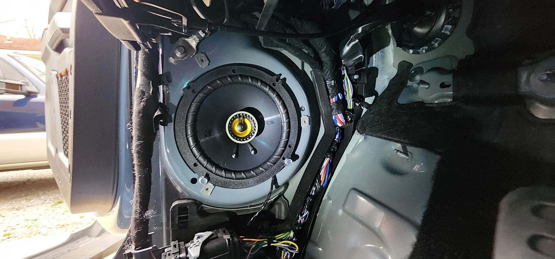

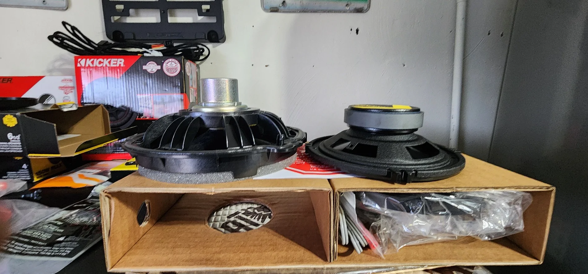

Side by side again of stock vs kicker.
Ford Bronco B&O Stereo System Upgrade on 2025 Bronco Raptor 1000028312

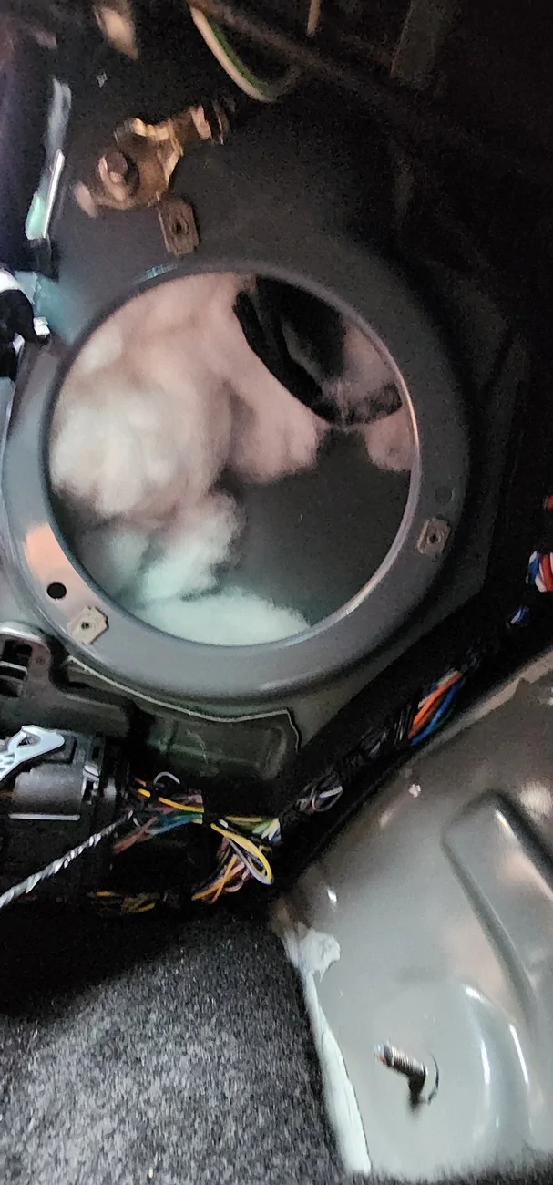

Again stuffed the hole with poly fill, and installed the Kicker
Ford Bronco B&O Stereo System Upgrade on 2025 Bronco Raptor 1000028314
Ford Bronco B&O Stereo System Upgrade on 2025 Bronco Raptor 1000028315
Now these 6.5" Kickers i ended up pulling back out, and putting stocks back in. Let me explain.....#1 they don't fit, and sonic electronics did not send an adapter. To me it appears to need a 6.75" speaker. I did however redneck install them using 2 screws. When I tested them they sounded bad imo. The stock B&O system sends quite a bit of power to these, and the kickers had alot of "popping" type of bass (polarity was correct). They just sounded bad. So stocks back in. Future...I may be installing a dedicated mid woofer here.

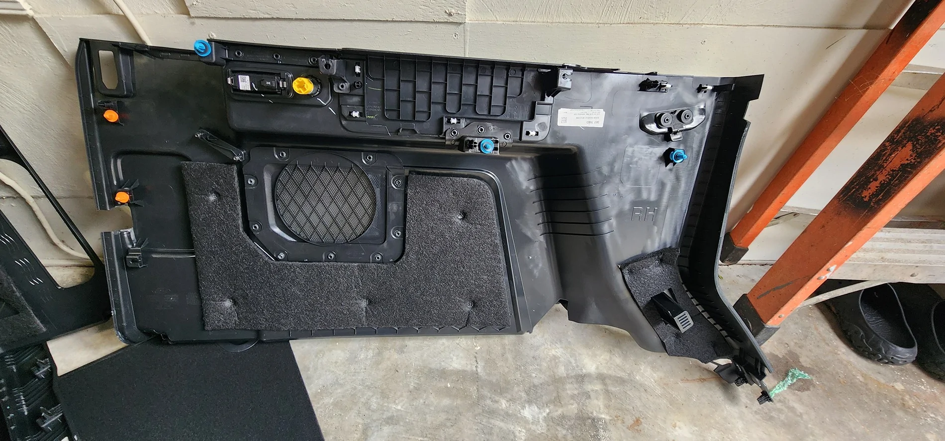

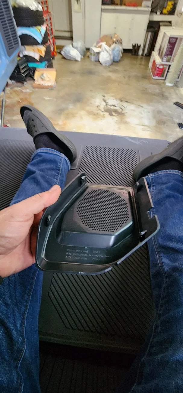

Anyway on to the rear pods. This was super simple. Just squeezing the grill cover on stock pod remove it. Unscrew stock speaker, and remove. Stuff hole with poly fill as usual, and install Kicker speakers. Done. Now these are very noticeable difference. Especially using Surround mode.
Ford Bronco B&O Stereo System Upgrade on 2025 Bronco Raptor 1000028317
Ford Bronco B&O Stereo System Upgrade on 2025 Bronco Raptor 1000028318
Ford Bronco B&O Stereo System Upgrade on 2025 Bronco Raptor 1000028319
Now I did have to cut off 2 mounting locations off Kicker speaker here. Super simple with tin snips though. Sounds amazing in here now. Crystal clear with more volume, and we actually have rear sound now. Well worth the 2 hours tops of swapping 5 speakers (imo don't even bother with kick panels unless you go dedicated mid woofer). Volume is louder, and clarity is amazing. Highs are way more pronounced, and we now have quite a bit of fill mid bass from dash and pods. 👏 👏 👏.

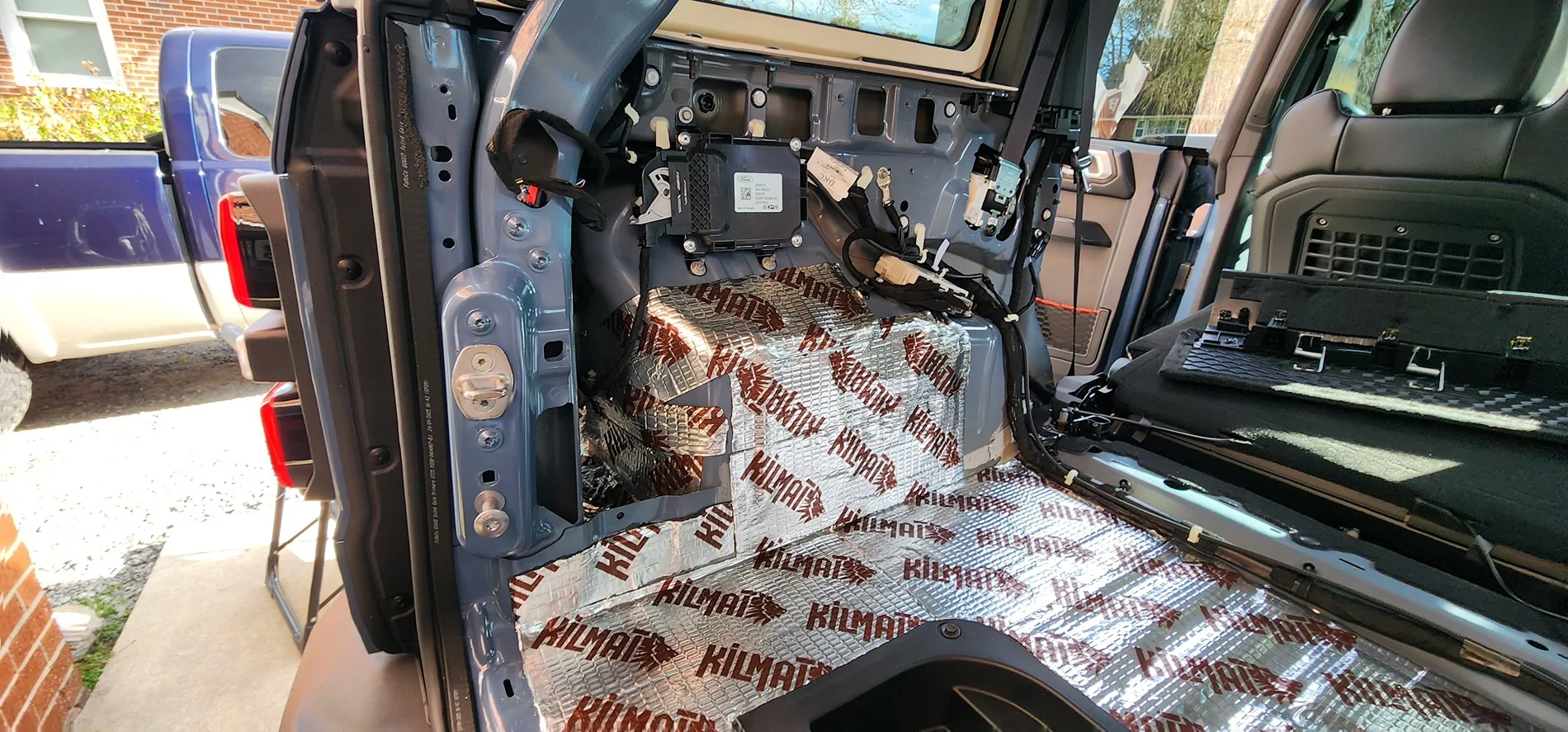

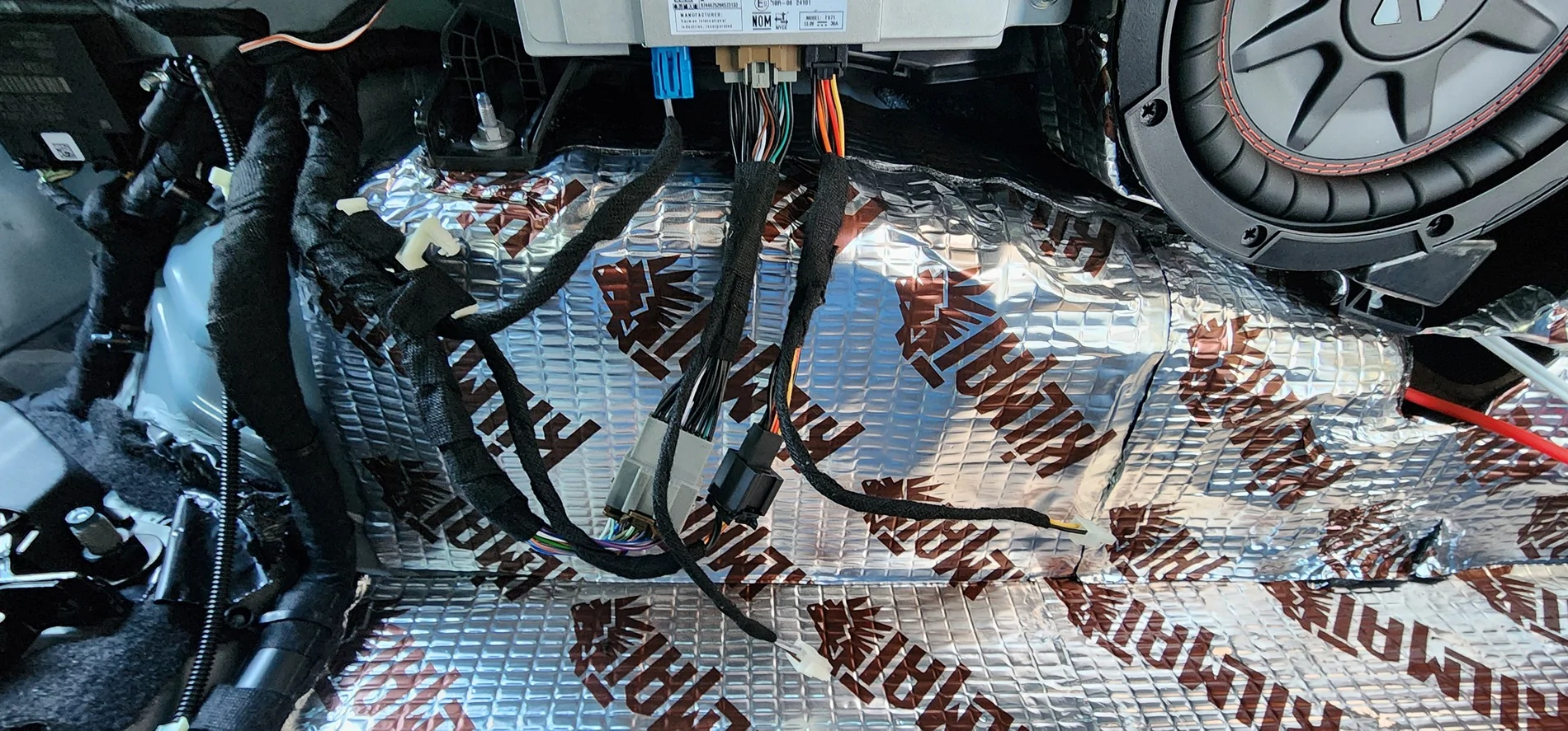

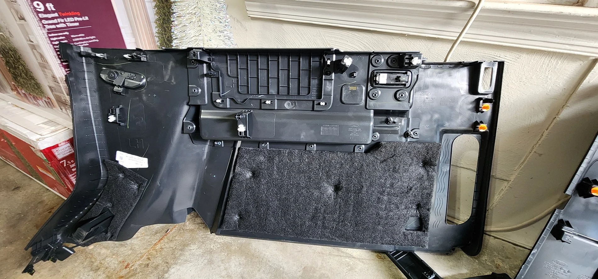

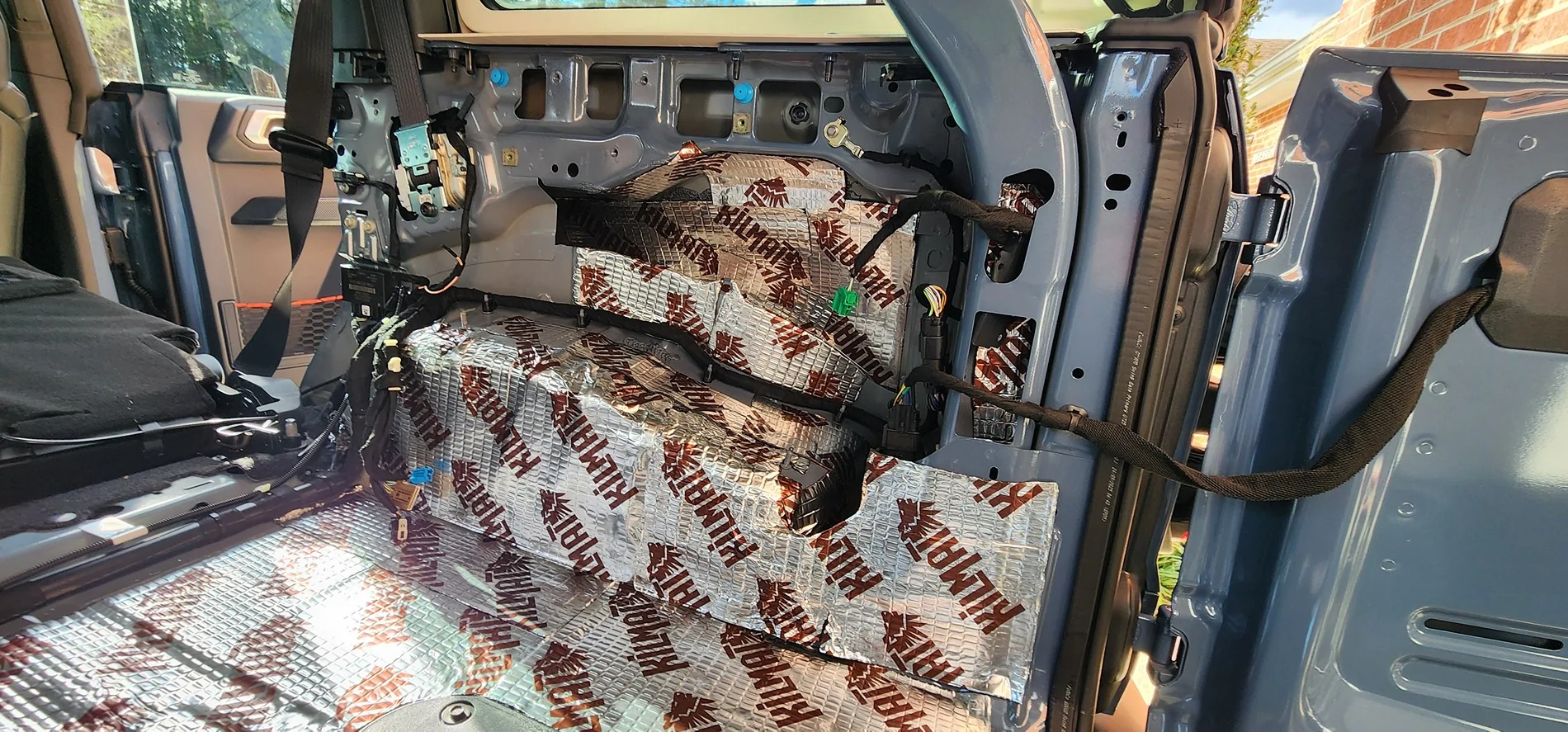

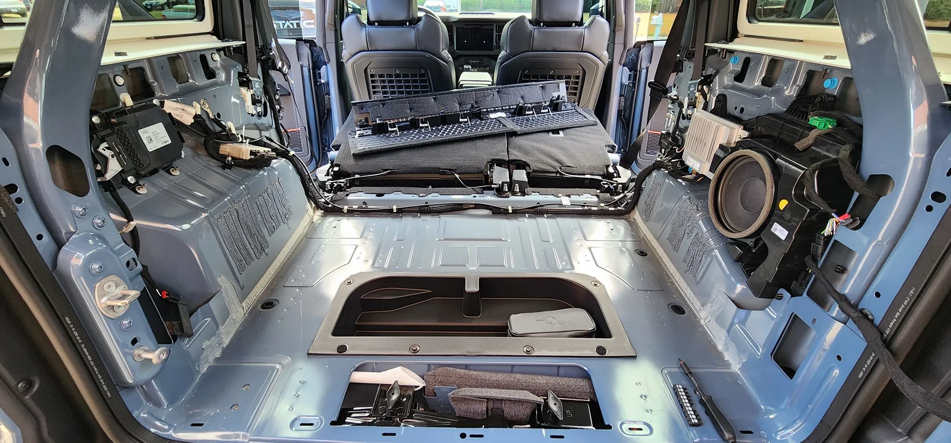

Now onto the rear which was the most work. Entire rear cargo area stripped naked for sound deadening and sub upgrade. Pretty simple here. Here's a couple pics of clip locations on back of panels, and a NSFW Pic of a naked raptor cargo area 😆.
Ford Bronco B&O Stereo System Upgrade on 2025 Bronco Raptor 1000028330
Ford Bronco B&O Stereo System Upgrade on 2025 Bronco Raptor 1000028331
Ford Bronco B&O Stereo System Upgrade on 2025 Bronco Raptor 1000028328

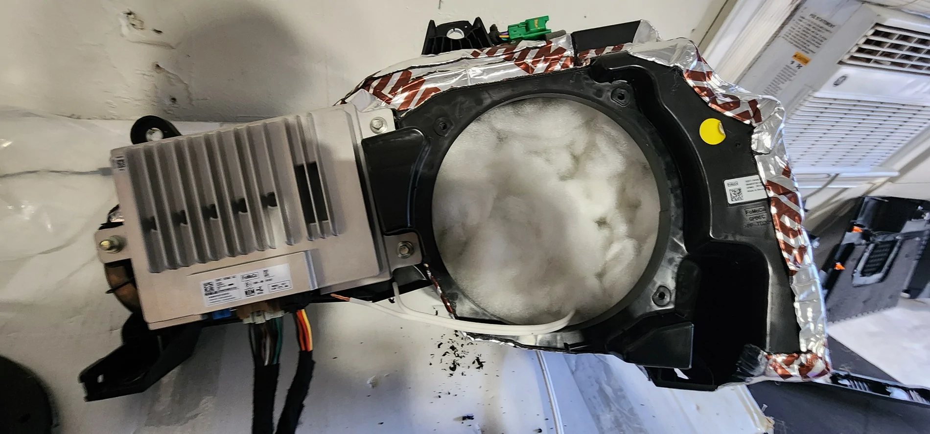

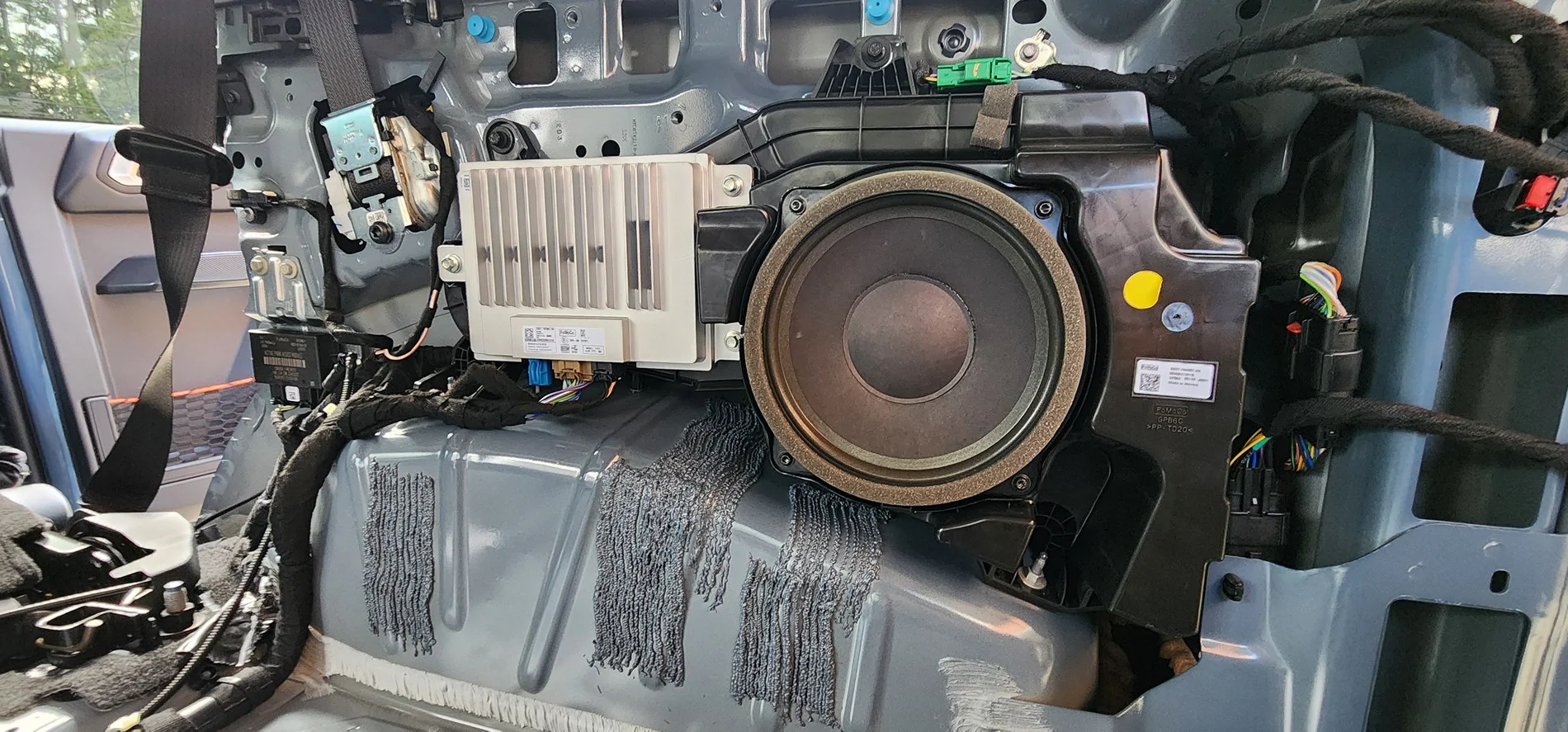

Here's what we're after.... stock sub and amp location. I removed the entire assembly from vehicle to make it easier.
Ford Bronco B&O Stereo System Upgrade on 2025 Bronco Raptor 1000028329

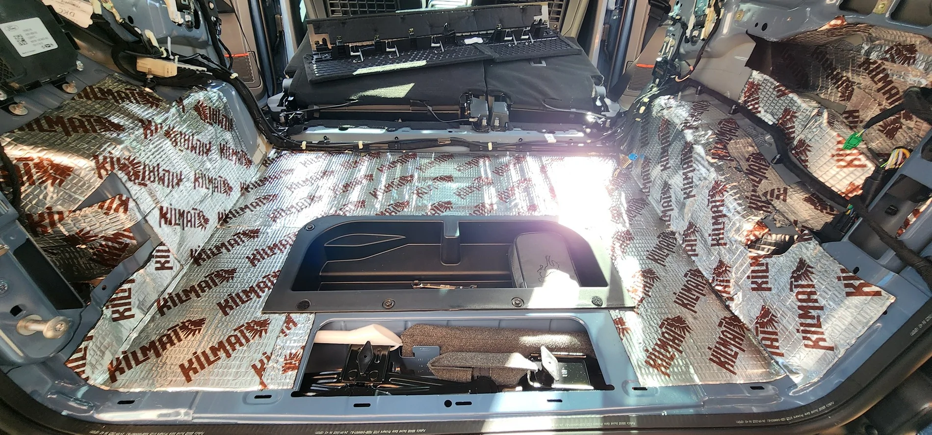

Now I attack all that metal with Kill Mat squares. Amazon $40 well spent for sure. About an hour later, and a bunch of paper type cuts on my hands.... I'm satisfied...
Ford Bronco B&O Stereo System Upgrade on 2025 Bronco Raptor 1000028333
Ford Bronco B&O Stereo System Upgrade on 2025 Bronco Raptor 1000028335
Ford Bronco B&O Stereo System Upgrade on 2025 Bronco Raptor 1000028334

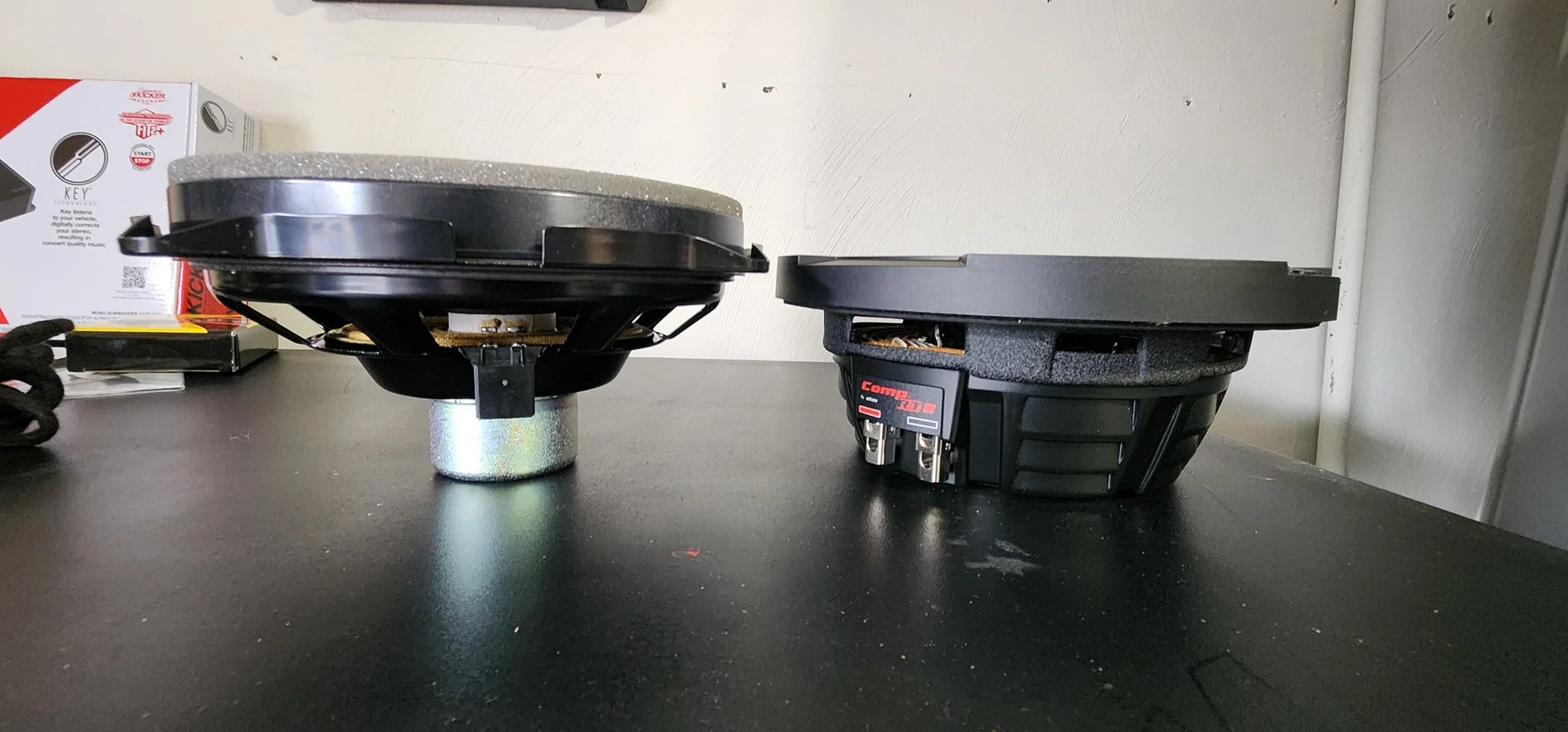

Now for a side by side of stock sub vs Kicker. The Kicker is a shallow mount, but the magnet is considerably larger.

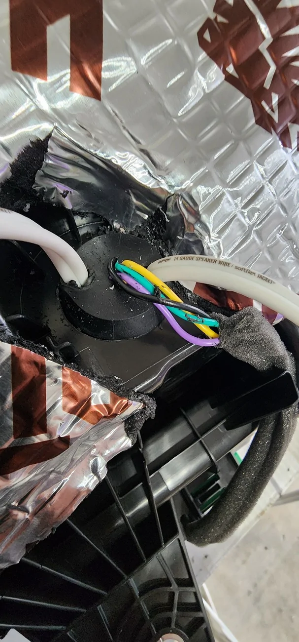

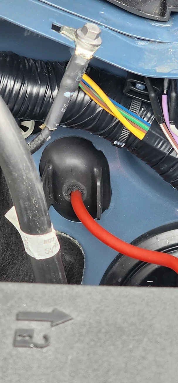

So on the stock sub enclosure I drilled a hole in stock grommet to stick 14 Guage speaker wire thru. Easy money here. Then stuffed enclosure with a crap ton of Poly Fill. I mean really stuff it down in there in all the holes. I used probably 3/4 of a pound here. Then used more Kill Mat strips to cover exterior os sub enclosure.

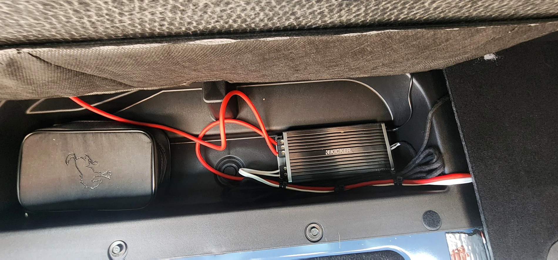

Once that's all in its the easy work. Ran 8g power wire from battery, thru fire wall, and all the way down driver door sill channels to rear cargo area. Let me thank Ford for a second..... the Raptor has 4 terminals right on battery post to hook accessories to (thanks for that), and thanks for the perfectly placed grommet in fire wall to run power wire thru. One of yall at Ford was looking out for sure.
Ford Bronco B&O Stereo System Upgrade on 2025 Bronco Raptor 1000028326
Ford Bronco B&O Stereo System Upgrade on 2025 Bronco Raptor 1000028327

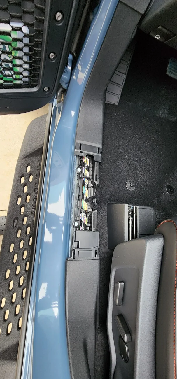

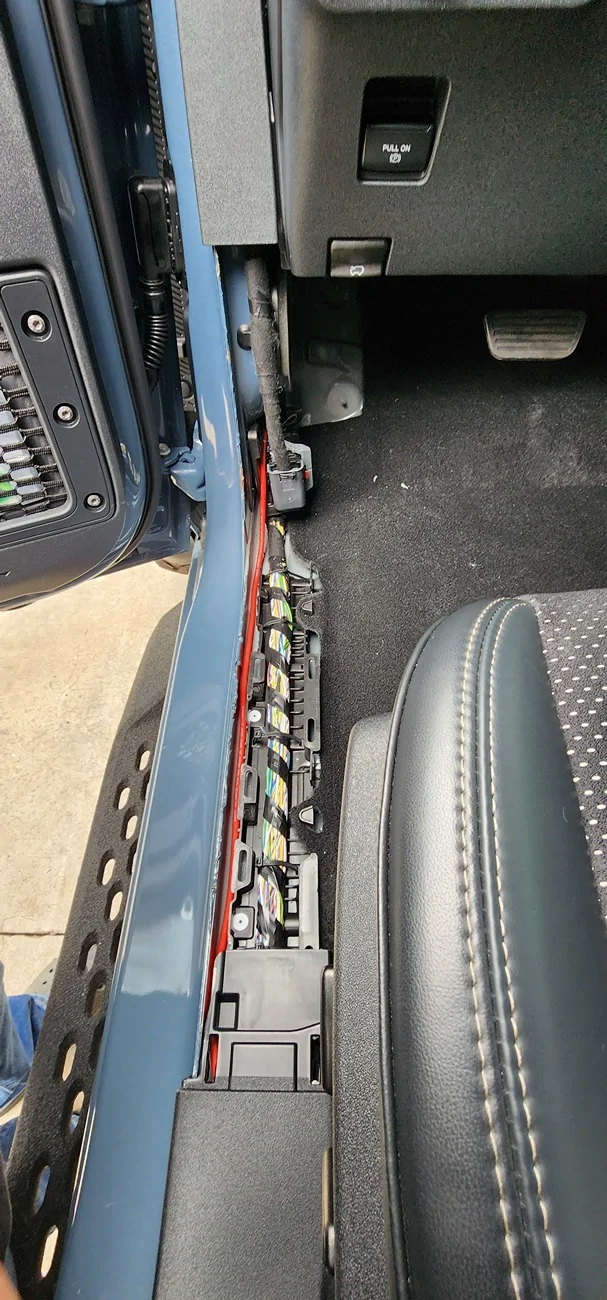

Ground is easy. There's a convenient ground right above stock sub enclosure location. Just ground there. I decided to install the Kicker amp under the floor in cargo tray. Super easy to access if anything needed tuning or fixing.
Ford Bronco B&O Stereo System Upgrade on 2025 Bronco Raptor 1000028555
Lastly I installed the Kicker bass Knob. Tucked the wire very nicely down passenger side door sills, up under glove box area, and mounted Knob just under hvac control Knob for driver. Simple work here. No screws. Just a piece of 3m double sided tape. Put entire truck back together, and let's test it out.....
