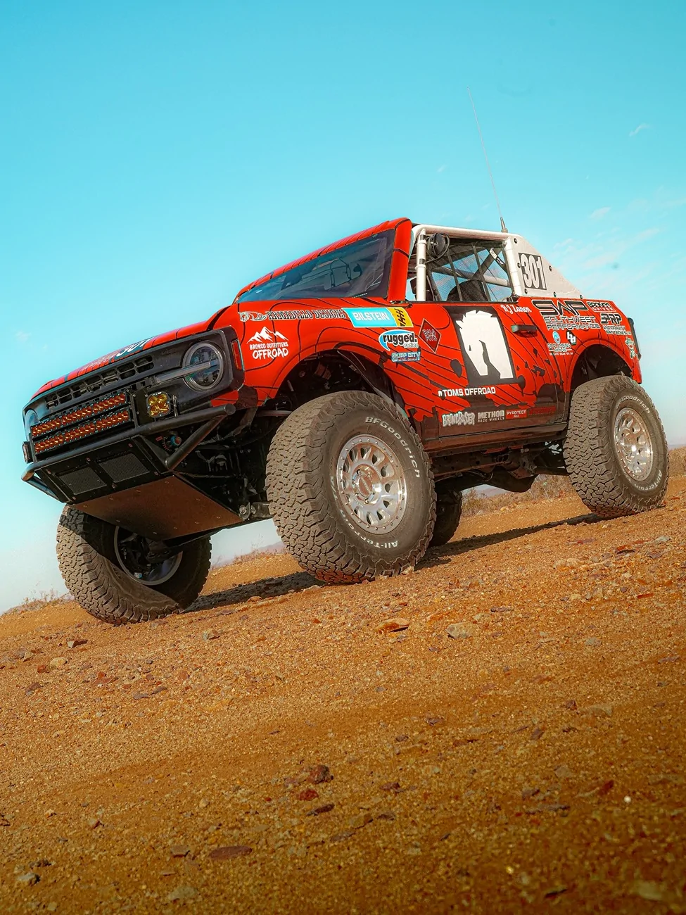

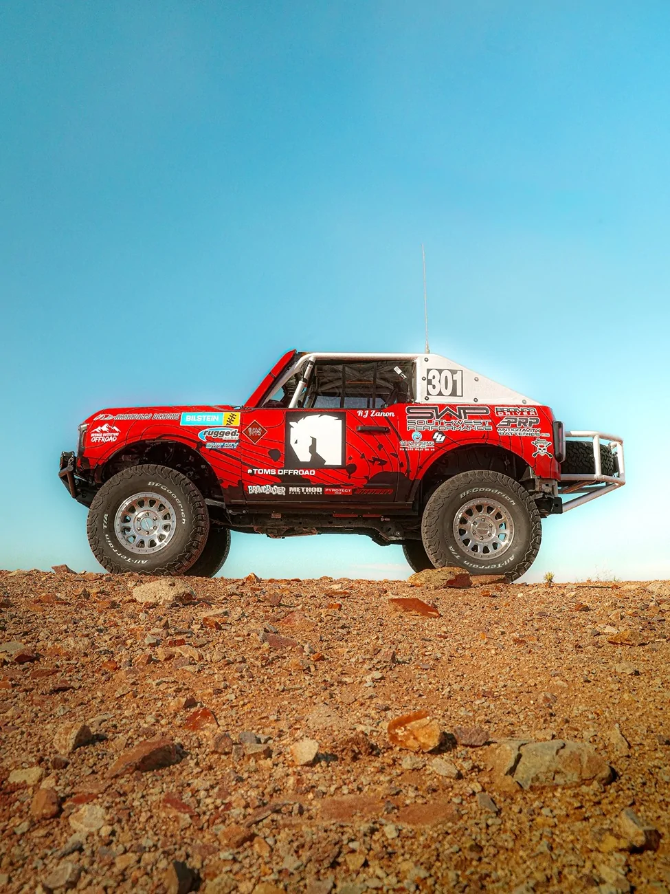

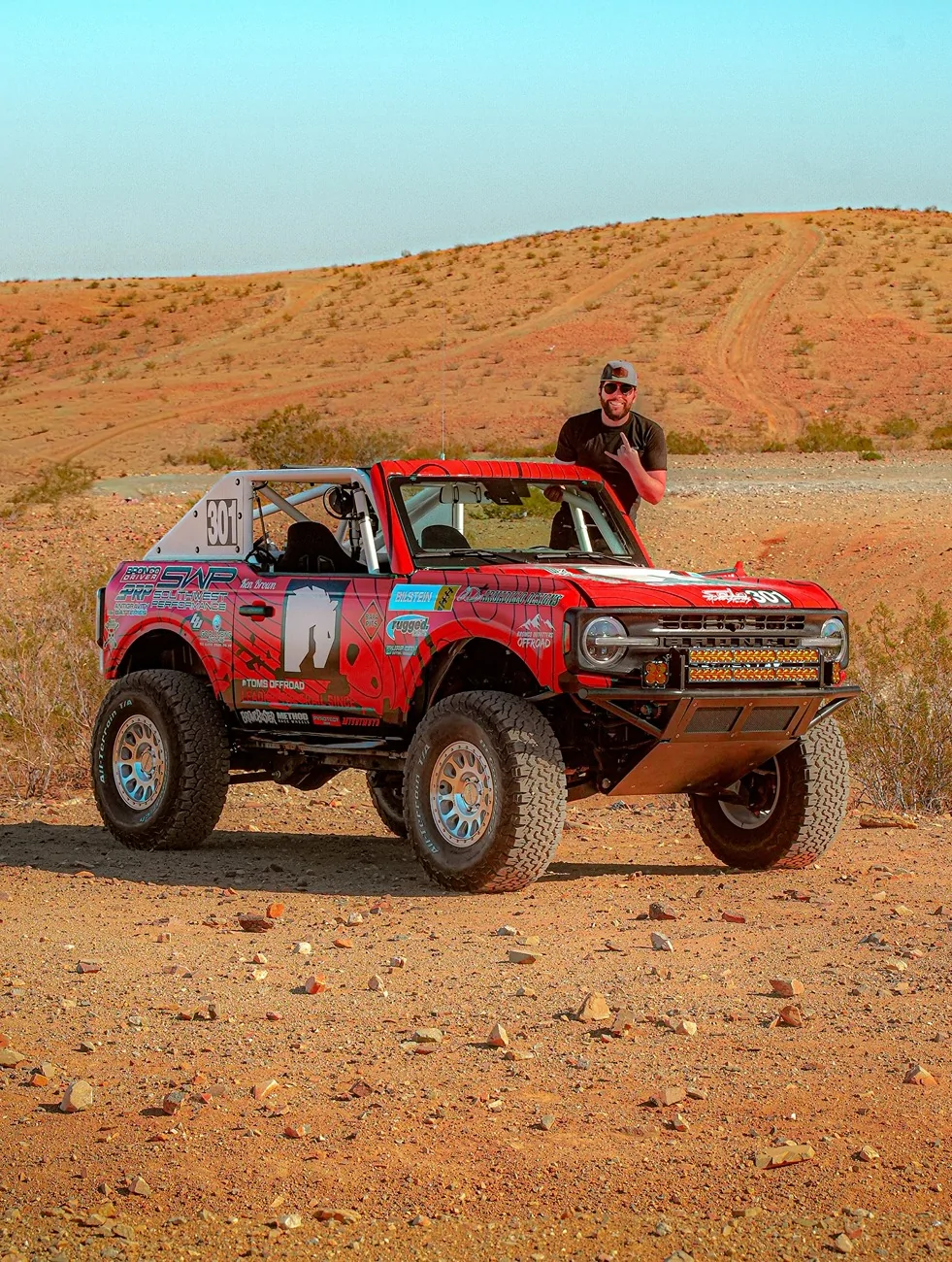

It's been a while since I've been around SCORE or BITD so it could have changed, but I think Class three has to have the production powerplant. So a 2.3 or 2.7.

I don’t really follow offroad racing very much, and my question is, is there anything about this Bronco that all relates to the vehicle we drive? Or does it just look like a bronco but everything in it is 100% custom?
Back in the day, your could have ordered a Stroppe Bronco like what Bill drove, similar to the relationship with Carroll Shelby and the GT350. A stock vehicle that was significantly upgraded, but it started life as a normal Bronco.
Is this only about brand recognition? Or is there something from these Broncos that actually trickles down to consumer Broncos?

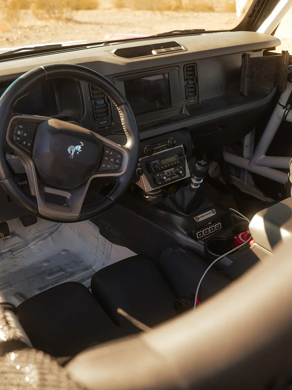

This was the build that @pewpew_cachoo and Armadillo were building. Man, I have to say it came out really nice. It is set up for the race, but it has a lot more in common with a 6th gen than you may think it does.
thanks. Could not tell just from the photos. Here is an old article that talks about the King of the Hammers race where they specifically talk about it starting life as a regular Bronco. I was just curious if this was just “called” a Bronco but had no actual Gen6 Bronco parts in it.

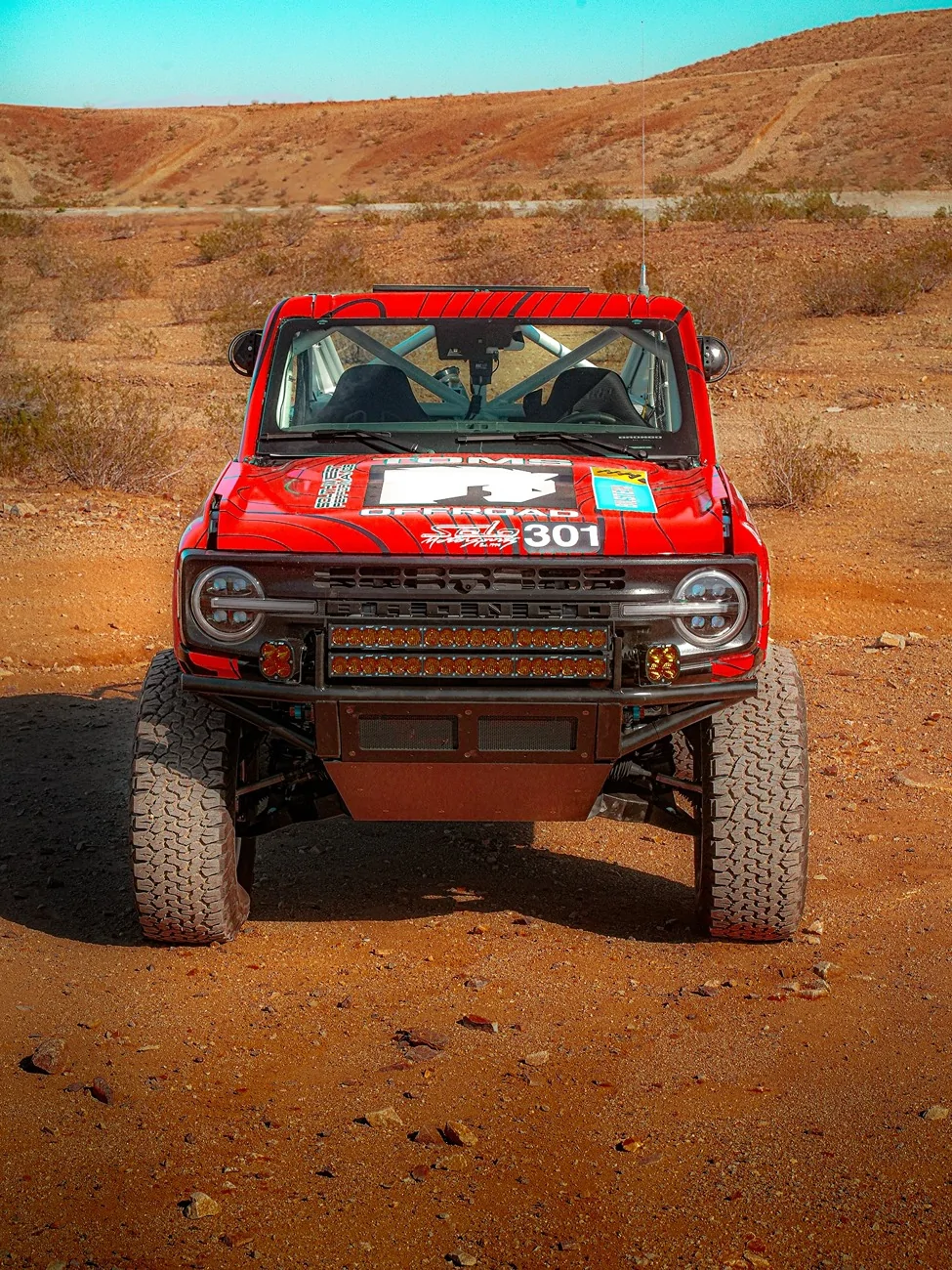

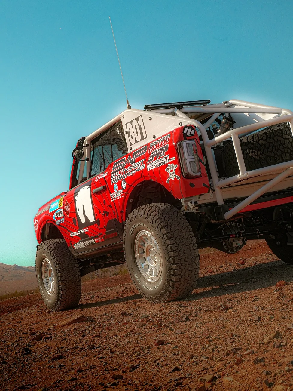

Looking real good. Im sure they have run it but I question the cooling. They have two light bars right in front of the part of the grille that flows air to the rad.

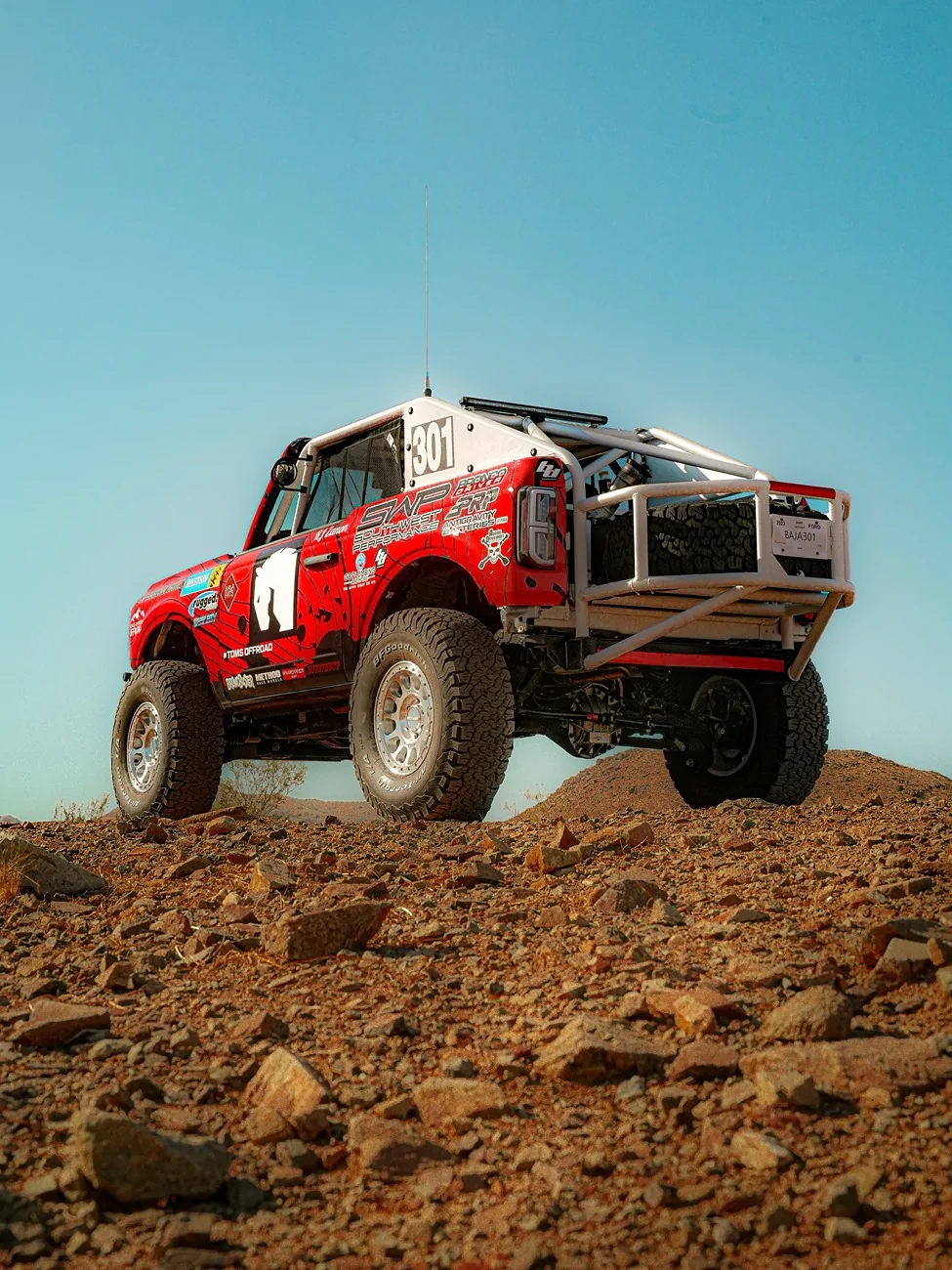

Very badass Baja racing rig! A proper 2 Dr as well. Class! :sunglasses:
If that's stock class in SCORE, I'm sure it's the 2.3 with that manual, but if the rules allow and something else was shoehorned in there, would love to read about it and the other mods like the front axle, etc.
Love the livery as well. Ready to podium I hope.

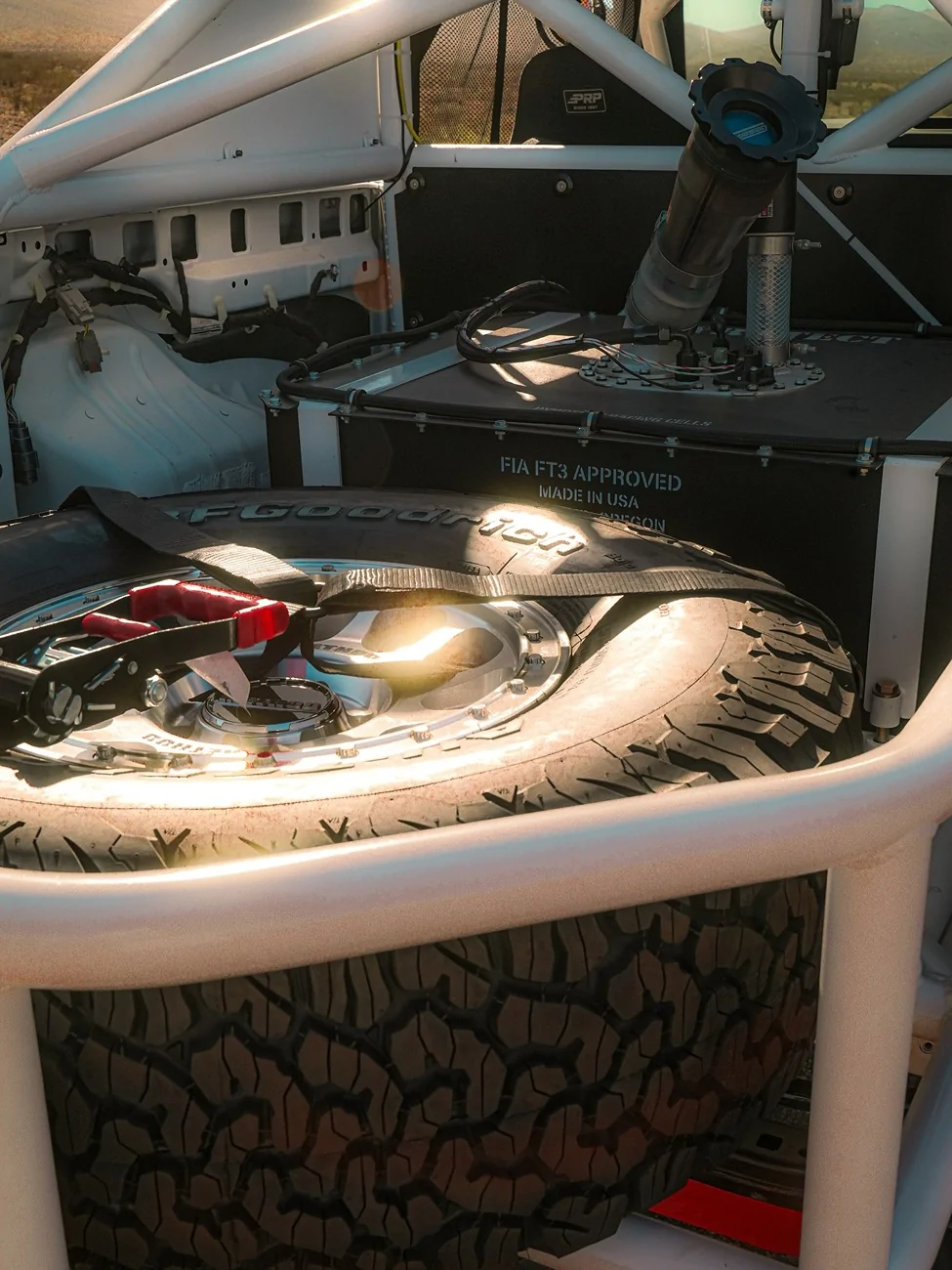

I’m on the race team as a chase/support crew member. I don’t have exact specifics but it’s a Stockish base bronco with 2.3/manual, front HD spicer diff, rear Dana 60, spec roll cage and Bilstein 8112’s. Honestly it’s a bolt on parts bronco and not super different except roll cage, lack of roof and the fuel cell . What is super cool is that he got it built from a junkyard bronco set to be scrapped. Stoked to be on the team!
The vehicle isn’t quite finished yet;) testing coming soon haha. It’s a very grassroots team without any external funding really. I’m using my own vehicle and parts/tools for the Chase setup
