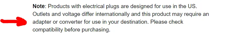

Ford Bronco 120v ac outlet ideas 1646405026730
More research OP!
More research! Pic from bottom of website.
No mention of 60 Hz
No mention of pure sine versus modified or "dirty" electric
Slow down......
Watch solar/RV power videos over the course of a few days.
You will gain the tools you're seeking from those who went before you.
Also, crock pots pull a shit ton of juice. You may want a larger application.
