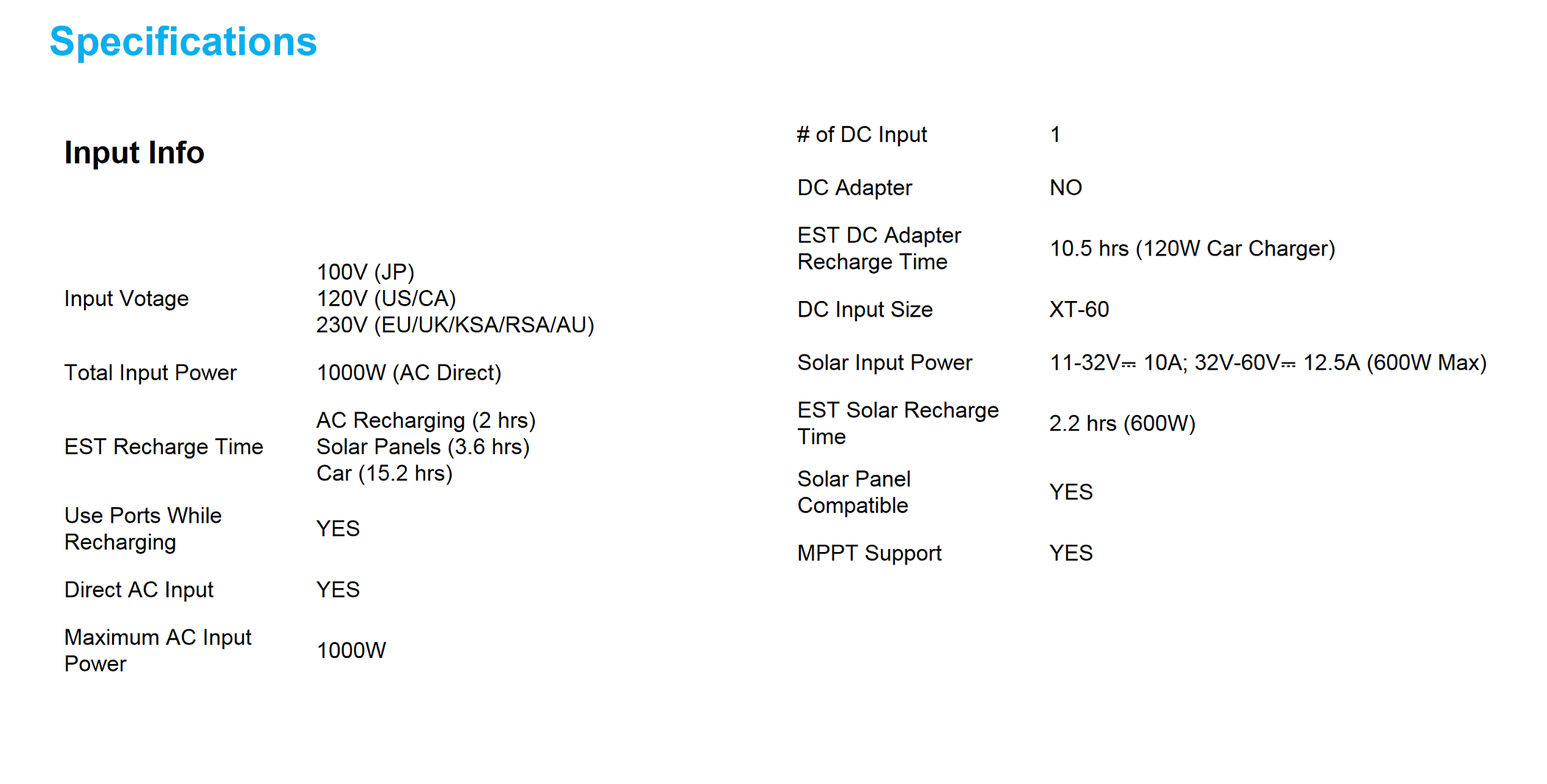

Hmm it doesn’t actually list the specs you’d need to be looking at. Just “recharge time” which doesn’t mean much
It also wouldn’t be the first time I’ve seen a report of a power station either popping a fuse or melting a connector that is rated higher than its supposed DC charging rating. I think a lot of these units are not respecting the DC charge rating.

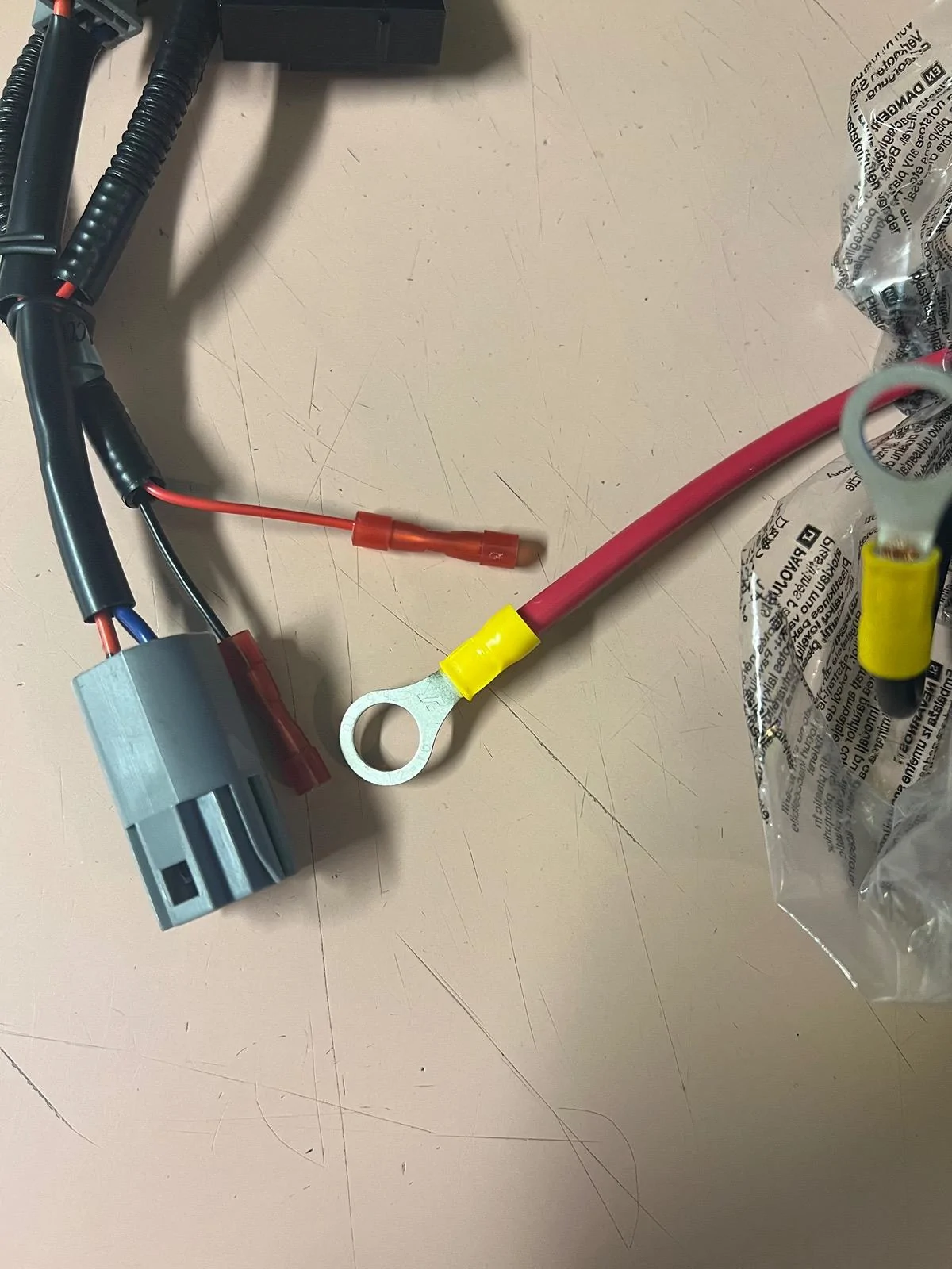

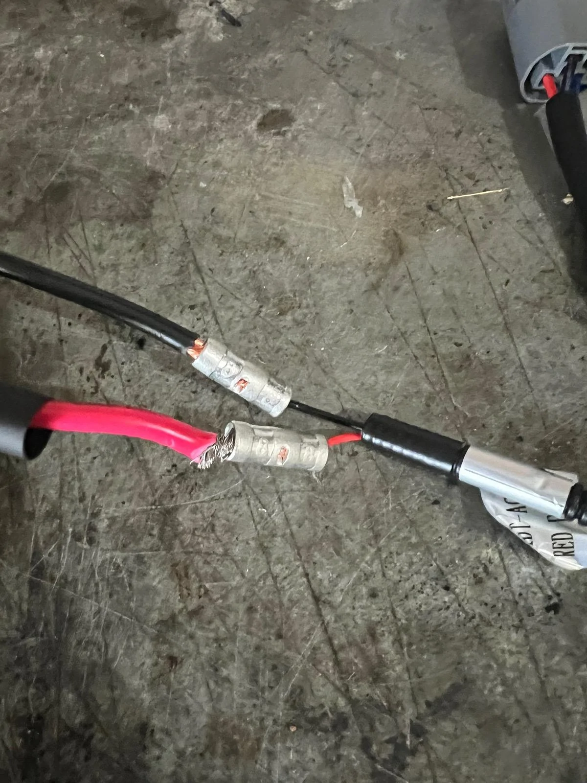

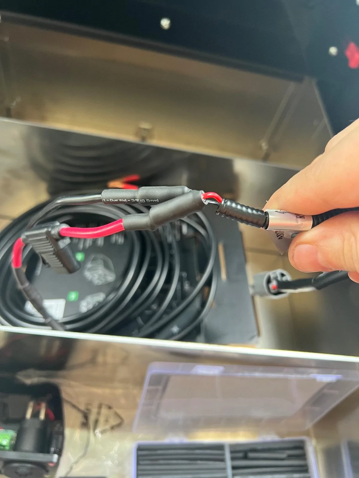

The other thing to look at would be those butt splices and anywhere else you make a connection - it looks like you used bare splices, which is fine, but it just takes a fraction of a second of contact somewhere where it missed with heat shrink or electrical tape to short and arc - worth taking a peek at and making darn sure the shrink didn’t pull back or start strand of copper poking out or wire pull through or just missed a backside or something. That heat shrink does look a bit short…
I have everything pulled apart now, I will go through and double check everything. These terminals here, just bare wire goes into it correct? I believe this is the only place where any copper is showing. Should I try making the exposed copper shorter?
Got a pic of how it looks installed? Usually you do try to cut the wire short enough so there is no copper exposed, but sometimes that isn’t practical and a millimeter or two (so long as it can’t touch the other side) will work

A gray 2 amp fuse
Yep, way too small. Those specs you posted says it has a 120W DC charger. 120W / 12V = 10A. I’d try it with a 15A fuse in there (assuming all the wiring/connections are still sound).
