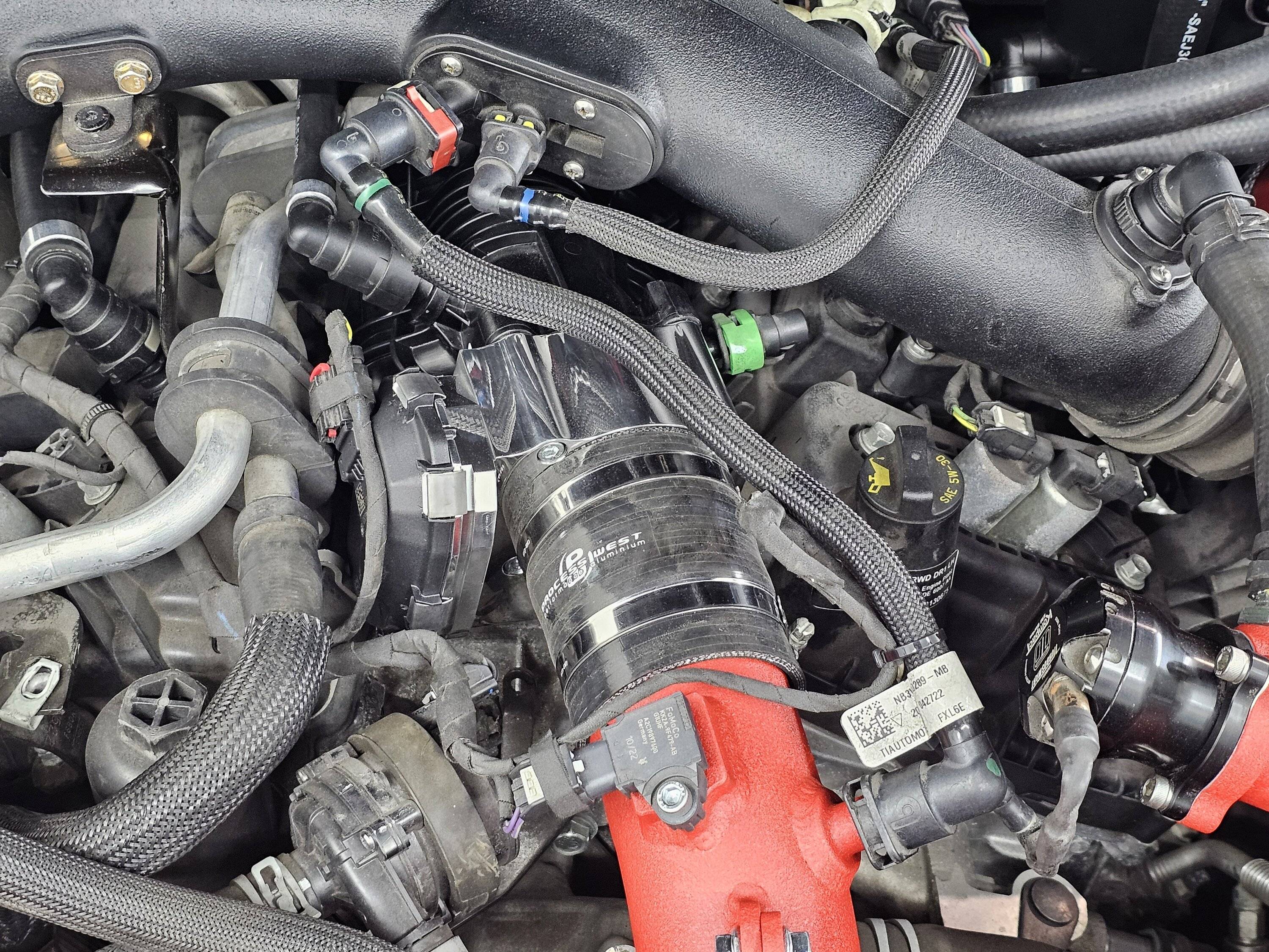

https://performanceparts.ford.com/part/M-9926-M2370B
Installed this today. Works well so far!
Had a ported one from gig performance. But it came with defective motor.
So I did the math just to have a grasp of the difference which is .146” or just over 1/8”. I can’t imagine it makes a difference you can feel or measure on the dyno. But I’m no expert. Porting is another story if things are mismatched inside the runner.

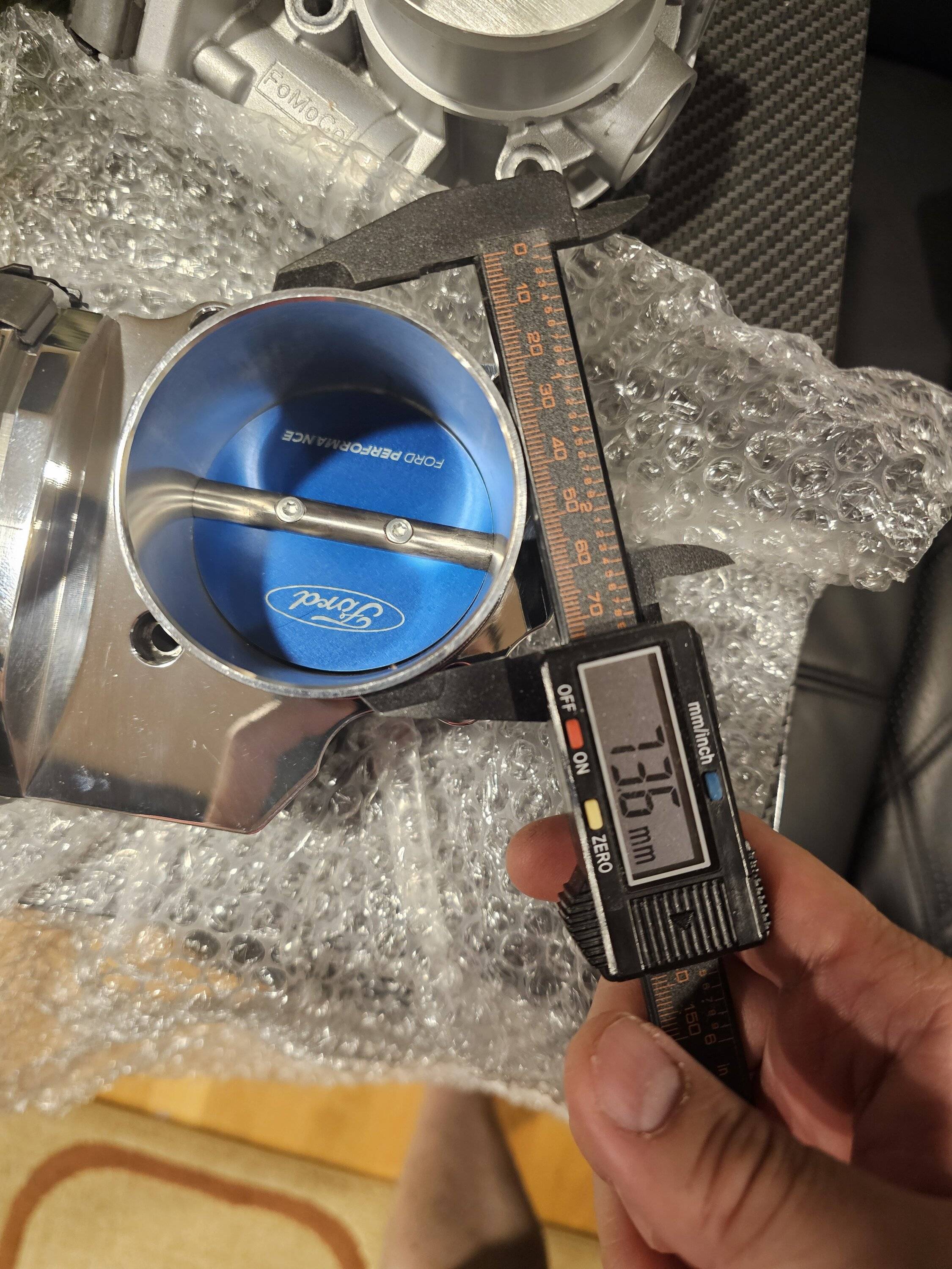

Grabbed this off the mustang forum
Stock is 63mm inlet, 61.4 mm outlet, and about 60.8mm in the central section. The FRPP 70mm is 70mm inlet, 65mm outlet (matches the intake manifold opening).

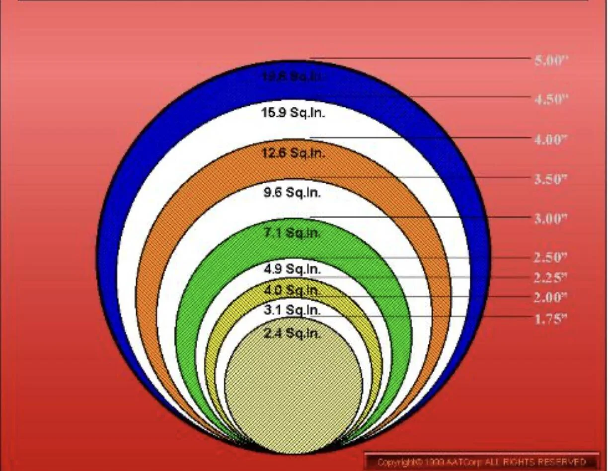

Need to look at it differently... 'area'
Throttle Body, Valve (plus lift), Pistons (plus stroke) Exhaust... etc
Ford Bronco Ford Performance Throttle Body installed on Bronco Raptor Screenshot 2025-07-10 at 1.56.30 PM

Oh, I understand volume, but there’s a big difference between .147” and .500” volume wise.
