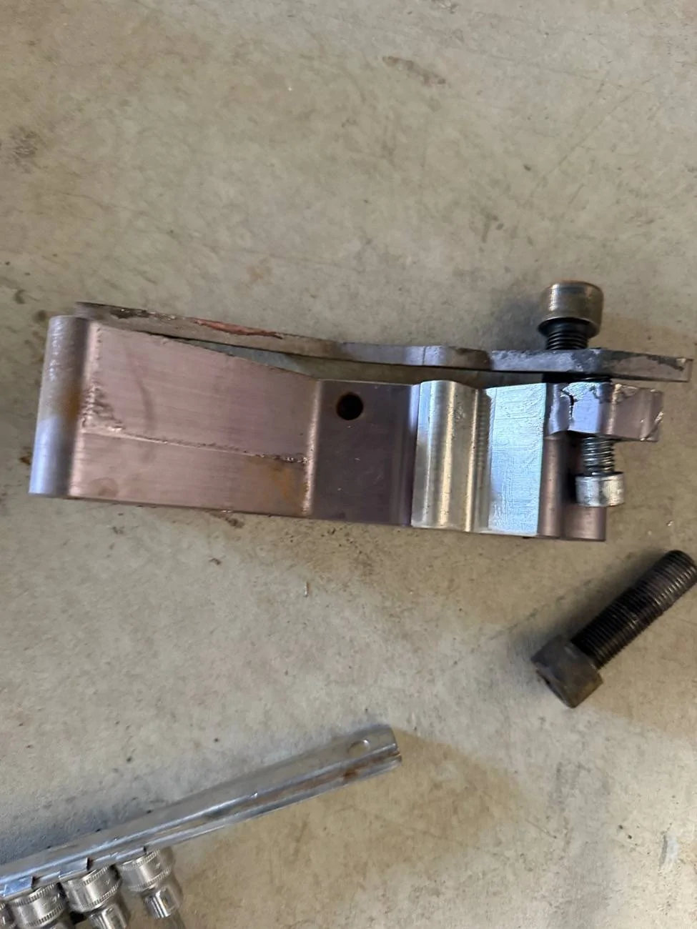

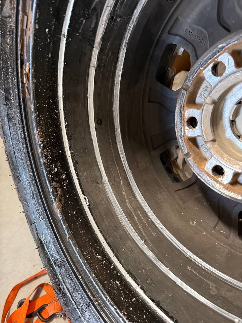

Interesting timing seems how this literally just happened to wifey yesterday. Caliper and associated equipment destroyed. Luckily she was on the offramp from the interstate. Left a good 50’ skid from the locked up tire on the road when the caliper stopped cutting it and wedged itself into the wheel. Rear portal this time. (The brackets we made up front are still solid) We held off on changing them as we have a big trip next week so figured might as well change the oil and do everything at the same time. Also-quin’s latest explanation for the failures was that they were sold counterfeit loctite. “Nothing was wrong with the bracket design or tolerances.” Apparently.064” difference between the front brackets was correct and how they designed them. They must have made new ones just for practice. They also said they would have a video explaining the failures at KOH. Weird that we haven’t seen anything yet.

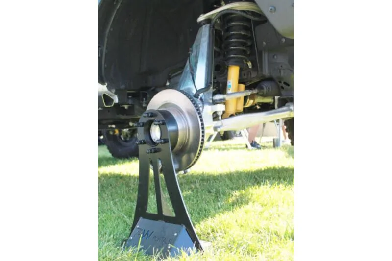

@SierraBronco at this point I pretty sure you are abusing your portals. According to the 74Weld literature you can't use tires, only stands.
Acceptable stands for custom cars
