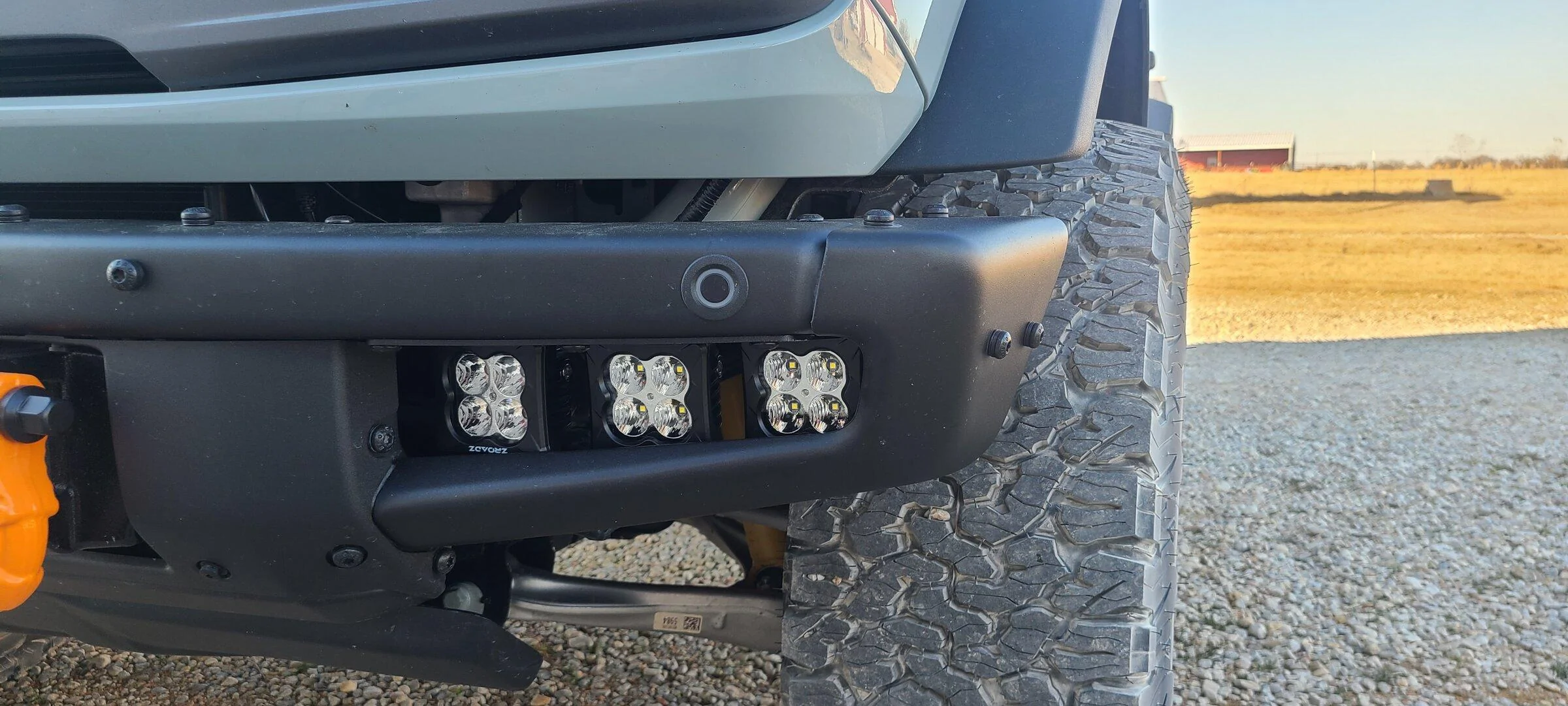

Yep, 1.5" from CJ Pony parts. So far, so good. Coming up on time to recheck the torque but they haven't loosened on any previous checks. With the 315's on the stock BL wheels it gives about 2" of poke from the stock flares... you will get very dirty
Edit just to say you won't have any issues fitting a 1" with factory studs., my factory studs sit flush with the spacer and those pockets on the back of the BL wheels look about .5" deep, eo you'll clear without any trimming.
Was taking a picture of my fogs here but you can see the poke with the tires/spacers

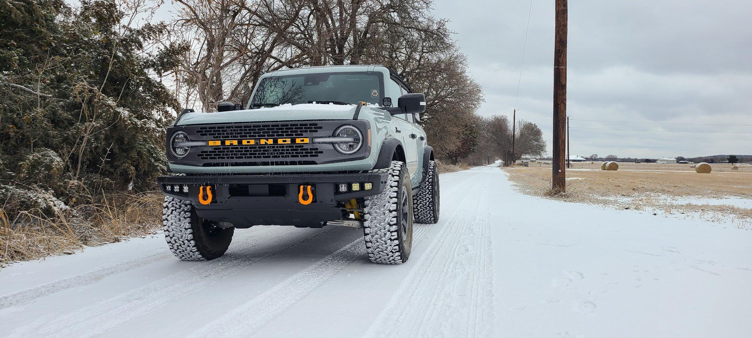

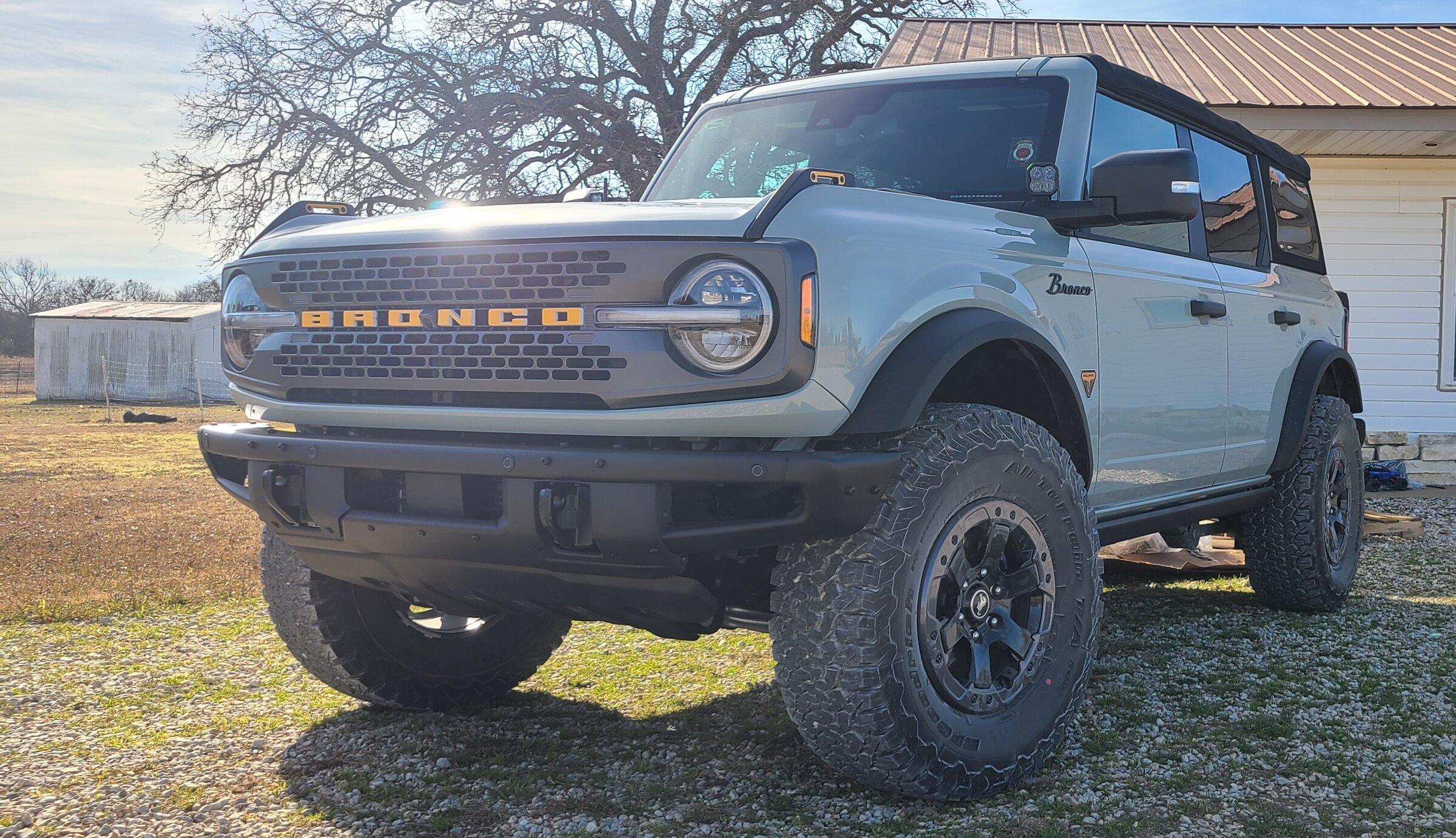

Non-sasquatch, beadlock capable badlands wheels.
Ford Bronco 1.5" Wheel Spacers on Sasquatch? 20220113_104631

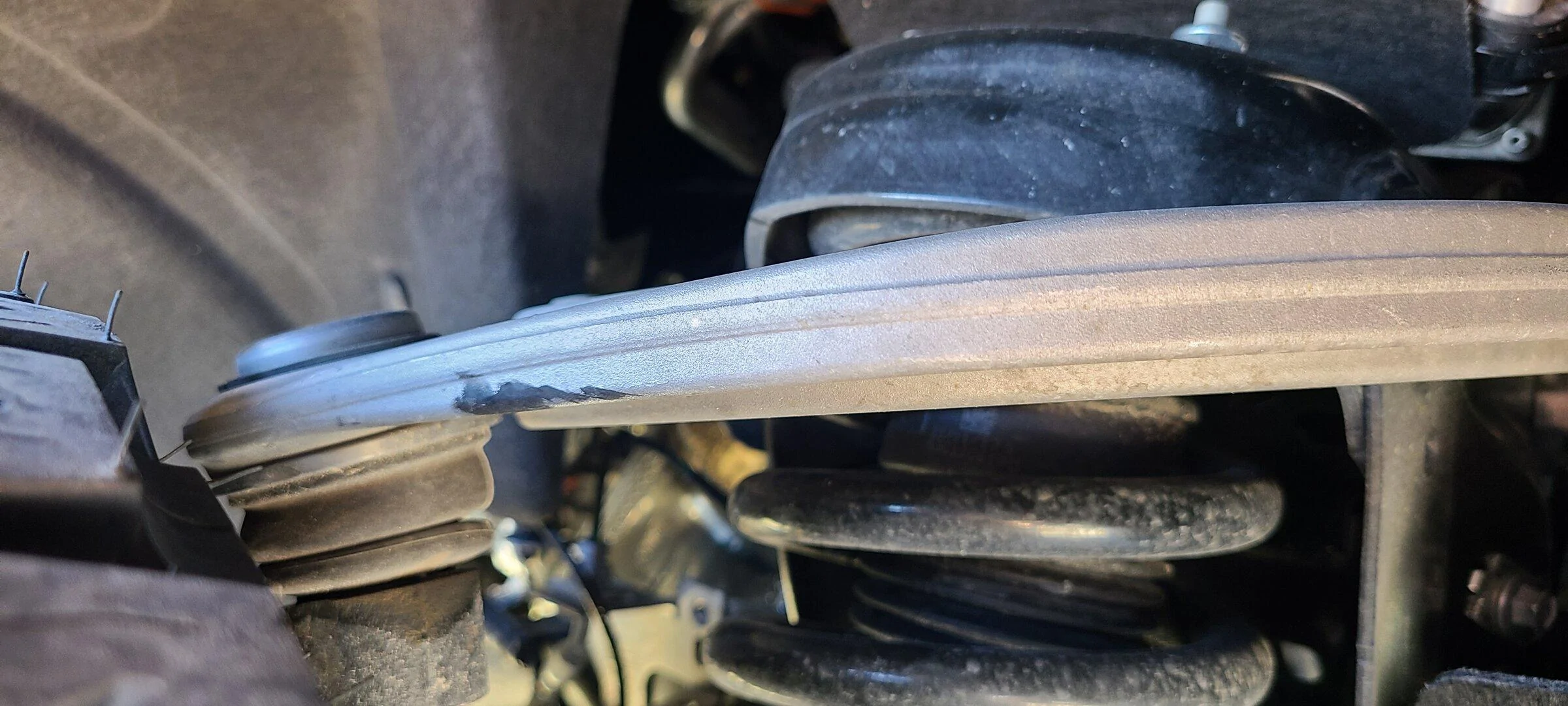

This is before the spacers, without them there was only a very slight rub on the front of the UCA at full lock that you can see here so in all honesty the 1.5" is probably a little much... but it looks cool
Ford Bronco 1.5" Wheel Spacers on Sasquatch? 20220113_124957

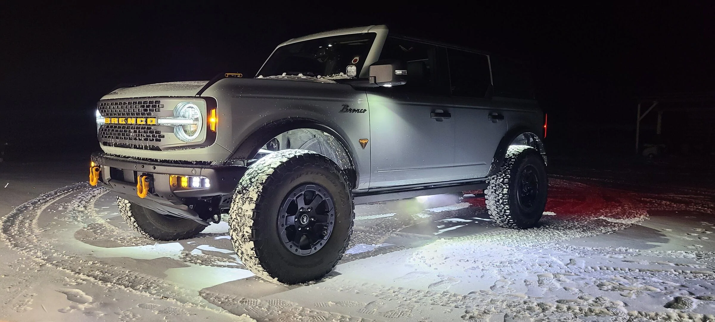

Thanks! It has a 1" level on it, those pics are pre spacers. Here's a couple with the spacers on.
Ford Bronco 1.5" Wheel Spacers on Sasquatch? 20220203_162847
Ford Bronco 1.5" Wheel Spacers on Sasquatch? 20220129_162739
Ford Bronco 1.5" Wheel Spacers on Sasquatch? 20220203_200732

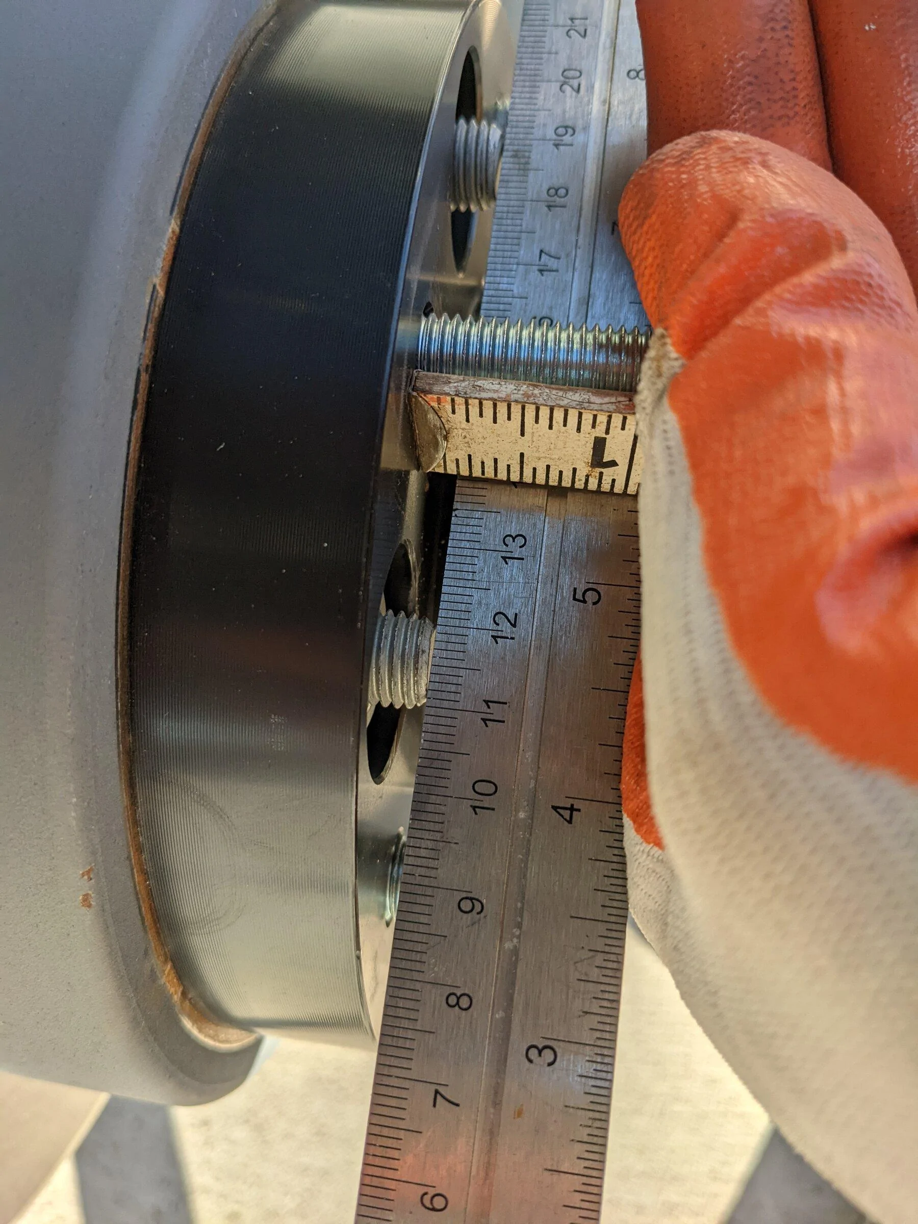

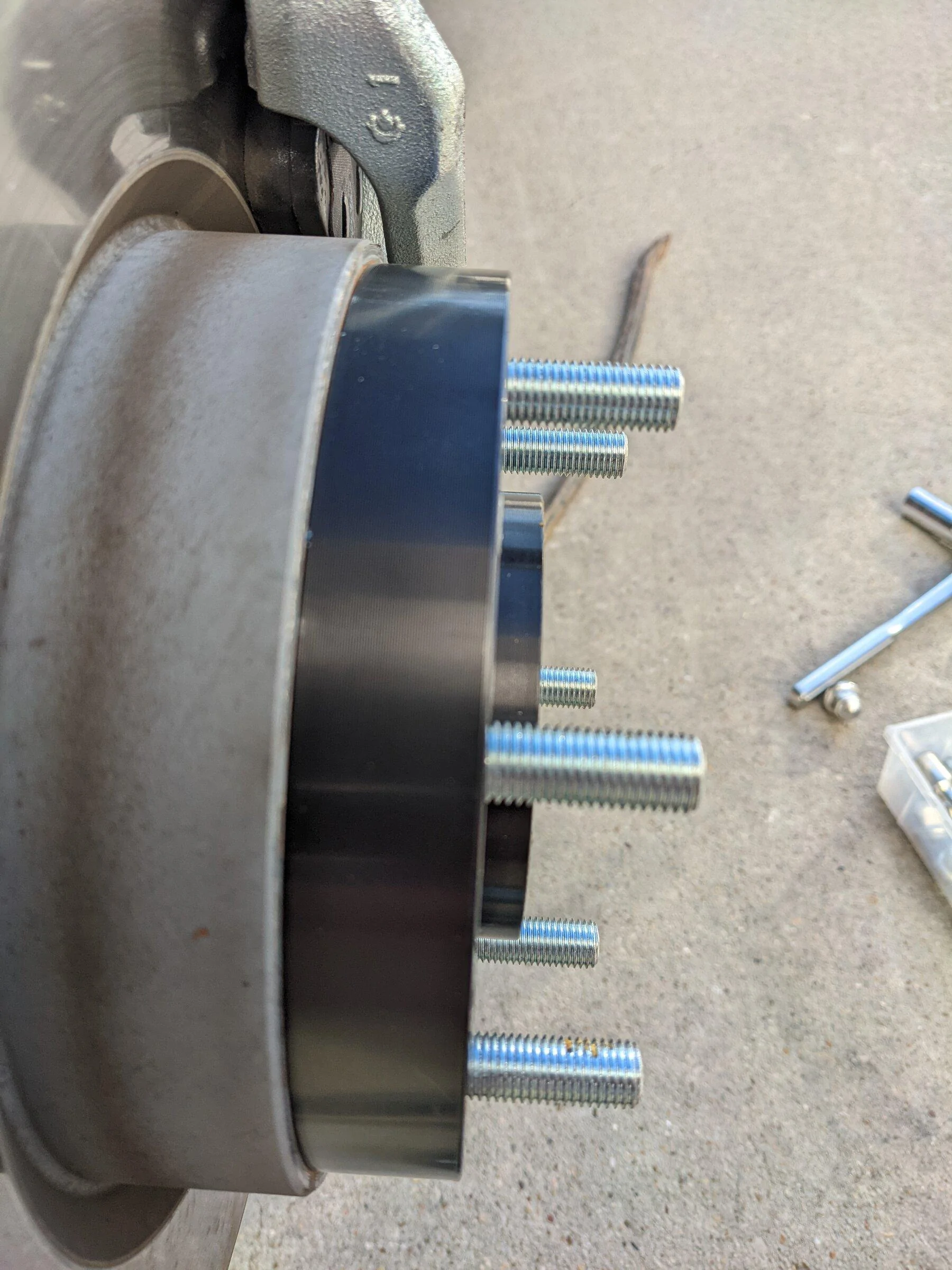

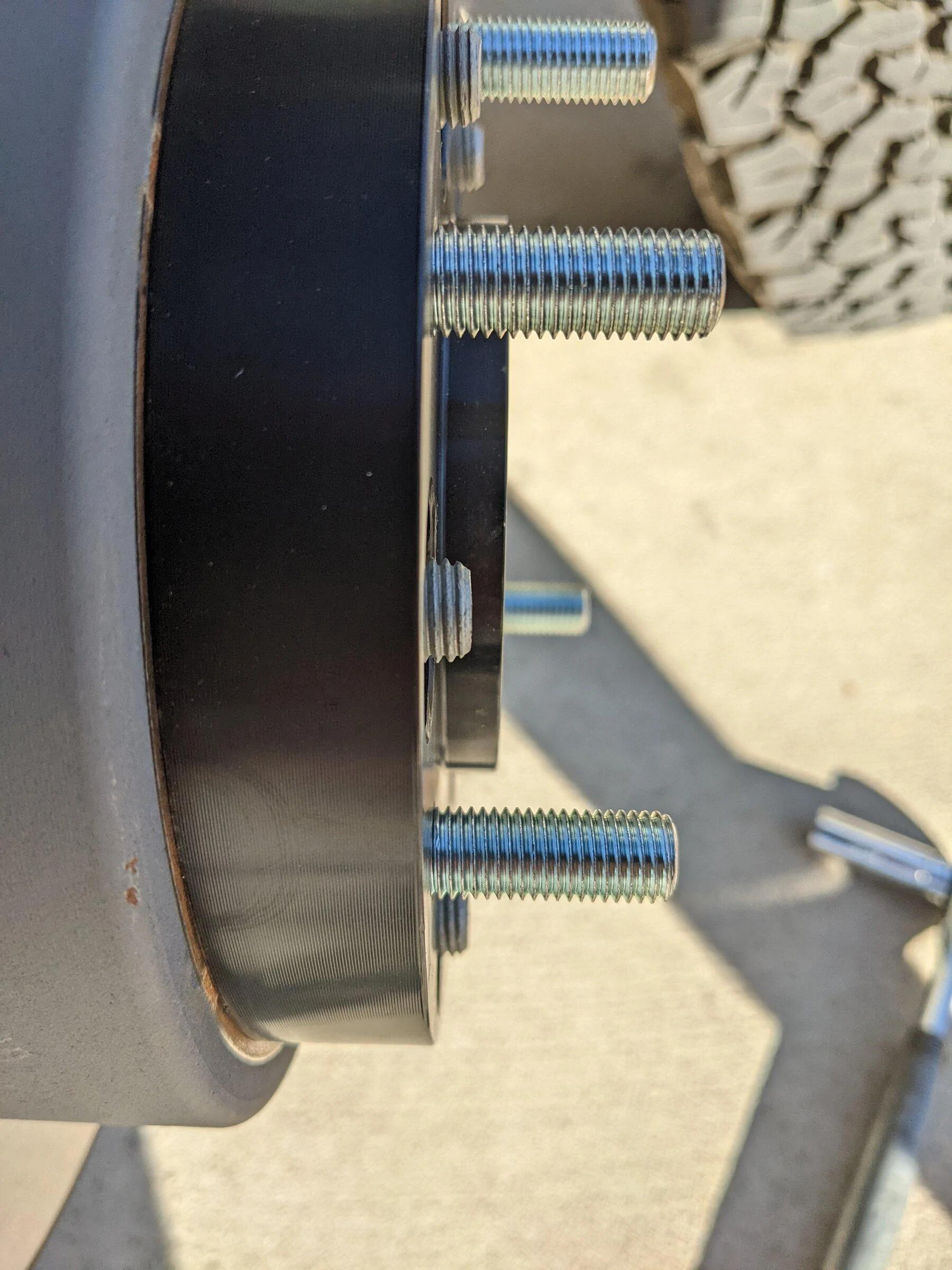

Installed my Bora 1" spacers on my wife's BL with opt wheels. The spacers on the front were flush with the studs. On the rears, the studs pokes beyond the spacer 3/16"
Front
Rear
