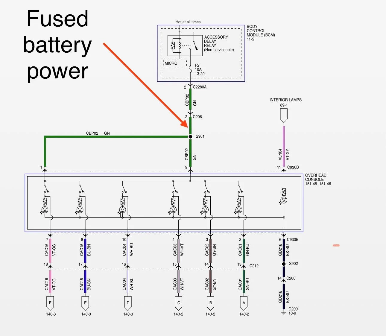

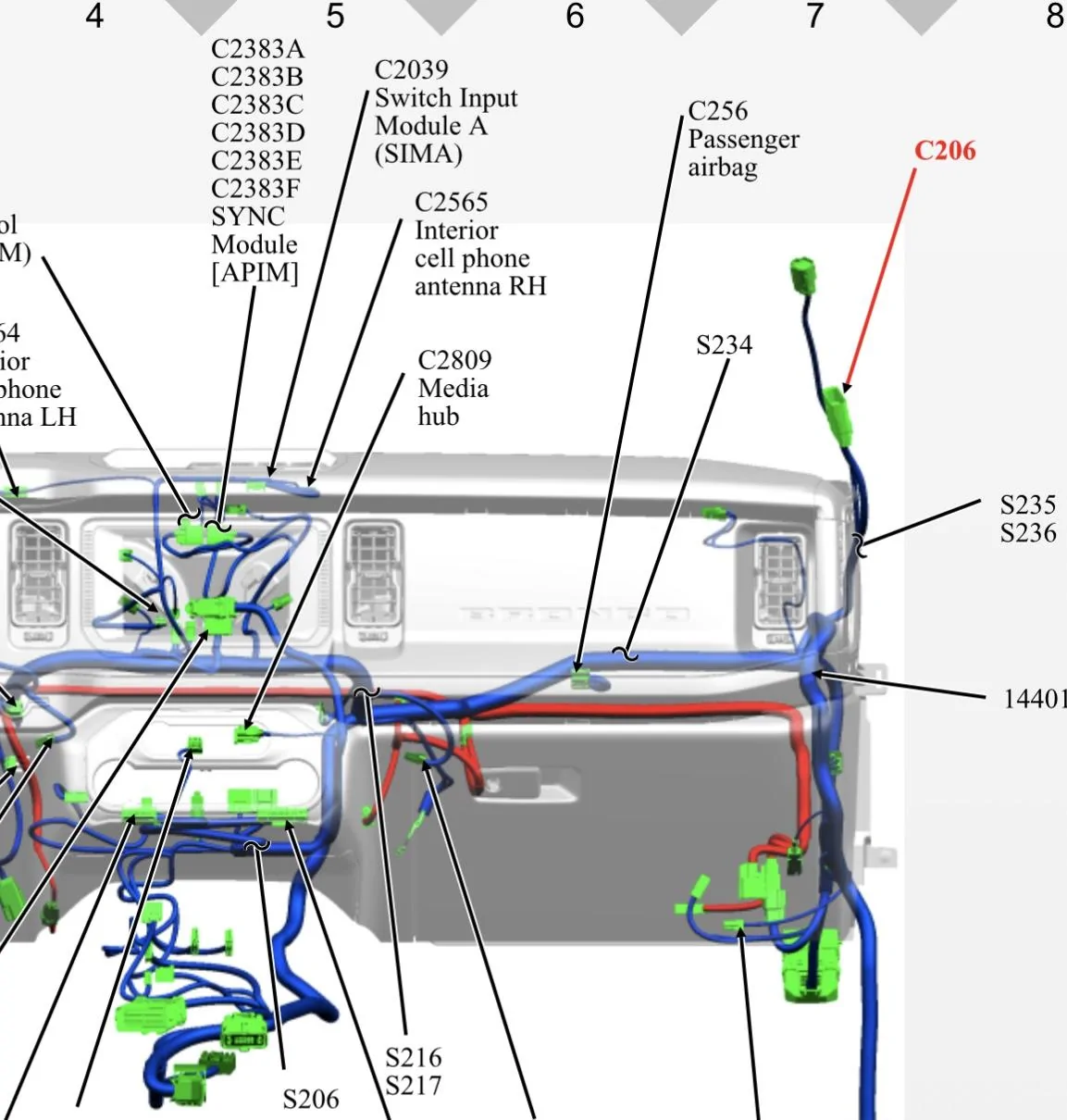

Ducati1098
3,807
7,651
Midwest
2022 Bronco Wildtrak, 2012 Ford Fusion
That’d be even better - then I don’t need to re-wire anything. Any FORSCAN experts out there? @Ducati1098 - you’re pretty smart. Is this possible?
Unfortunately I don’t think any method of forscan is a possibility, at least not that I’m aware of.
The aux switches receive power from the accessory delay relay in the BCM. I highly doubt there would be any forscan programming option to power the switches at all times as this relay also sends power to other interior things when energized.
You would need supply power to the switches your own way instead of using the accessory delay relay.
(I think this would work, but hard to say for sure without actually trying it)
The easiest way would be to remove the pin on the aux switch side of connector C206, before it splits off to the feed the switch pack, and splice in your own fused power circuit straight from the battery.
