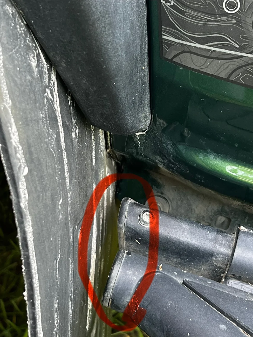

version 1.0 you make a simple hanger to bolt off your rear crash bar mount instead.

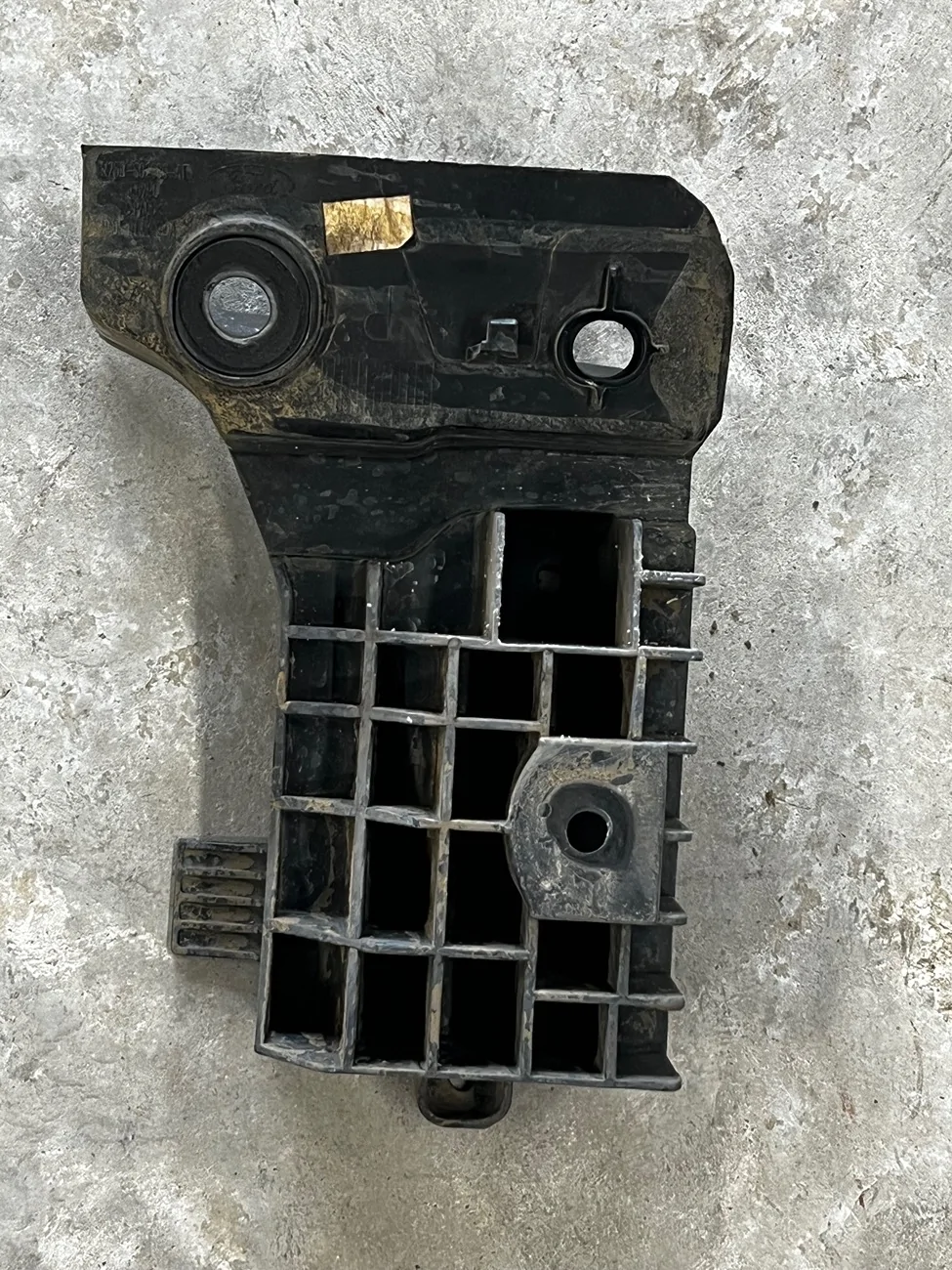

I removed the plastic block behild the front wheels for extra clearance and it makes easier install for the mudflaps also. If you don’t do this you need some spacers so it sits flush.

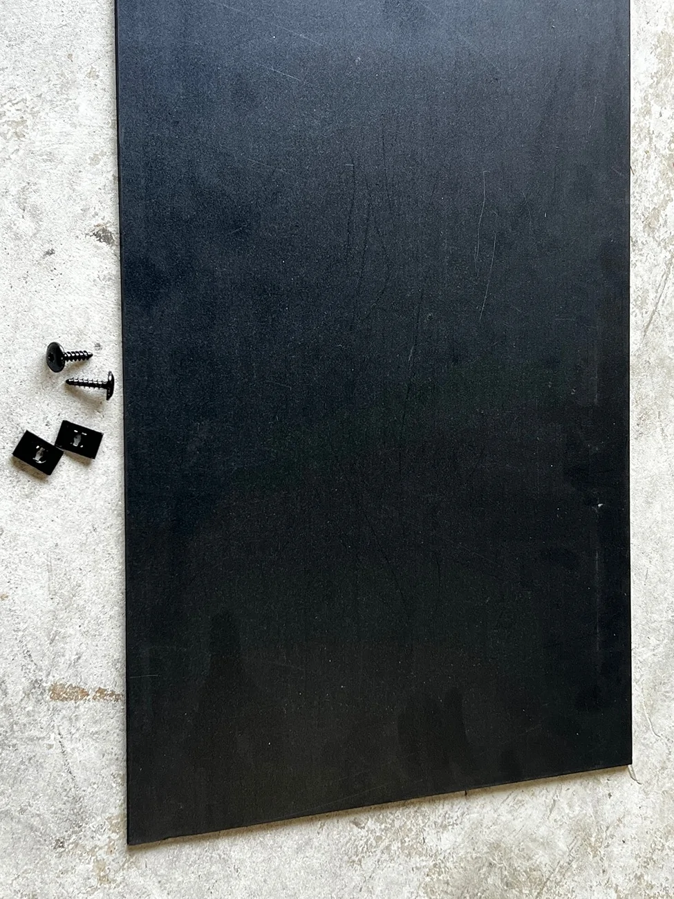

Amazon mud flap blanks under $50 pick the size you want to work with. Product is = Buyers Products RC18PPB Black Polymer Mud Flaps.
This polymer can be folded back on itself and not break, it’s darn tough.

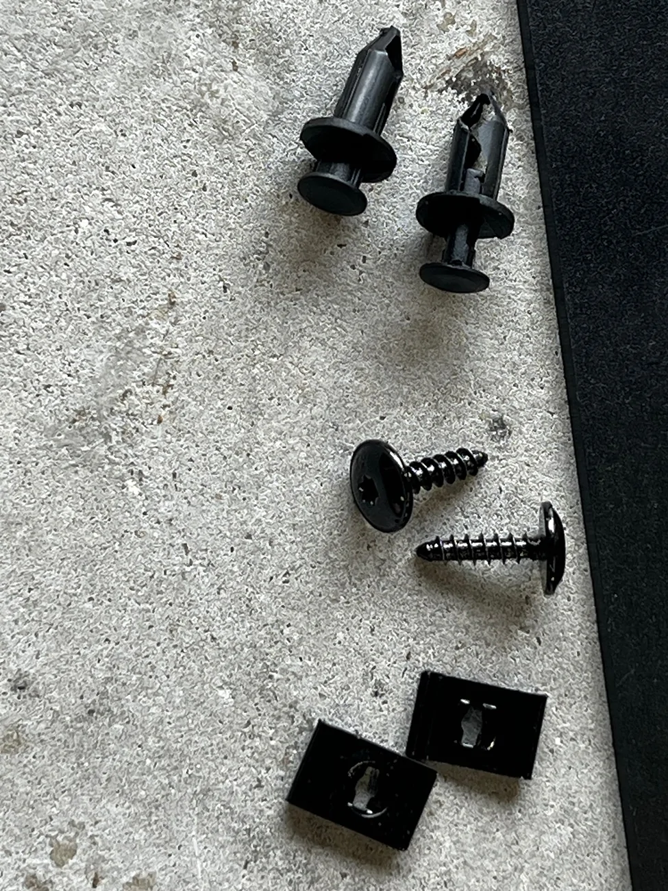

Amazon hardware $20. See pic.
Razor knife to cut the blanks to size.

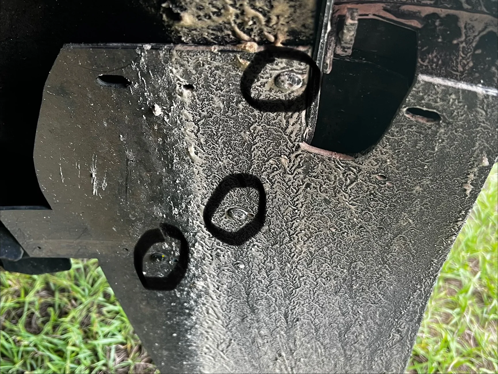

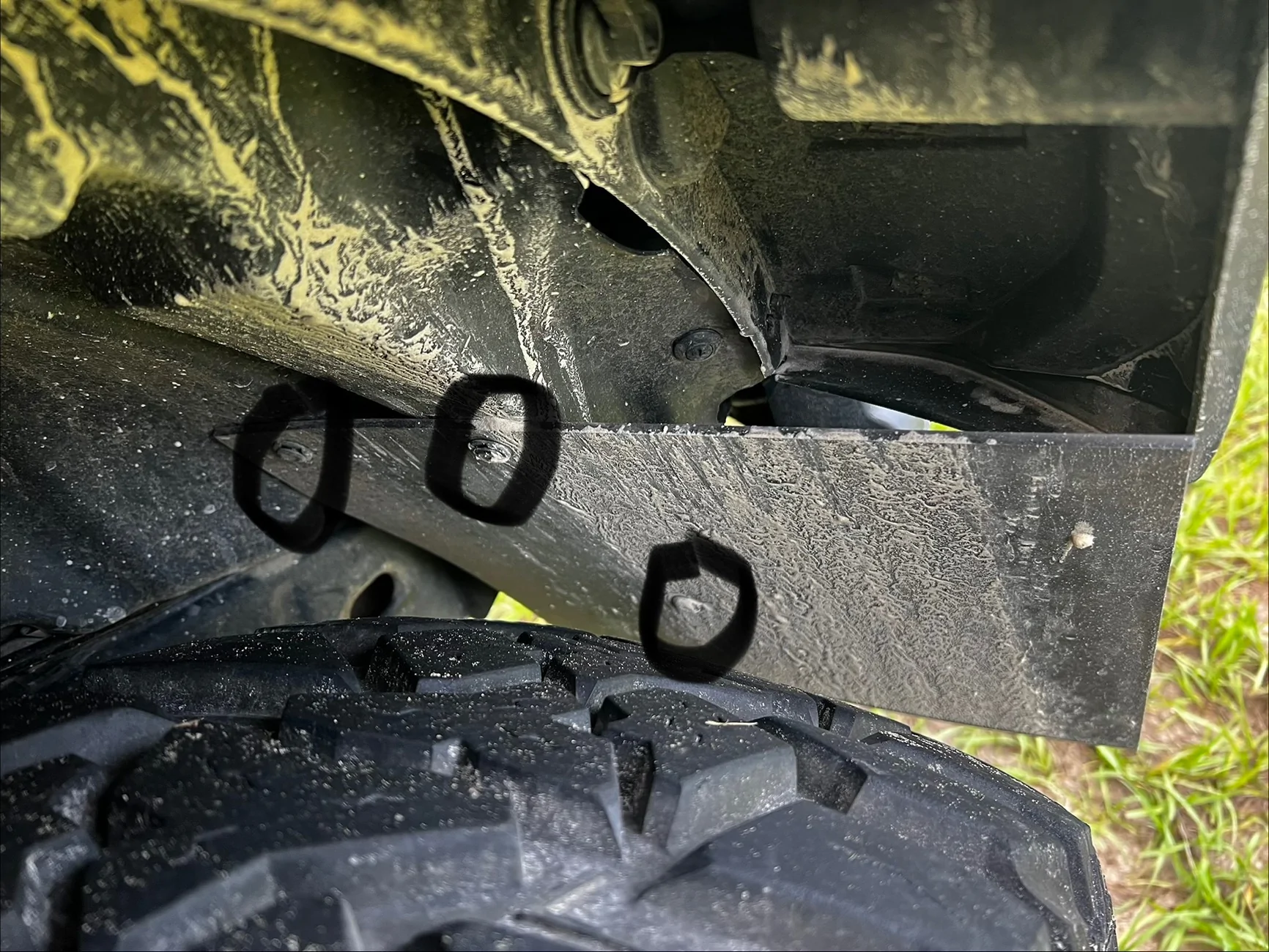

Front wheel mud flap attachment uses factory fender liner push pin holes with your new hardware, no drilling in metal required.
Rear mudflaps drill 3 holes in plastic wheel well lines.
Hardware pics

remove this junk from behold the front fender liner.

Here are the 3 attachments needed it’s that simple.

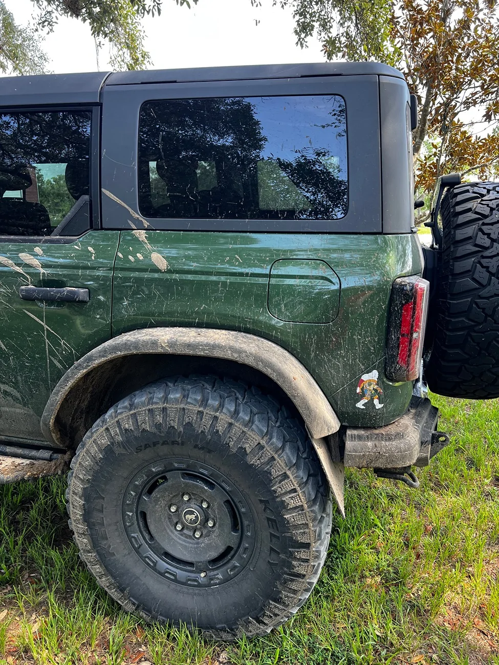

Rear
Ford Bronco Worlds best mud flaps under $80 entire set. IMG_2565

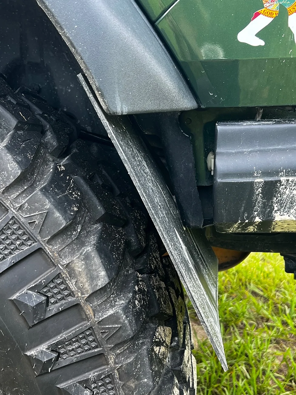

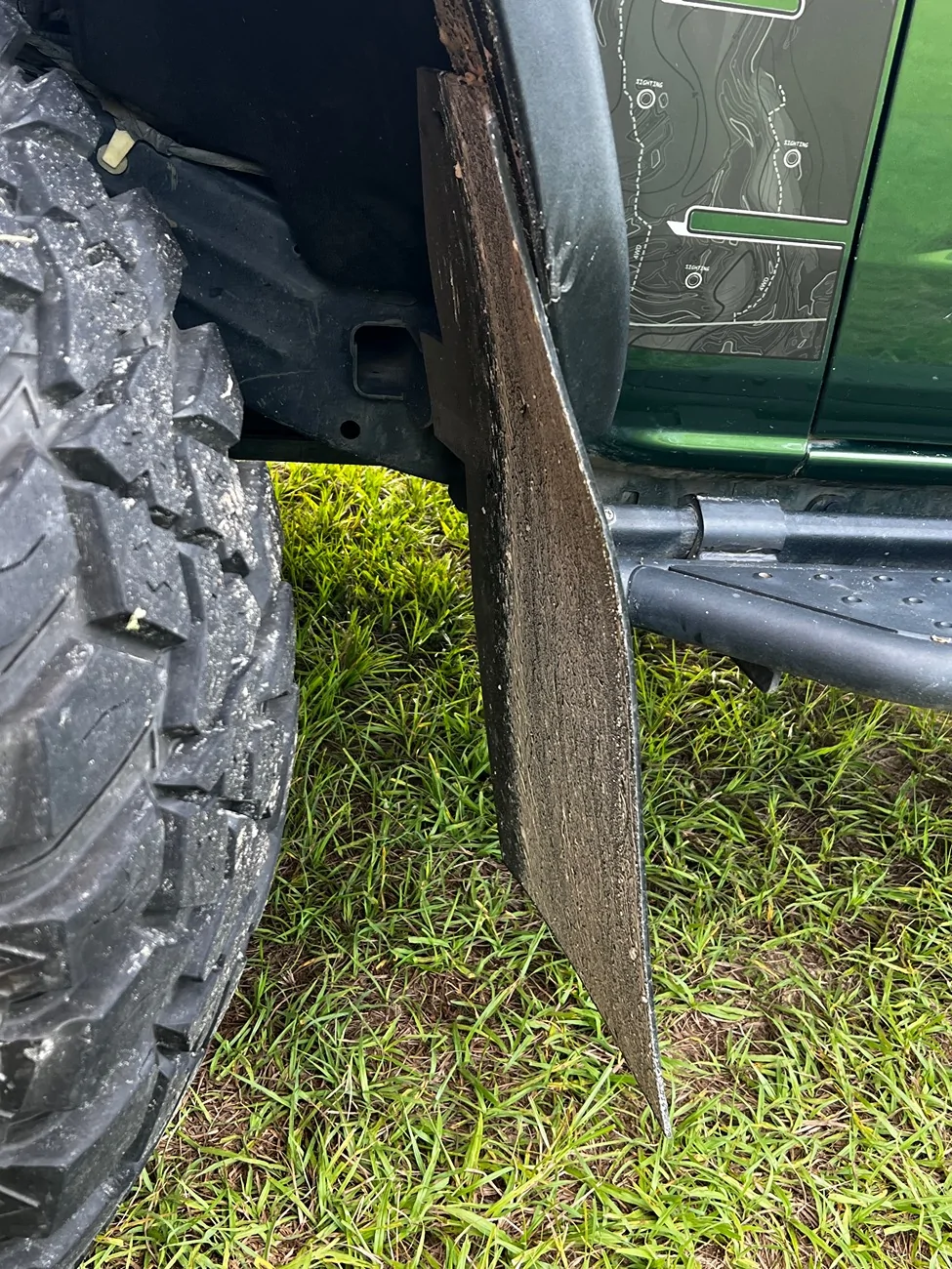

They fit nice and tight, tires do not catch on the material.
And with 3 retainer points each, they are very easy to remove if you for some reason needed to.

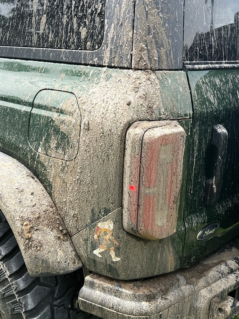

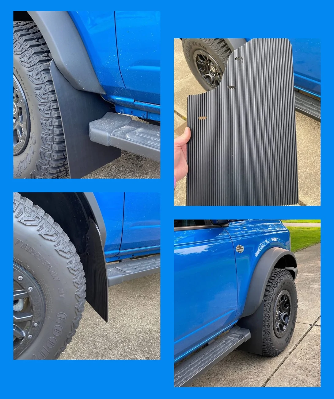

Before and after the rear were added.
Ford Bronco Worlds best mud flaps under $80 entire set. IMG_2544
Ford Bronco Worlds best mud flaps under $80 entire set. IMG_2276
big difference.
The front work amazing also.
