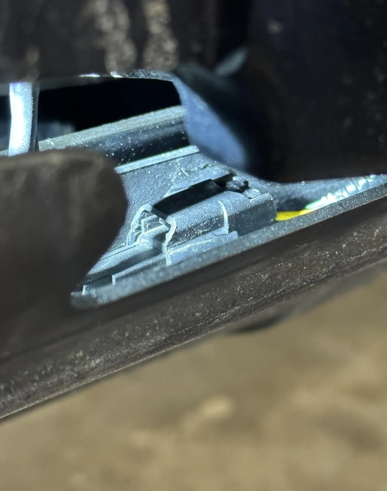

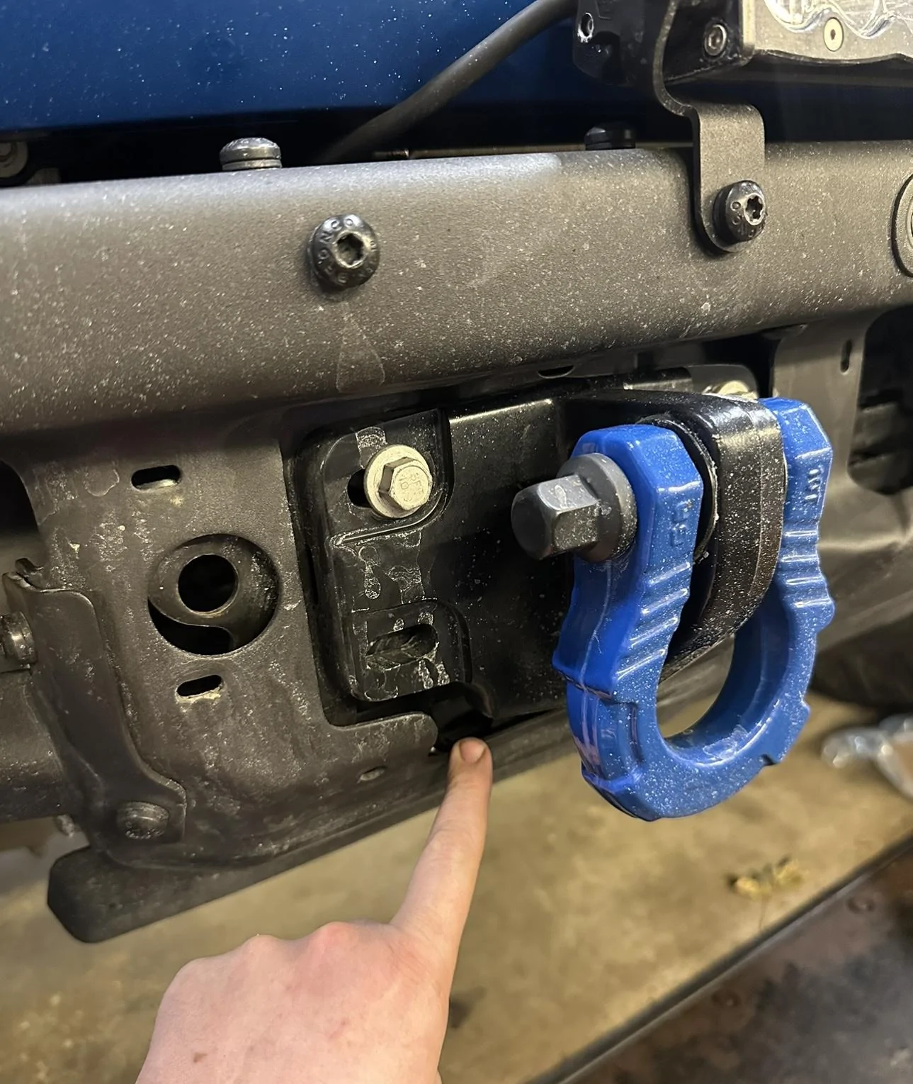

Nob here, but could use some help; can someone be more specific about where "there" is?
My OBX is equipped with the LUX pack and Mod front bumper.
@Ducati1098 when you say "fog light connectors will be there"; where is "there"? physically on the vehicle?
@MNBigfoot what have you seen? " you probably have the harness there "; again, is the physical location of "there" that I am asking.
Thanks in advance for your help and guidance.
