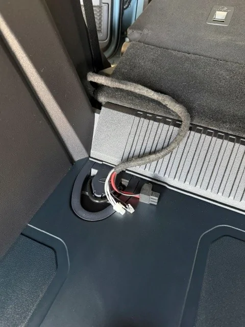

I found this harness behind the drivers side rear seat. Can someone
Ford Bronco WIRE HARNESS QUESTION Bronco Harness
tell me what this pigtail is for?

You're driving with that unplugged!!!???
Some folks just like living on the edge.

Looks like for a kicker key or some other type of subwoofer/amp system.
This guy hit it on the head, first try! Certainly an amp connection. Given the wire sizes and connectors, this is for a low power 2ch amp and may have been a cheap powered sub with a built-in amp.

Relatively low power device, given the wire gauge.

Like others have said, probably a sub/amp combo. The phone plug (rj11) connector is for the gain dial. If you look under the hood is there an extra/aftermarket looking power wire connected to the positive battery terminal with a big fuse inline?
