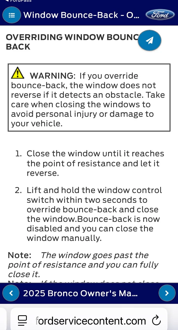

Any resolution to this?
There is an override procedure in the manual for bounce back. Not sure if it only works once or disables the feature until a restart. If it lasts beyond the one time, it might allow you to get through the full reset process afterwards.
Ford Bronco Window reset weekly… IMG_3301
Thanks, I'll try it.
