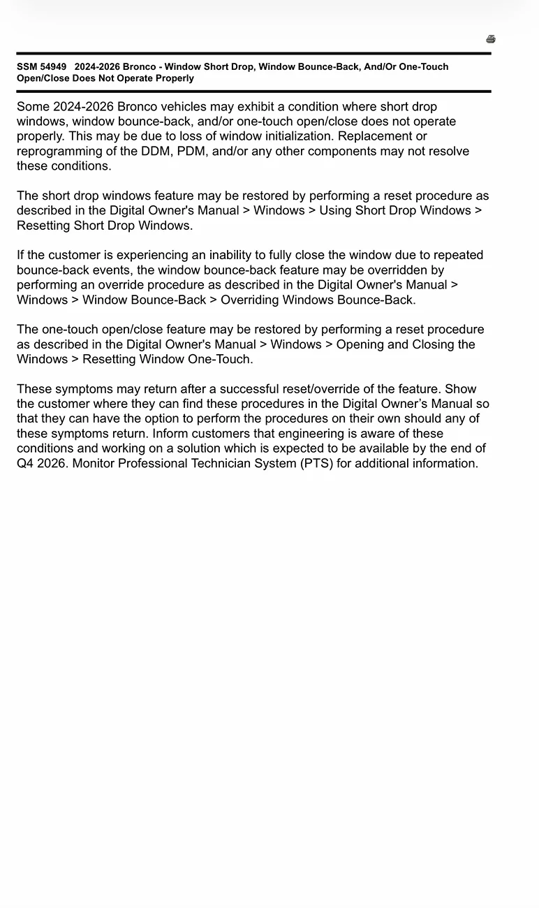

25 BB passenger side window will go down with auto down. Does not go up w/auto up will go up manually but when it hit top shoot back down until 3 inches or so of the window is still showing. Tried the 5 second reset thing but doesn't work.
Called Ford Dealership was told Ford knows of the issue but do not have a fix????????

Here you go:
  • Step 1: With your Bronco running and all doors closed, press and hold the window switch down until the affected window is fully open. Continue holding the switch for 5 additional seconds after the window stops moving.
  • Step 2: Lift and hold the window switch up until the window fully closes. Continue holding the switch for 5 additional seconds after it reaches the top.
  • Step 3: Repeat both cycles one more time within the 30-second window. The automatic power window function should resume normal operation.
MFM01
Mar 13, 2024
2024 Bronco
Here you go:
Thank you! That worked!
