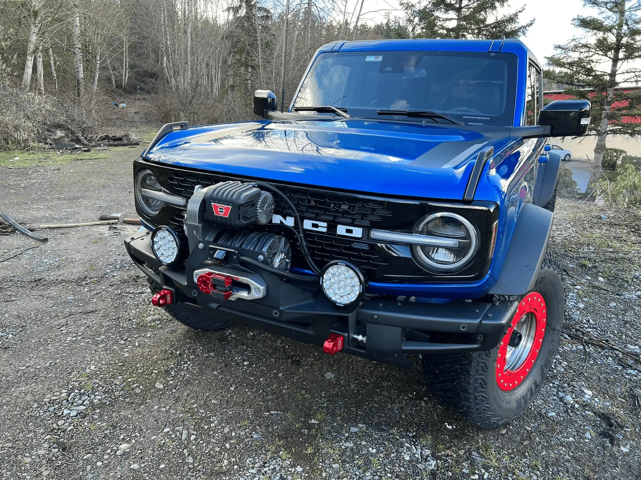

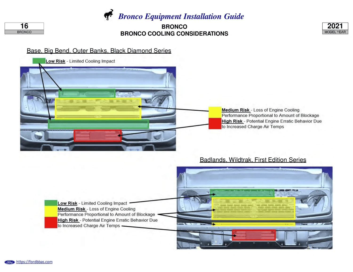

I have seen 225-230 highest going over mountain passes with both my unmodified FE and Badlands. I have not see any difference crawling with my winch which is a good portion of the yellow zone, but it really doesn't block that much if you take a close look

I was on a trail yesterday slow speed not really working all that hard, less than 40 degree air temps ,oil and trans temp hovered around 215, as they usually do. I'm assuming normal. I just wouldn't block the intercooler (red zone in post above), though that would be the best spot otherwise. FYI I have te RC hidden mount.
