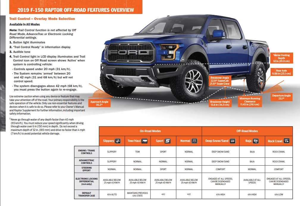

are you sure Sport mode (f150) is 4 high? I don't think it is
That's on the previous gen Raptor. I watched a walkaround video of a new 2021 F150 and when it was put into Sport mode it automatically shifted to 4 high.
Possibly 4A but not 4H. Sport mode is meant for the road, 4H is not. My Raptor going to Sport does not engage 4wd at all. Now you can engage both 4A or 4H while in Sport but it does not do it automatically.
So with power being sent to the front and the back, but both being an open diff...why can't you use 4H?
I had fulltime 4x4 on my XJ so as long as the center transfer case allows for slippage between front and rear axles, 4H is totally doable.
4H locks the transfer case. You are fine in a straight line but don't try to turn on pavement. Your frontend will bind and you will break things. 4A the transfer case has a clutch pack that allows slip. No problem running on dry pavement. AWD and 4WD are completely different systems.
