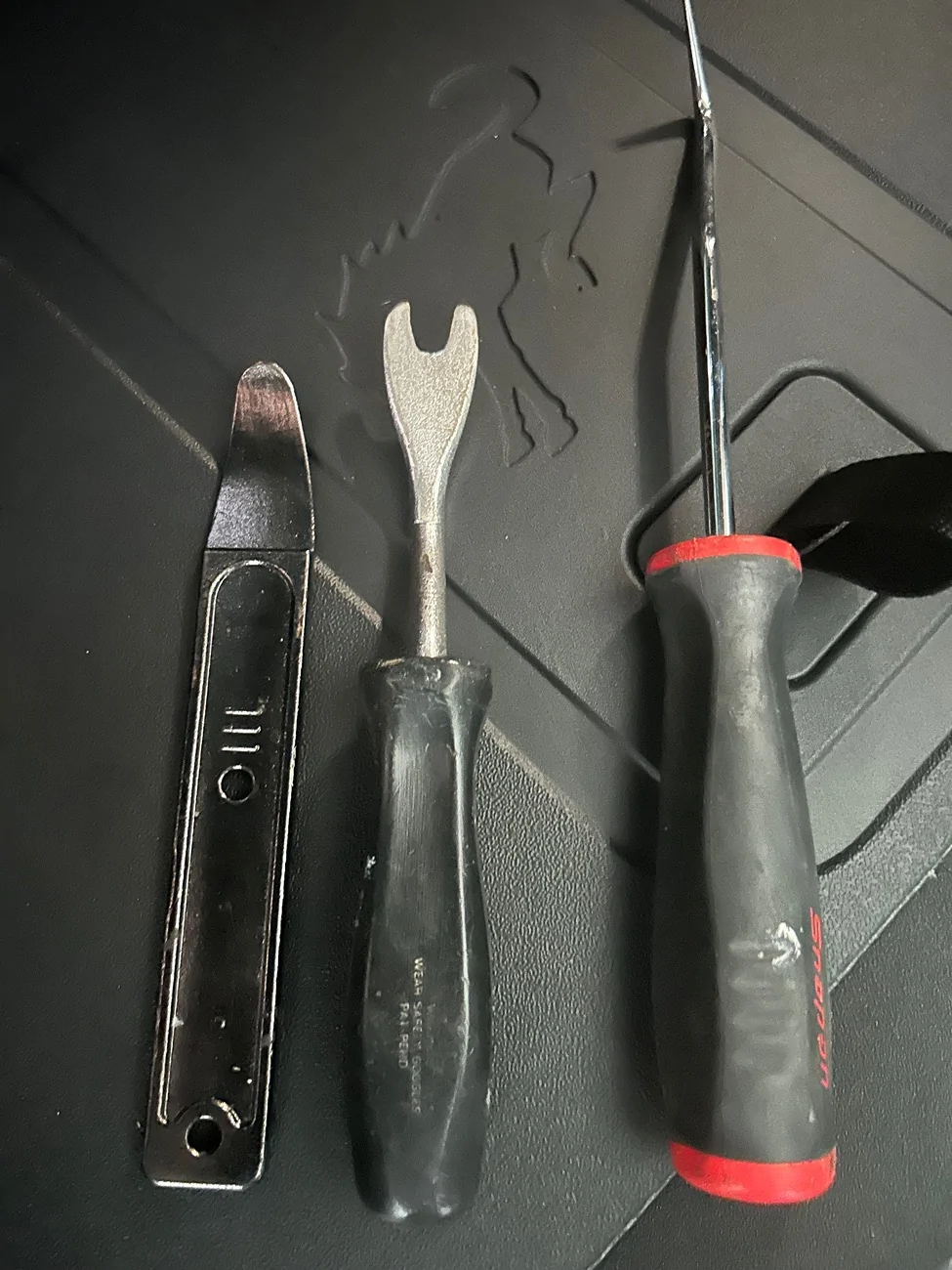

2gallon bucket/lid, garbage bag &TP. Acts as emergency commode and tool storage. Go in around and under Bronco finding what size bolts and small fasteners. Wrenches and assorted socket drivers, extensions for the sockets and bits. Carry only those that fit as others have said. No sets. Quality pliers. Slip and locking. Small assortment of panel removal and hook tools. I prefer those in pic. Knife. Wire ties, tape, super glue fuses. Light. Tire repair, pump and jump pack(many have light). Belt. Small Digital MM.
