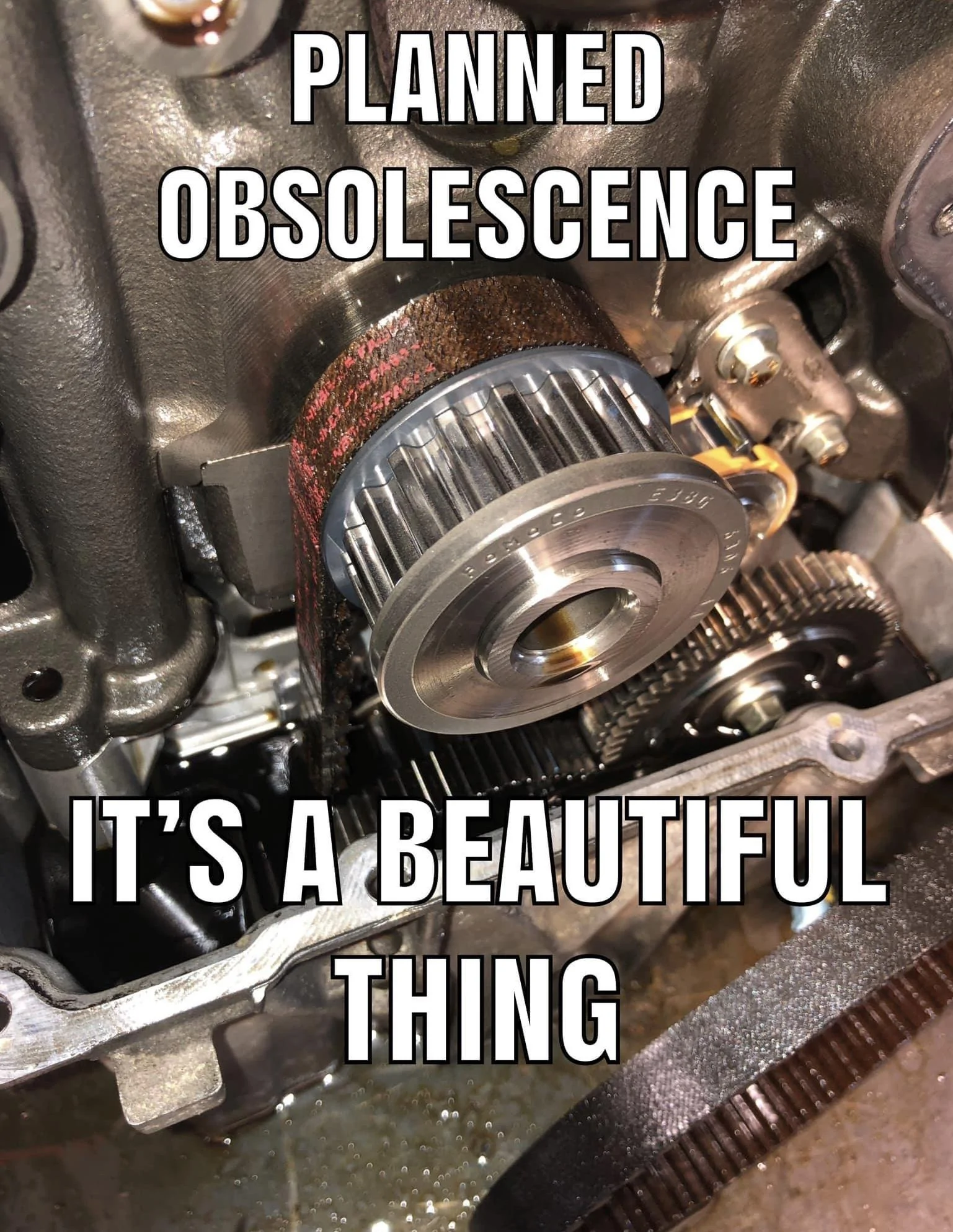

The 2.7 has a wet belt driven oil pump. Yes, that belt is bathed in the same hot nasty acidic engine oil that only gets changed every 10,000 miles or whatever horrible intervals they recommend. People like to argue with me and say it’s not a problem on their 2 year old f150 blah blah. Well ask the unfortunate economy car ford owners that have had this design a little longer what caused their engine to blow a week or a year after the warranty expired at 100,000 miles or less…
Most of the non-enthusiast engines-small car engines and v6s have had this junk put on them and even the 2021-up 5.0 now but luckily the 2.3 is still the badass focus RS style block with decently big turbo solid bottom end and a gear driven oil pump. Guess which one I ordered 😆 also the 10r60 automatic transmission is prone to have issues and the fix is just to swap em out or rebuild it the same way no updates, you can google that
