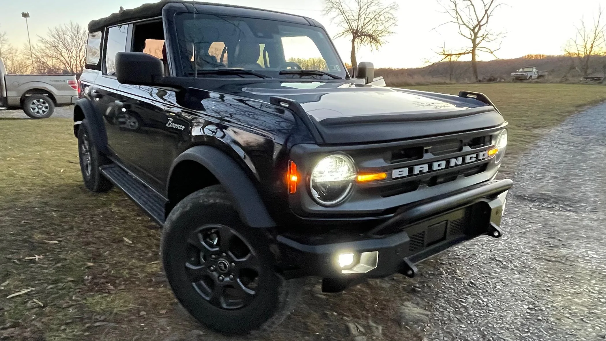

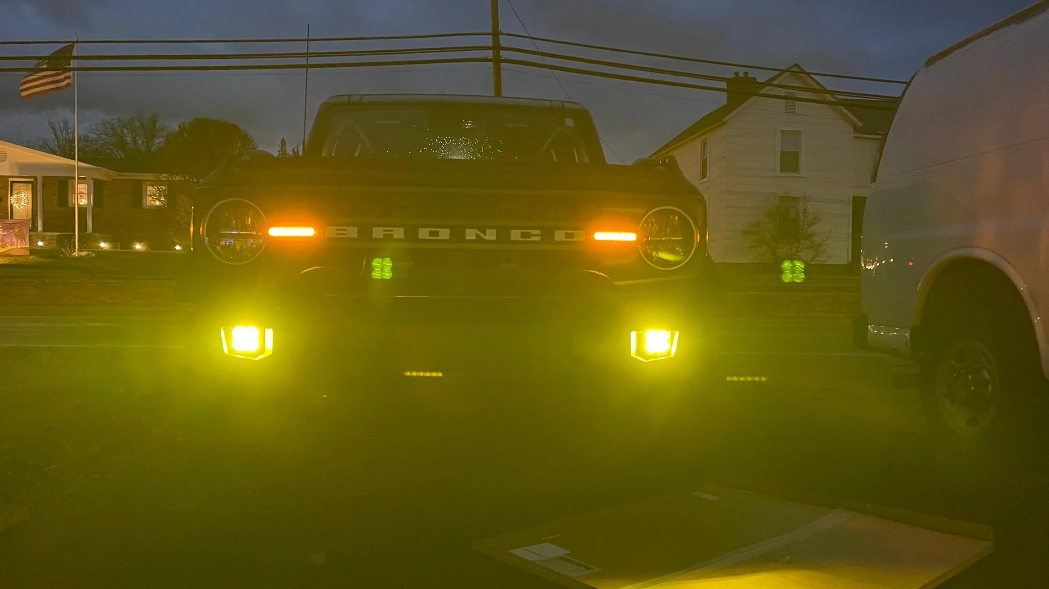

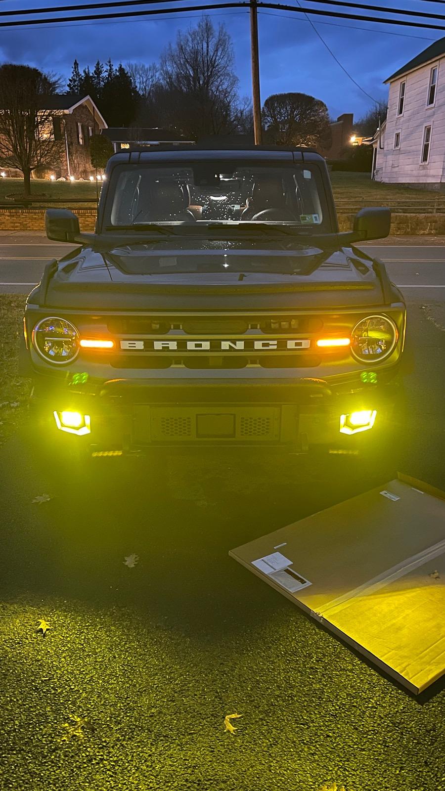

I went with the DD SS3s in Sport shortly after installing Body Armor’s front steel bumper and am very satisfied with the the light out as well as the wide angle beam. If you already have the oem fog light wiring, 4x4truckleds makes installation a breeze with their harnesses. I went with the white w amber backlight, but ended up getting the yellow covers from DD and it’s still plenty of light and helps immensely with side visibility on backroads.

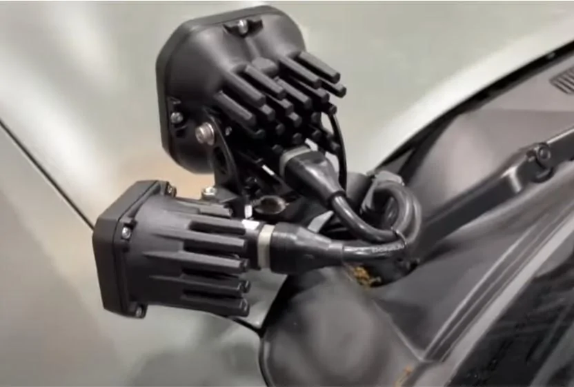

Surprised to learn that the molded connector is the default choice. I am sorry, but this is plain fugly

No different then having a pigtail off the light... Also that's not our harness. That's a splitter cable which is why it's so beefy.

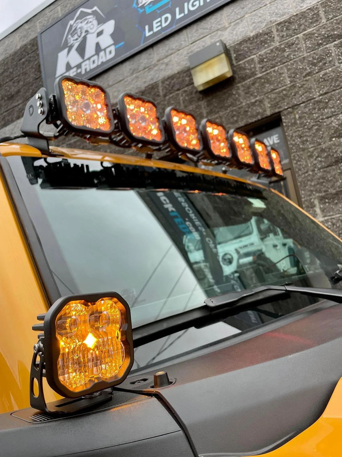

Can't even see the wire on this SS5. Granted it's from the front but still...
Not havnig a pigtail on the back makes for an easier installation. I'm a big Baja Designs dealer and fan but sometimes that pitail gets annoying and in the way. The connection is usually burried somewhere under the cowl that can be tricky to get to. And with the fog lights it's extra wiring we have to hide. Compared to just plugging the harness right into the light.
It allows the end-user to have a harness that is the perfect length and doesn't have extra connection points as well.

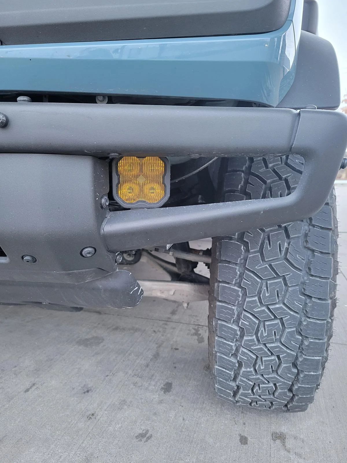

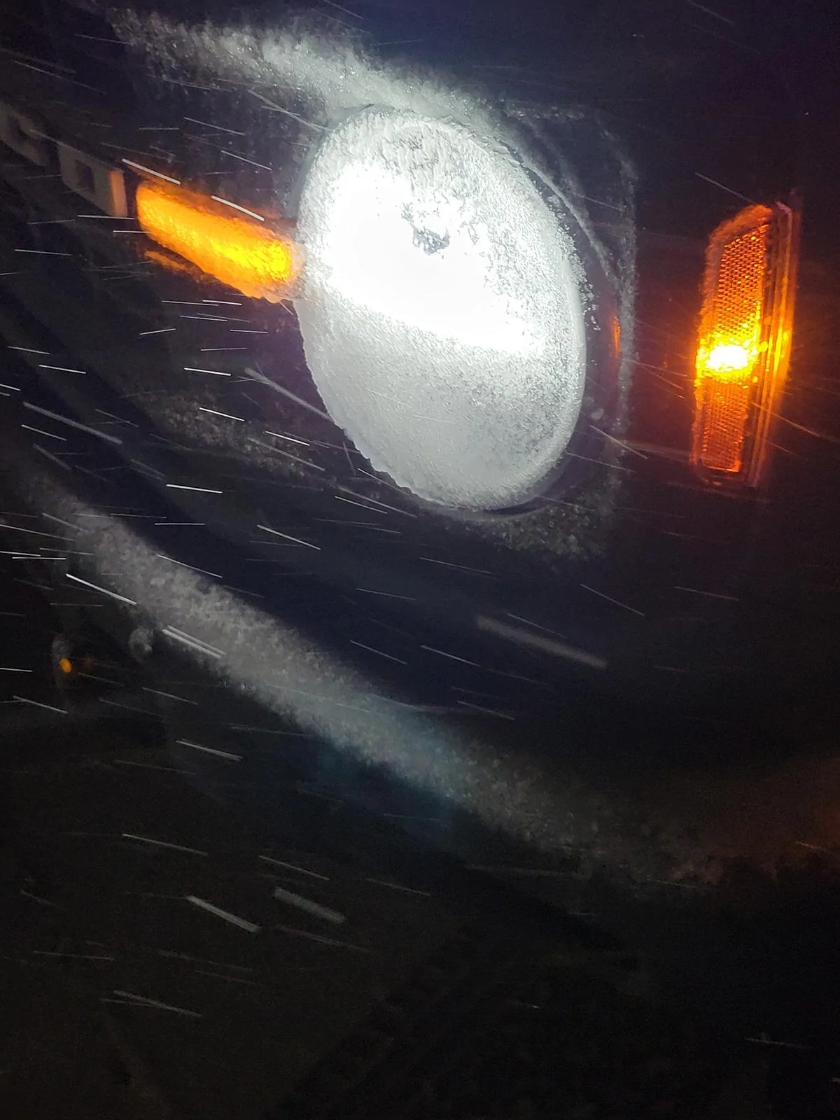

I went with the pro version, and have been extremely happy with them. But honestly if I did it over again I would probably just go with the sport instead. I feel like the sport would still have been more than adequate for my purpose, which is aimed down and slightly to the sides to aid in cornering at night. The sport has a slightly more crisp pattern cutoff, as the shear intensity of the pro's light output "overwhelms" the light patterning a bit.
Anyway, the lights are awesome and routinely save me in the winter as they run hot enough to keep the lense free of snow. The factory headlight easily get caked with snow and becone virtually useless, while there won't be a speck snow on the DD lights.

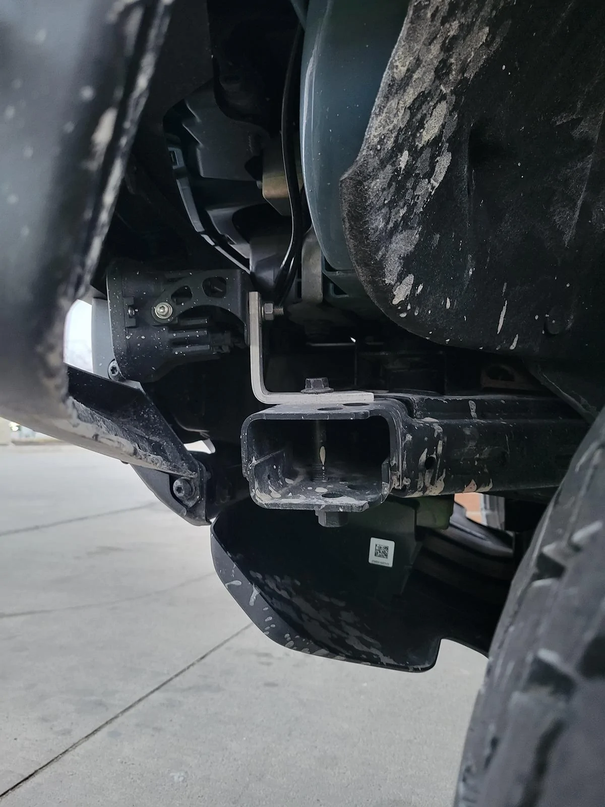

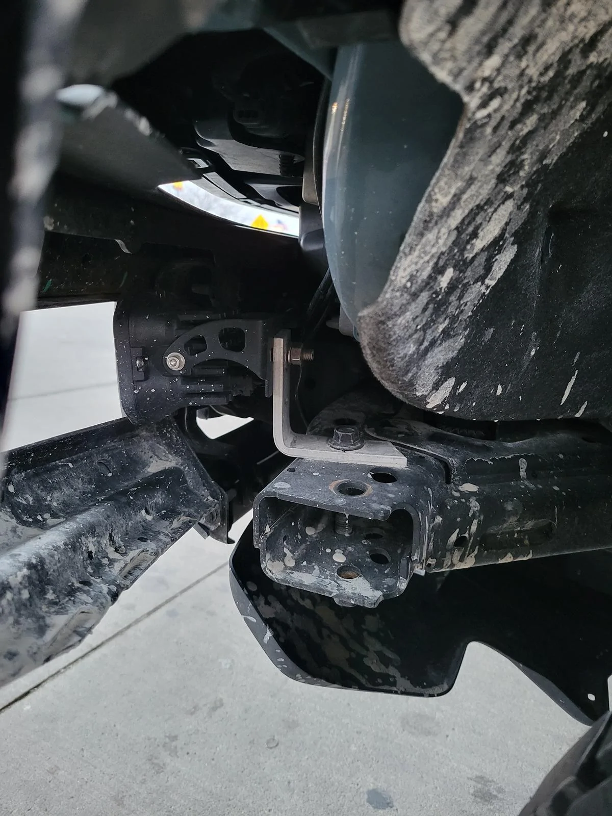

I made simple brackets for mine out of a piece of aluminum bar. They bolt right to the frame.

Yes the pros run hotter and can melt snow. I don't think the Sports do.
Great DYI solution with the aluminum brackets, they look like 3" arms about 1/4" thick, do you have a good source for these or did you also cut them to length and width for an angle bar? Perhaps something like this

I just used some aluminum bar stock that I found laying around, and bent it 90°.
Something like this, https://www.amazon.com/Evecad-Alumi...rds=aluminum+bar+stock&qid=1718694093&sr=8-11
