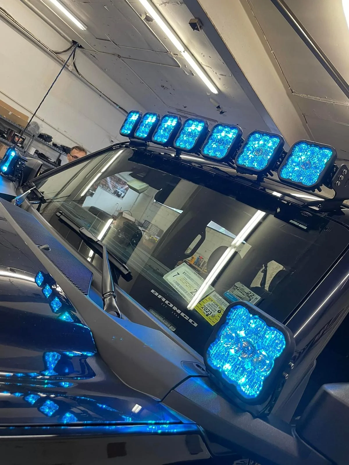

I've got a set of DD SS3 Pro combos mounted next to the mirrors. I think the lights are great, mucho brighter than my headlights.
That mounting location throws waaaayyyyyy too much light on the hood, which is true with any brand of light, so I've got mine pointed as far to the side as I can stand without losing too much forward lighting.
I normally only use them (1) for low speed operations, and (2) with no oncoming traffic, so that (1) the light reflected from the hood is not too distracting, and (2) so I don't go to jail.
I just ordered two DD SS3 pro spots to mount over the windshield, since I don't want no steengkeeng giant light bar up there, and so I can aim a couple of spots exactly where I want.
