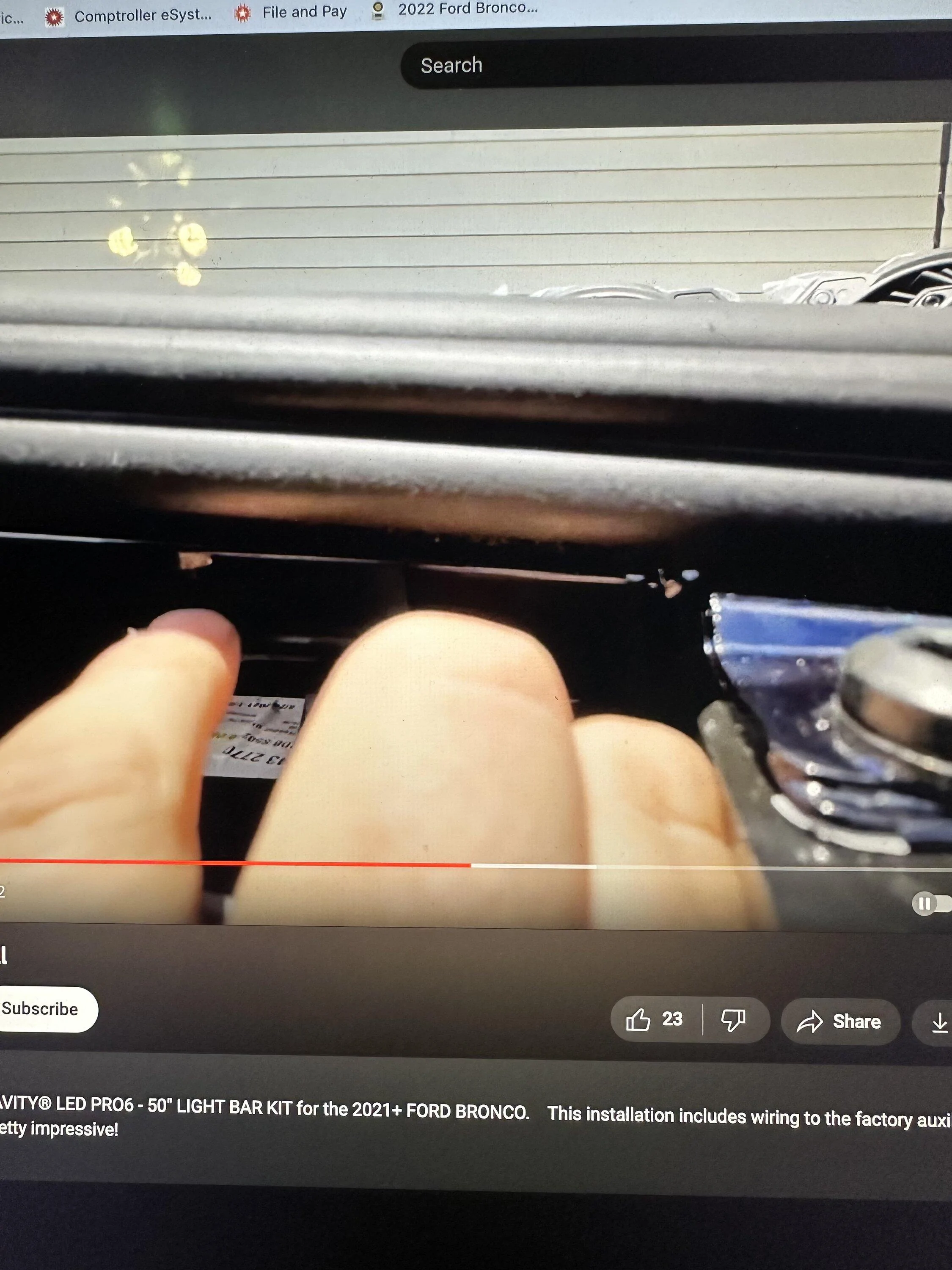

Anyone found a good one in the area near the passenger visor, where the pre-run aux switch wire is? I'm not going to do a light bar so figured I'd use that to hard wire my dash cams. I haven't fully torn it apart yet, just removed the visor and I don't really see any good grounding spots. I need to find out how to remove the switches and plastic trim around that area and look for one there.
