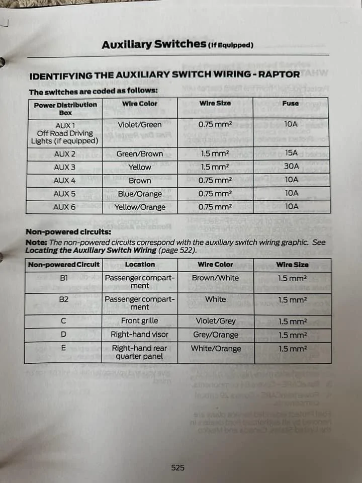

On the driver side firewall. Same as all other broncos with factory switches. The amp rating is different on the Braptor though.
Here is a pic of the coloring/amps for the Braptor.

^^ thank you......

Ahh. I wondered why they put the factory off-road lights on Aux 1
Makes more sense now
