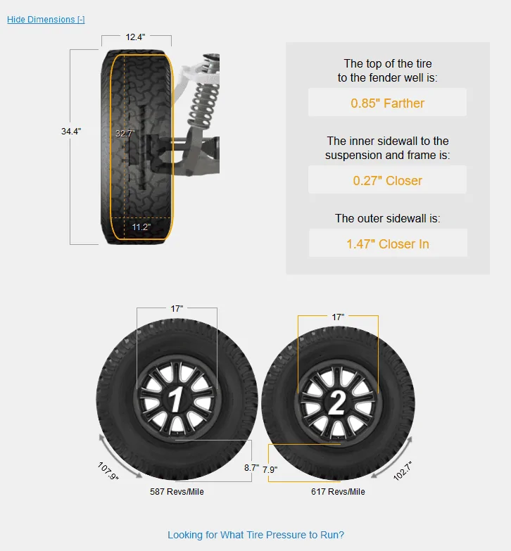

So the +55 on the Badlands 33" setup is .27" closer to the suspension than the Sasquatch. Just need a number off the Steelies and one off the OBX and we should know just about all we need too.
This graphic is slick. I assume it is available if I poke around on tiresize
