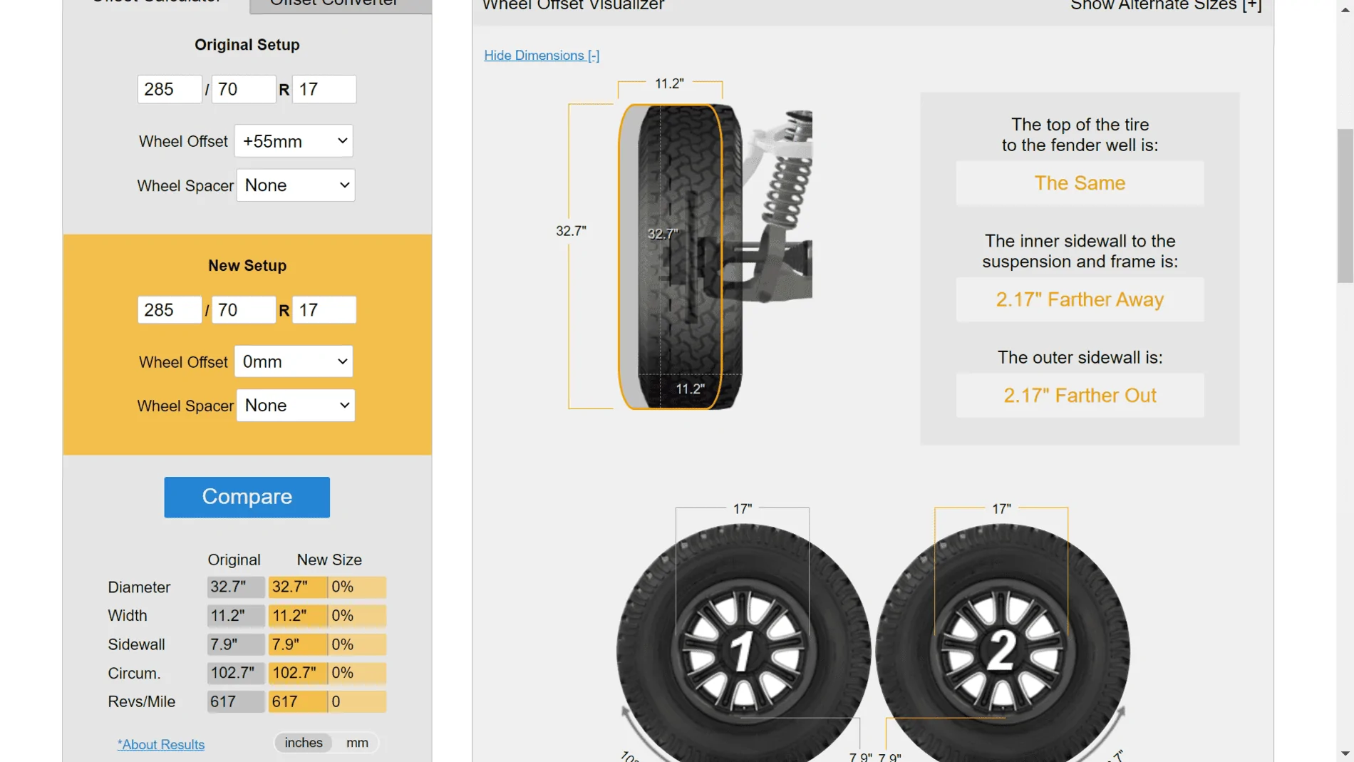

Here is what I have for backspacing , per tiresize.com offset calculator. I strongly suggest playing around with their offset comparison app. With that visualization, you'll see tire width and offset will show you all you want to know.
16 x 7 = 55mm offset = 6.17" Backspace (Base)
17&18 x 7.5 = 55mm = 6.42" backspace (BB, BD & OBX)
17 x 8 = 55mm offset = 6.67" backspace (Badlands)
17 x 8.5 = 30mm off = 5.93" backspace (Squatch)
This is what an 8" wide wheel with 0 offset (4.5"bs) looks like compared to a Badlands 33 wheel and tire. Same tire in both models.
They are saying you will have 2.17" of extra poke per side. That's about .85 MORE than the Squatch, which already requires those wide-assed flares.
So, compared to Squatch, it isn't much, compared to standard Badlands, it's A lot.
With an 8.5" wheel, it grows to 2.4" more than the standard BL.
9" = 2.68"

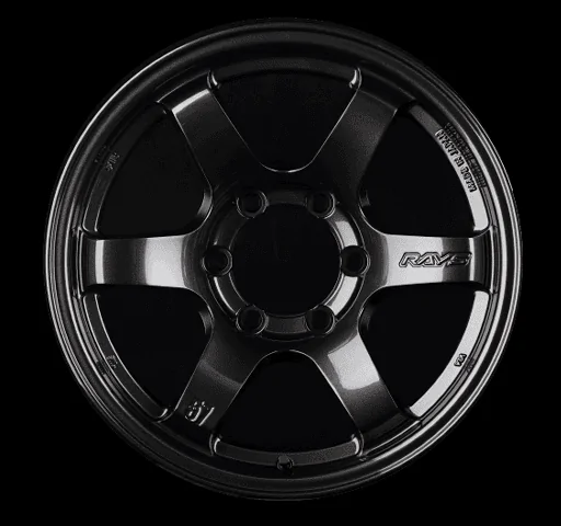

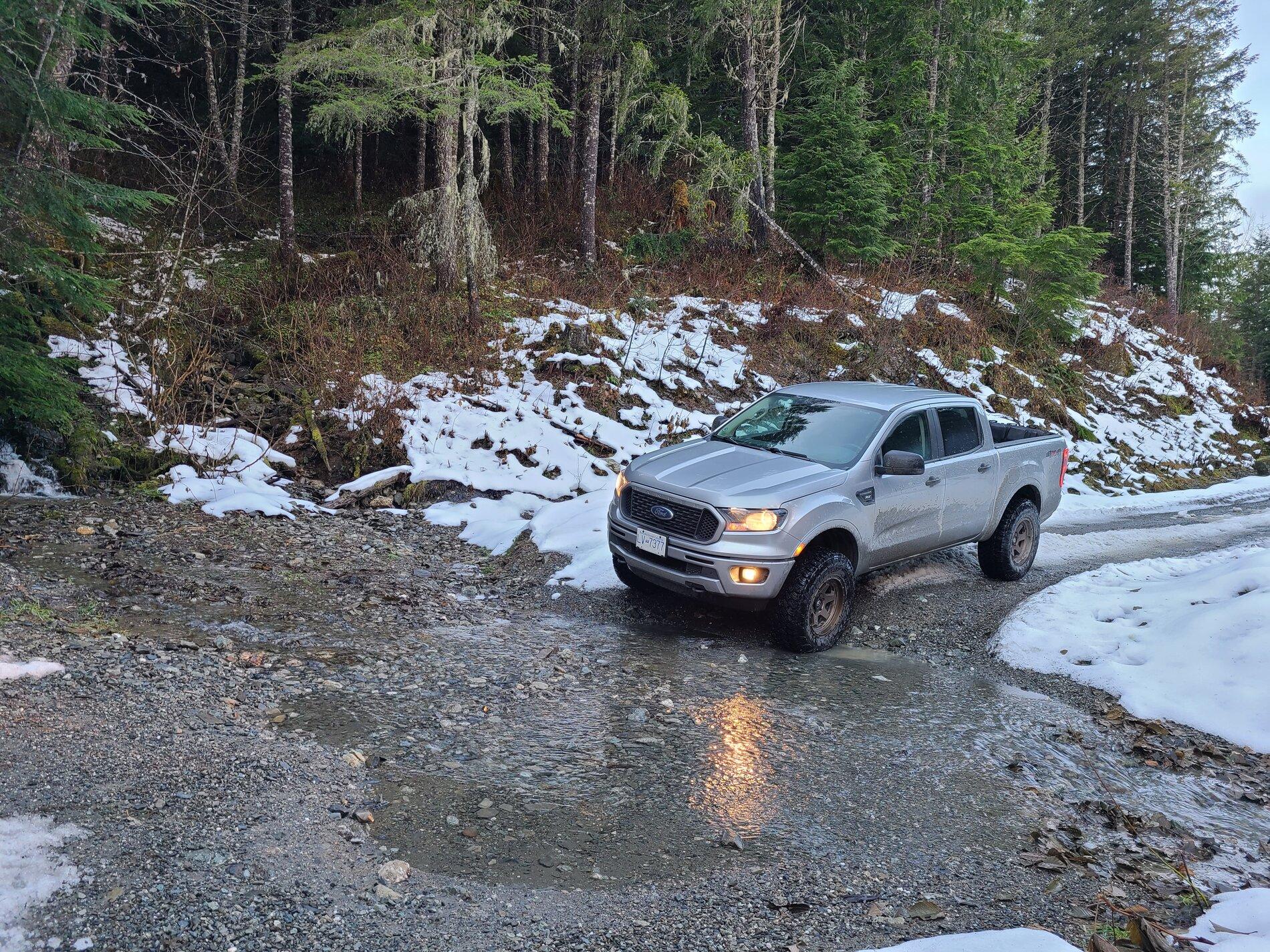

I have these on my Ranger... They will be making it to the Bronco. 17x9. 6x139.7 102 bore, zero offset with 285/70/17 (33's) Toyo Open Country CT. Zero problems other than people stopping me in parking lots and lights asking to many questions about it. Lol

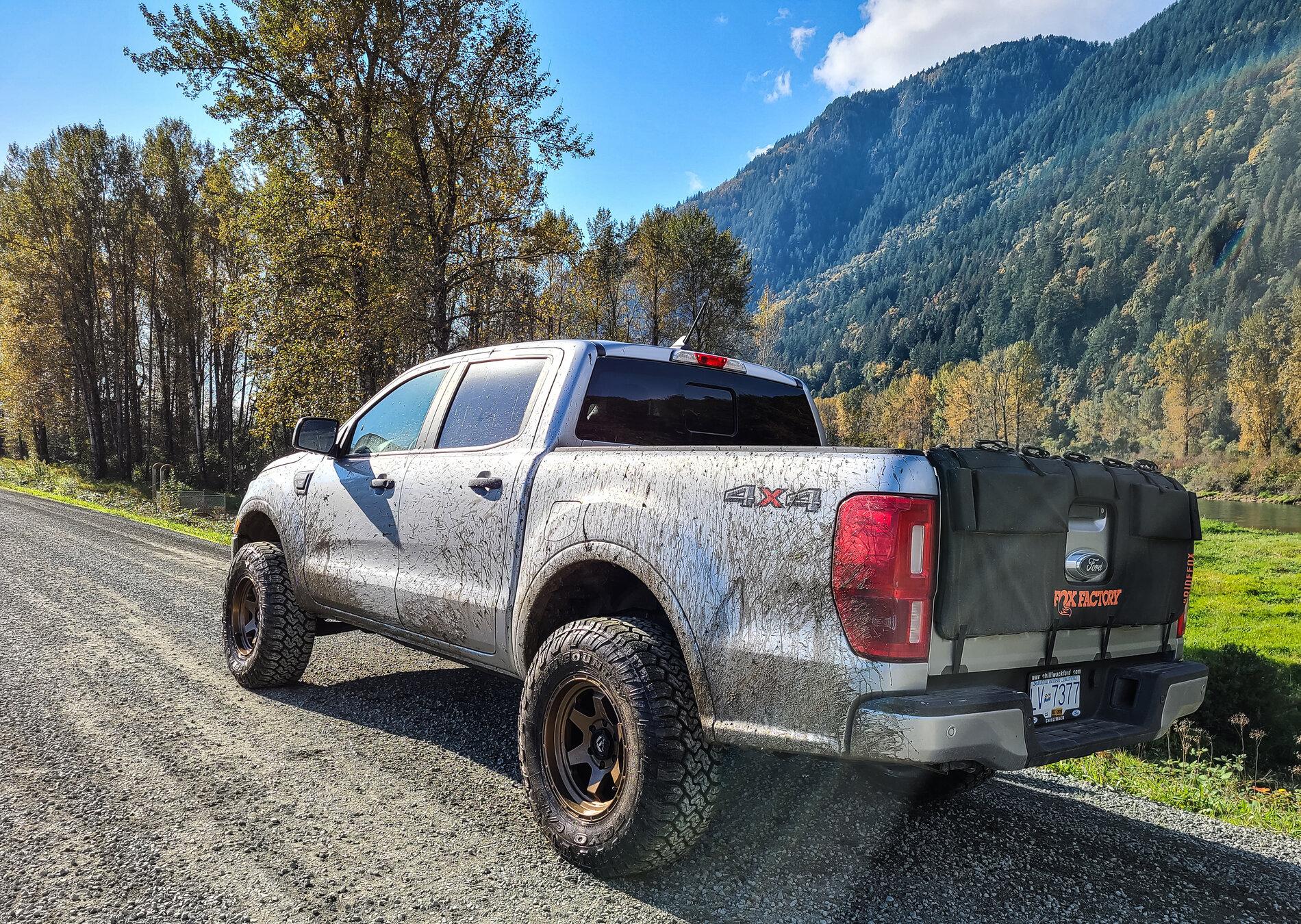

Well there's 2" of poke on the ranger and I've had zero issues. Now the bronco has fender flares... And as seen in the photo below there is still room under the flare on the squatch... Leading me to believe that a zero offset wheel will only come about flush with the fender with 33's.. maybe 1/2" poke with 35's... Then again I'm sure there be slightly wider flare options as well.
BTW, the Ranger looks sweet!
You're right. The Overland concept had zero offset wheels with 35's and only a small amount of poke. Calculator says 1.18"
