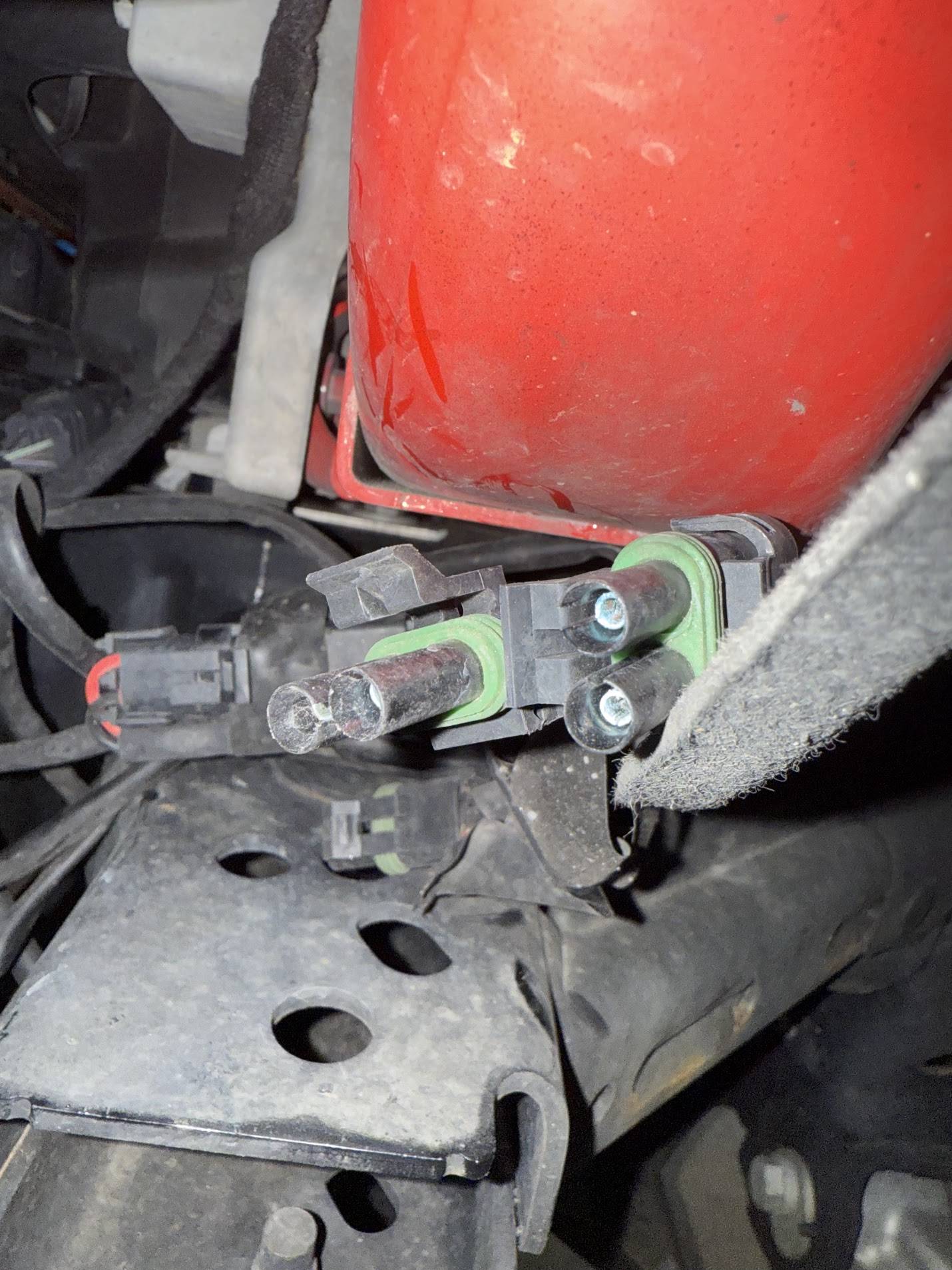

I just bought a used 2022 4 door Wiltrak. One of the previous owners had lights somewhere. I have a harness with these plugs. I was wondering if anyone know what brand of lights fit this plug.

Are there 3 plugs per side? Could have been from one of our fog kits. That's a weatherpack connector, used on Baja Designs lights.
Chances are there is a 3rd one in there (3 per side) which would indicate it was part of our triple fog light kit.
If that's the case and you order a new kit from us, let me know as soon as you place the order so that I can refund you some $$ and we won't ship you a harness since you have one.
You should also check the upfitter bundle against the firewal (driver side) and look for connections. Take a photo as I can identify if it's our harness from that photo also
https://www.4x4truckleds.com/vehicle-specific/ford-bronco/2021-bronco/fog-lights/
Upon closer inspection it DOES appear there are 3. I see one taped up as well in the photo. So it's most likely one of our Baja Designs fog kits.

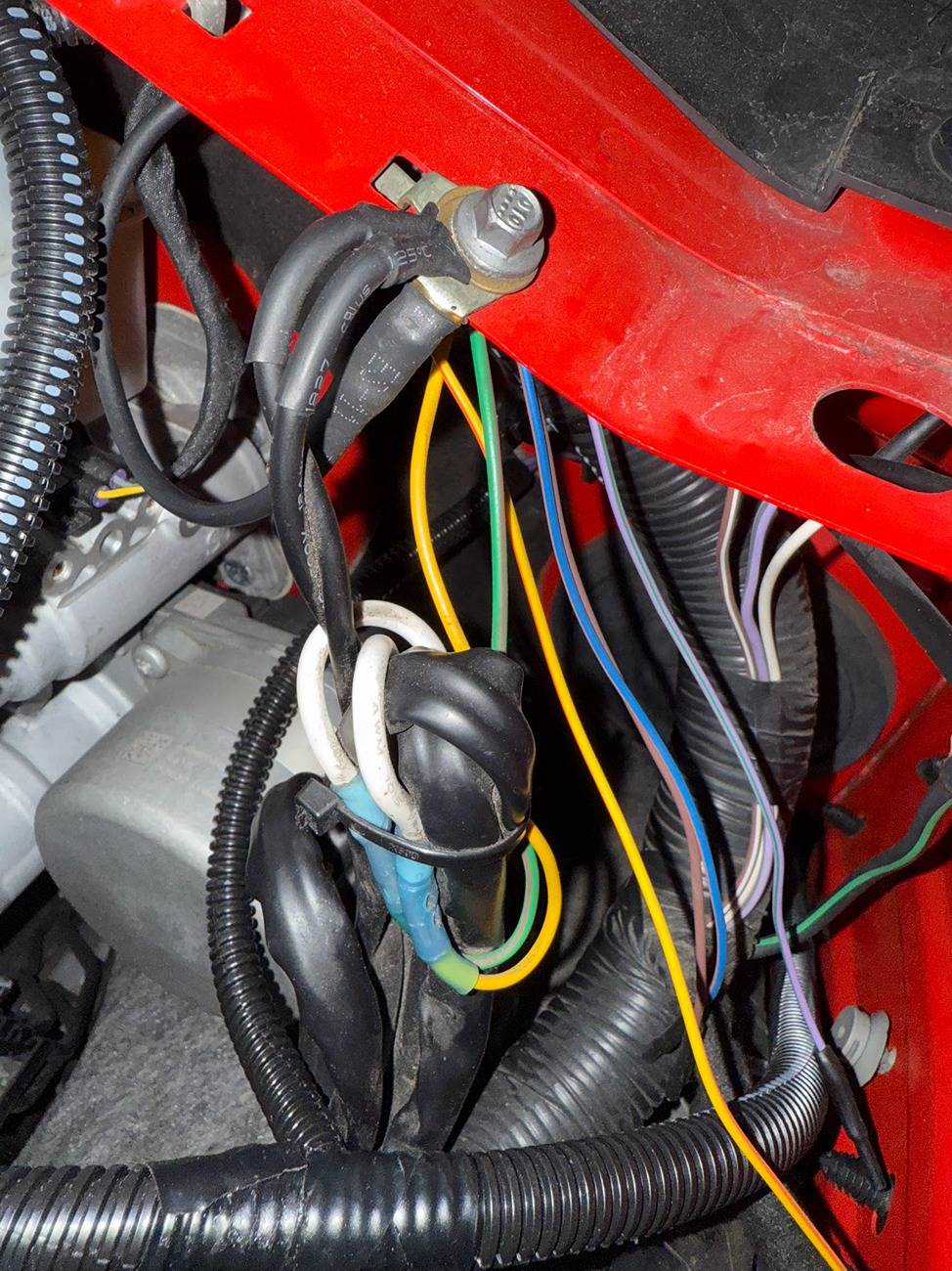

Yep 3 per side so six total. looks like they are wired into Aux 1 and 2, yellow and green with brown stripe.
Thanks so much for the feedback, now I know what to go look at.
Larry
Looks like that is the Baja Designs Fog Pocket Kit basd on that wire harness at the upfitters.
So we don't recommend you use that harness. Basically that's a LOT Of harnesses to do what you need to do (when you get lights). It's 2 splitter harnesses that go to the upfitters and then there are also 2 y-cables as well.
1 upfitter powers 1 pair of lights
1 upfitter powers 2 pairs of lights.
With our harness, which comes with our kits, we put each pair of lights on it's own switch. AND we let you select what lights you want.
The previous owner got the Baja Designs kit which comes as it is, no light selection or harness selection included. Our kit is SLIGHTLY different in that we utilize OUR harness and OUR brackets but let you pick exactly what lights you want. More selection and less $$ with a better harness.
You can still use coupon code BRONCO6G and save 10% on our kit though and still get the great Baja Designs lights: https://www.4x4truckleds.com/vehicle-specific/ford-bronco/2021-bronco/fog-lights/
