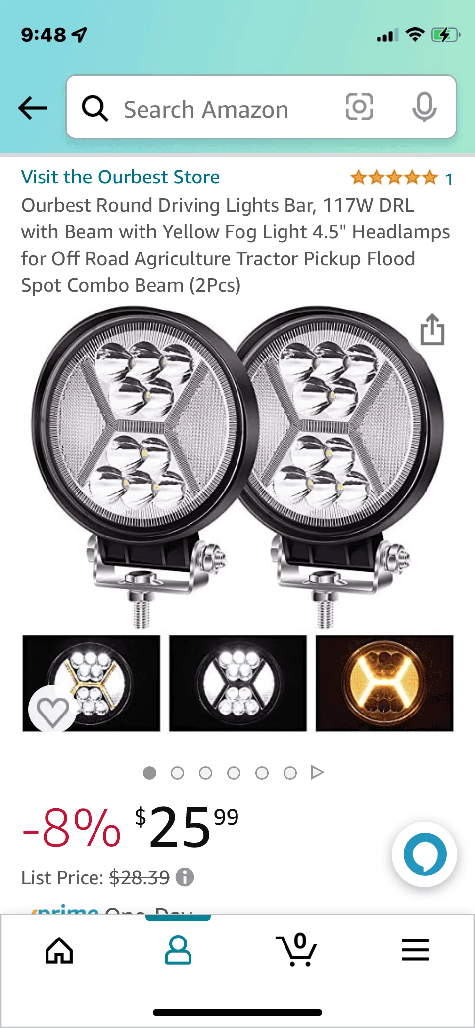

Use the heck out of them but I wouldn’t take up Aux 1. I’d throw a relay under the hood and use one of the lower amperage switches as a trigger. I run $23 Amazon lights with Amber and white. For something you might use 10 hours a year I can’t justify hundred of dollars for a brand name.
You have a link for those? Mine will be more for looks over anything else, don't make any sense to drop major coin on decorations.

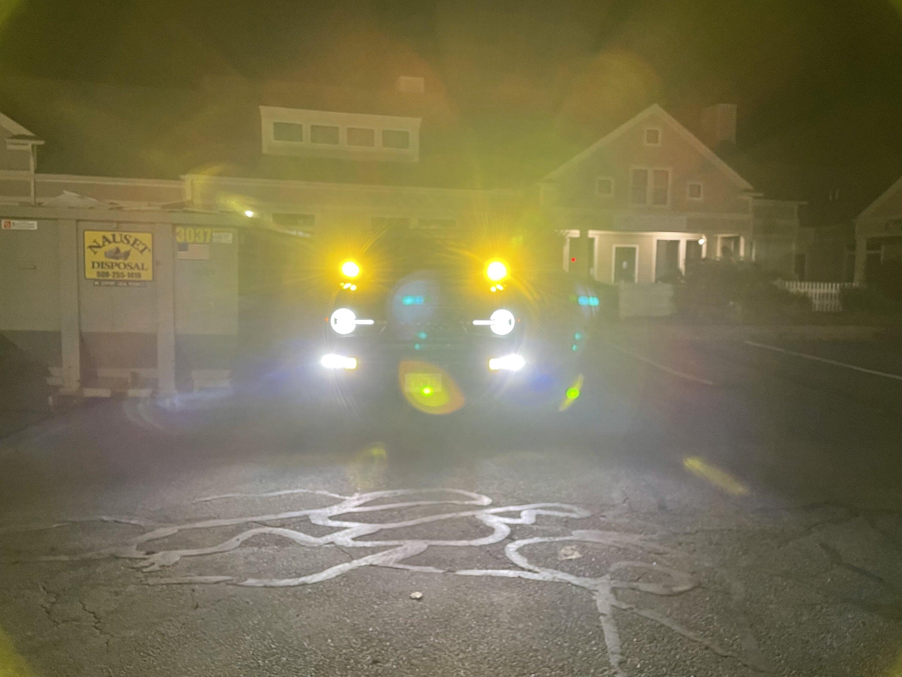

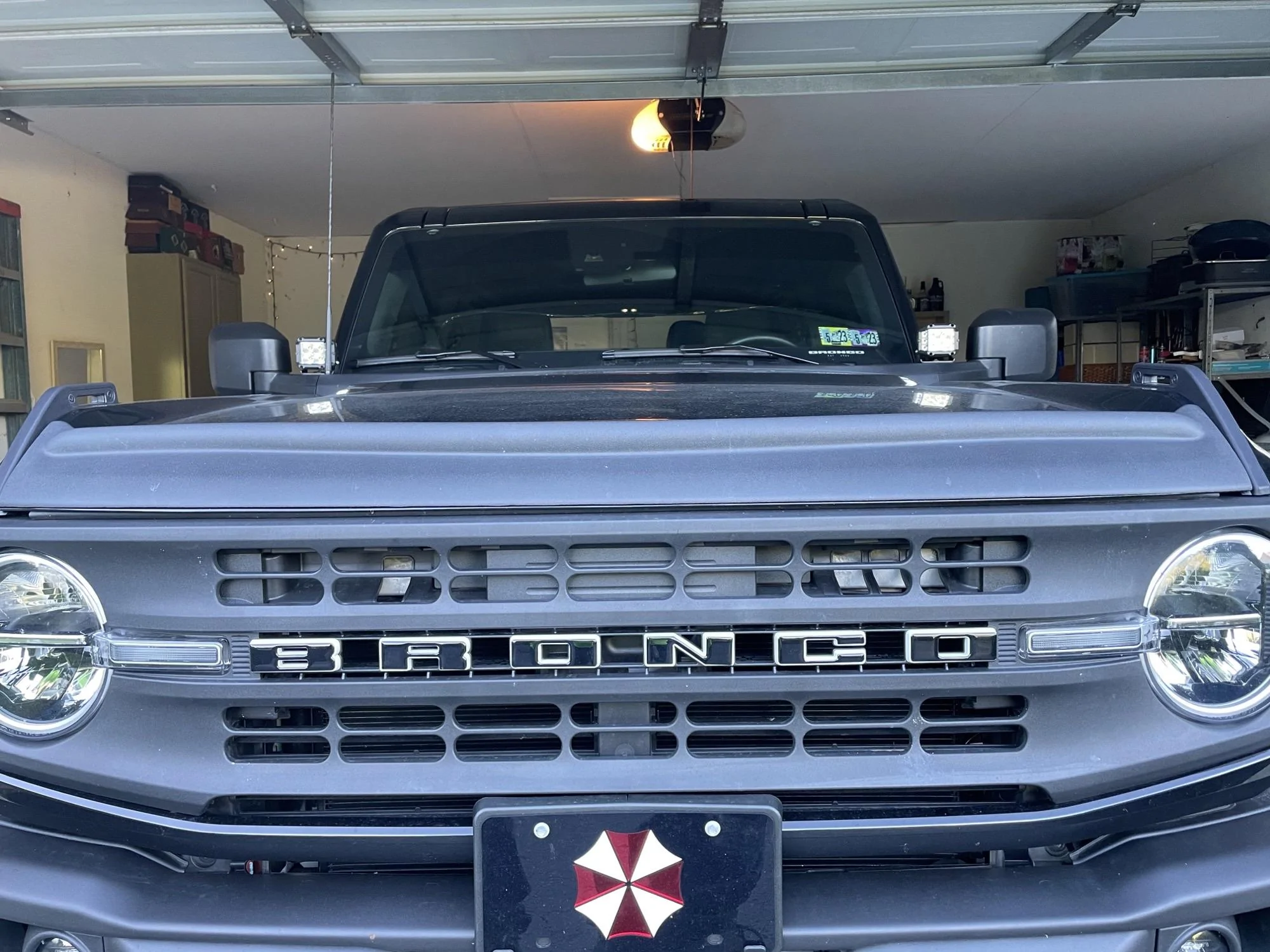

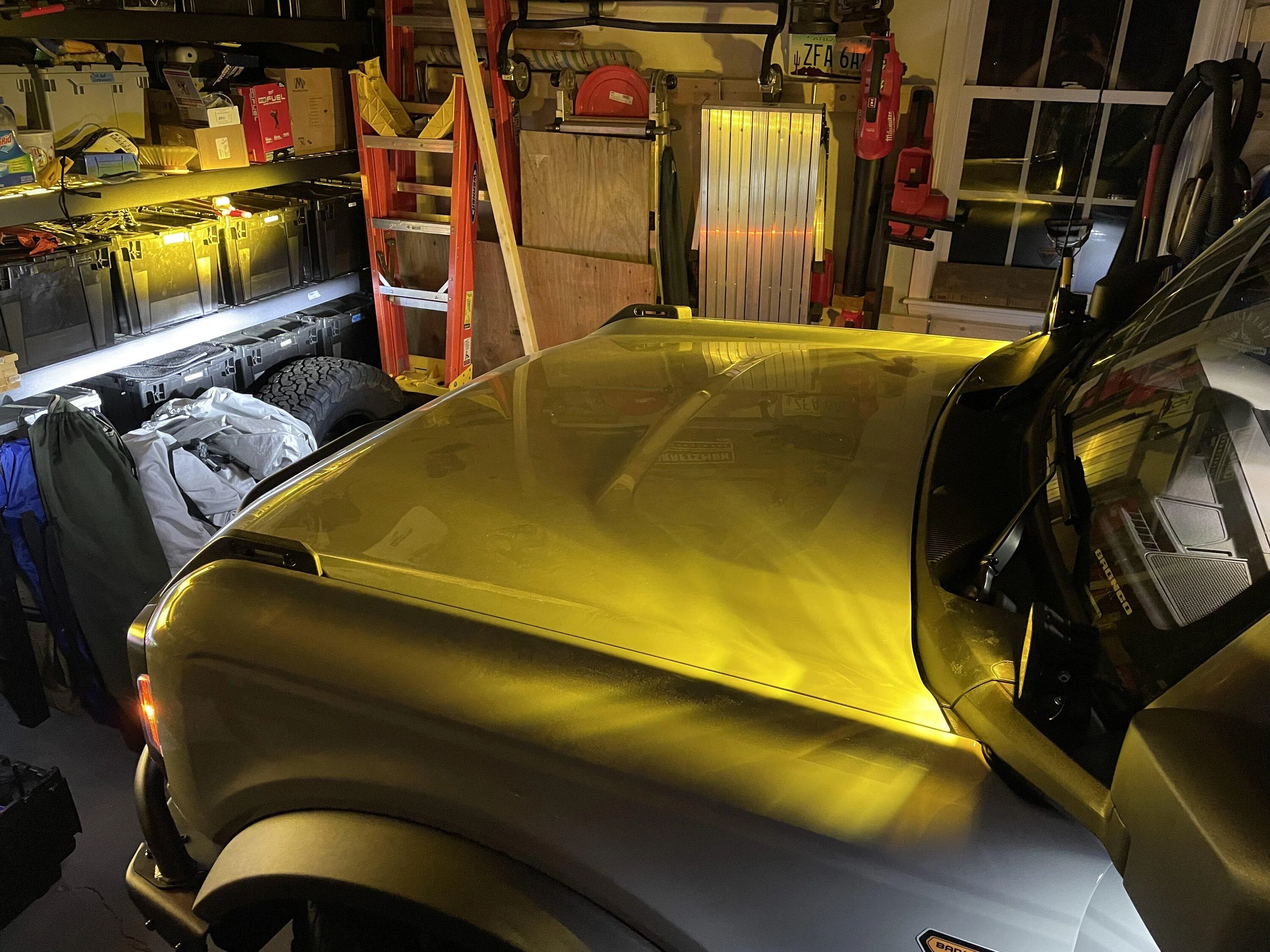

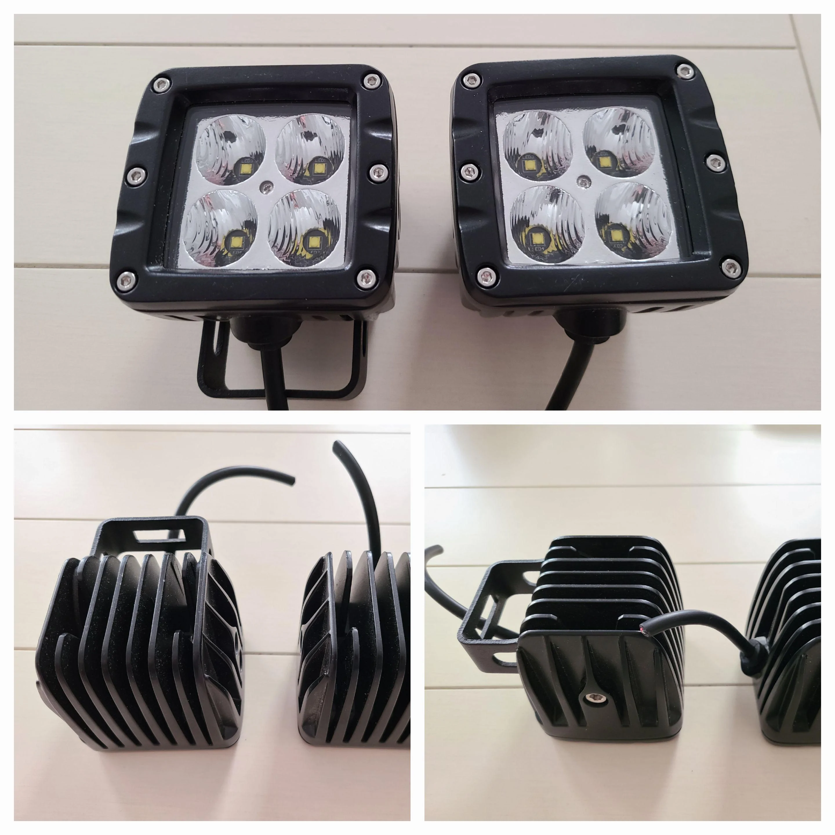

I’m not sure how to link but here is without and with them on. They went up a little in price

Those are just some "amazon special" lights. Honestly, pretty much garbage. They'll do the job for you but won't focus the light anywhere and will rust within a few months and eventually get water inside.
They'll do the job for you now but honestly if you want a good set of ditch lights check out Baja Designs or Diode Dynamics: https://www.4x4truckleds.com/vehicle-specific/ford-bronco/2021-bronco/
If you do decide to use those, get yourself a harness. THIS harness will work but you'll need to cut the plugs off our harness to give you a positive and negative wire to splice onto those lights: https://www.4x4truckleds.com/crystalux-a-pillar-wiring-harness-2x-wp-2-pin-connectors-baja-designs/

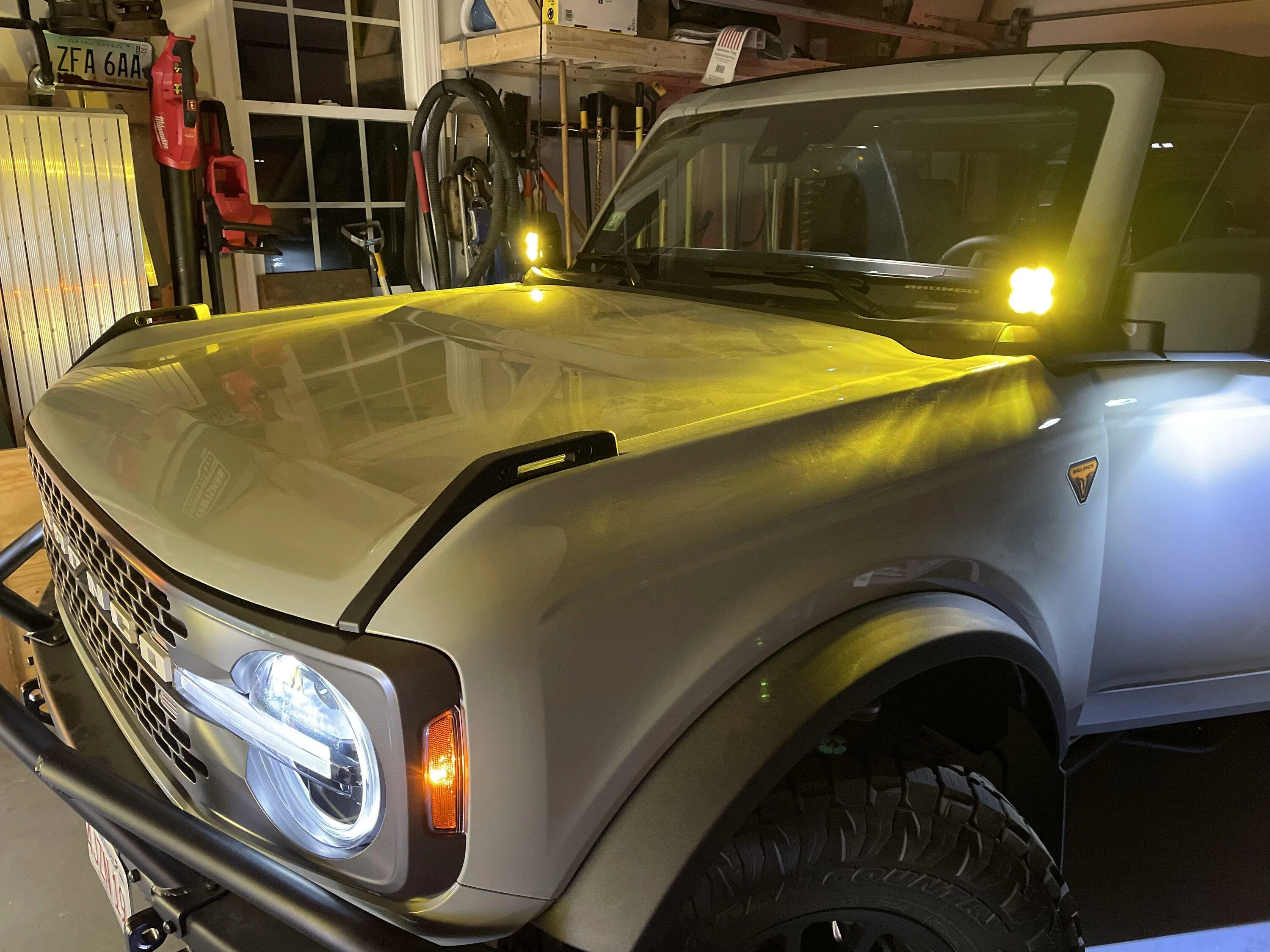

I run the Diode Dynamics Sport SAE Driving in amber on the pillars. I’m happy with the result on the off chance I get to use them. I bought Pro for everything else, but these work great in Sport because of the tighter beam.
