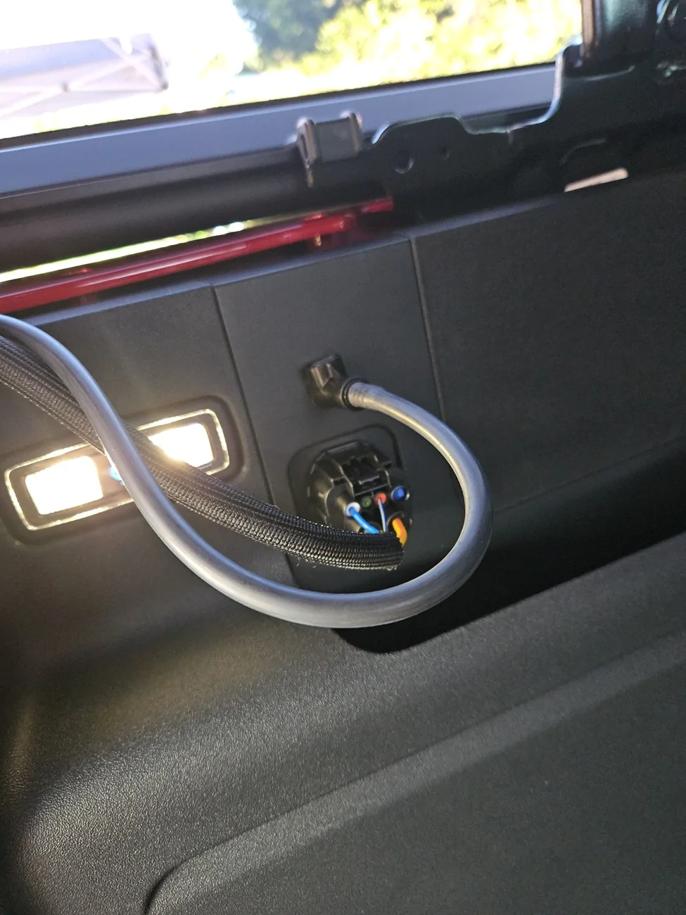

Greetings all,
I just took delivery of my 2025 Big Bend. I noticed this in the cargo area:
Ford Bronco What is this? 1000017451
What exactly are this hose and wire connector thingy for?
Thanks,
Doom
Thulsadoom
Oct 15, 2025
Hawaii
2012 Ram 2500 Power Wagon
I suspected as much, only thing I could think of for a hose. I have a soft top. Remove, let it be, lazy Ford/dealer, or just part of a package even though no hard top? 🤔
I think Ford calls it the hard top prep kit. That way if you ever get a hardtop, you're covered.
Not lazy, that is just standard. If you ever buy a hard top then you are ready. Not any different than the wiring harness being ready to install a hitch.

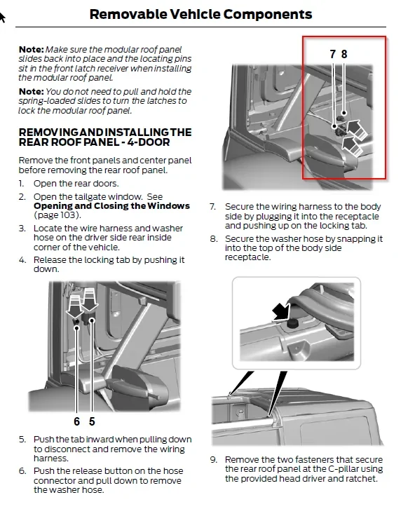

Time to DRINK again. This came up Tuesday as well. It was once a weekly thing.
Looking at the Owners Manual may not help as it is pretty well hidden here:

My apologies. It didn't even occur to me to check the owners manual. The digital manual seems less than helpful. Anywho, stand by for pic of tequila shot...
