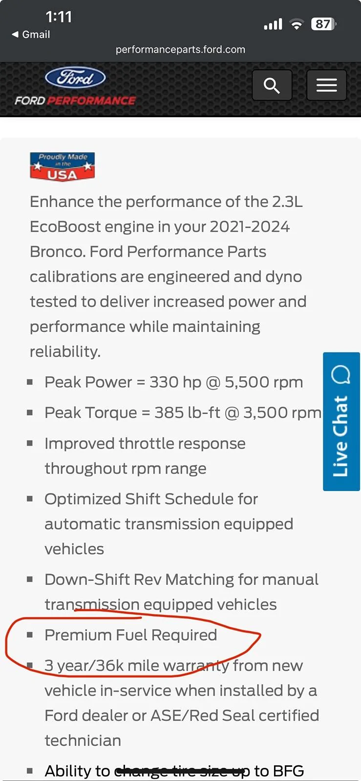

Requires premium, also includes downshift rev matching for manuals. Must have for manual, IMO.
Does NOT require premium (93 Octane) to RUN, only for advertised power increase. That said, I sure wouldn't run 87... ever. Not on a boosted engine. Runs fine on 91 in a pinch, but definitely noticeable power difference if you go from a full tank down to less than 50 DTE then fill with 91. In my case, 2.3L so every little bit is more noticeable than a V engine
Edit: dog got in my way when correcting the word "than."
I mean, according to Ford premium fuel IS required… sure, the motor will still technically operate at 87.
For the people who want to add it but are afraid they don't have 93 available near them, 91 is fine, but your "numbers" won't be as advertised. Don't have 93 nearby? 91 is fine. That's what I was trying to get across
