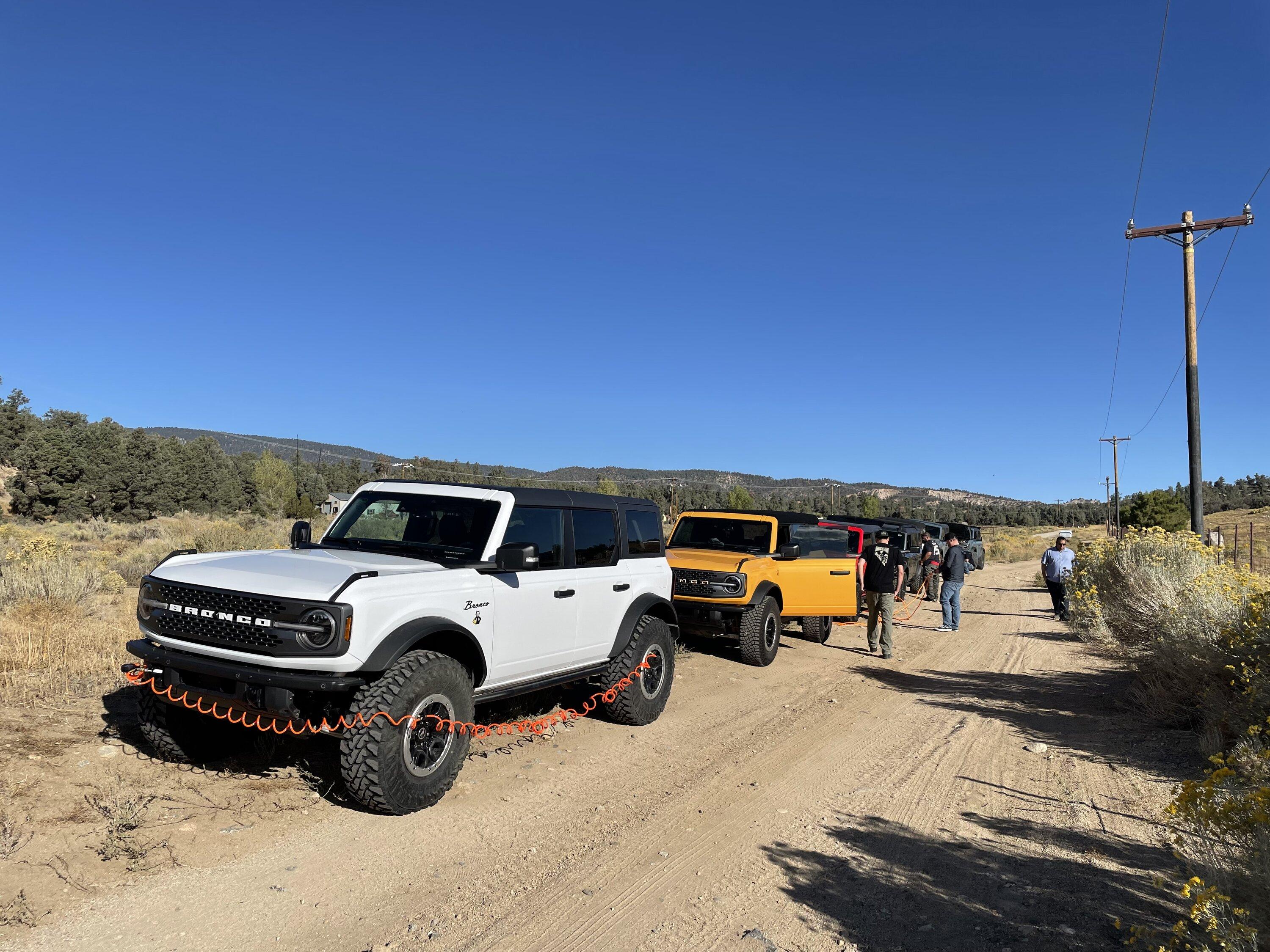

We’re brand new to off-roading, owned the Bronco for 1 week, we own the same compressor. Do you have a photo of your system to air up all 4 at the same time? Much appreciated.
It's a quick flate system. I've since shortened the hoses. They also make a flat hose system vice the coil I have. I got the coil system to keep it up off the ground, but thinking back the flat hose would be easier to manage as it get a bit tangled & is why I shortened the hoses. I also changed out the valve to a brass ball valve as the plastic valve handle got soft & almost melted. It's much easier to open & close now 🤠.
Where in CA are you located?
Nice! Thanks so much for the info! We’re in Sonoma County.

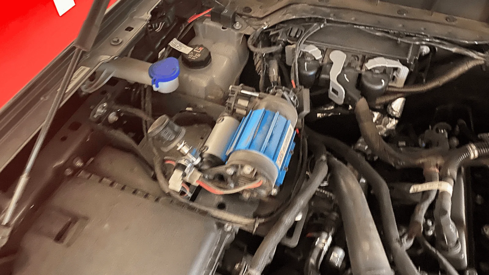

I use the ARB single air compressor mounted under the hood. Works great.
  • On road 37psi
  • Trails 30psi
The single compressor works great for those minor pressure differences.
To deflate, I just use the ARB air chuck. Nothing special.
