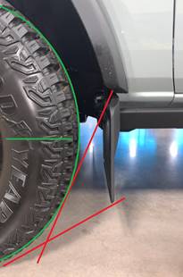

Seems like they missed the point of mud flaps. That just looks half ass done.
Ford Bronco Weather Tech Mud Flaps for Wildtrack installed image006
This pic came from Weathertech Engineering.
Everyone who has installed them comment on how well they work...especially for the price.

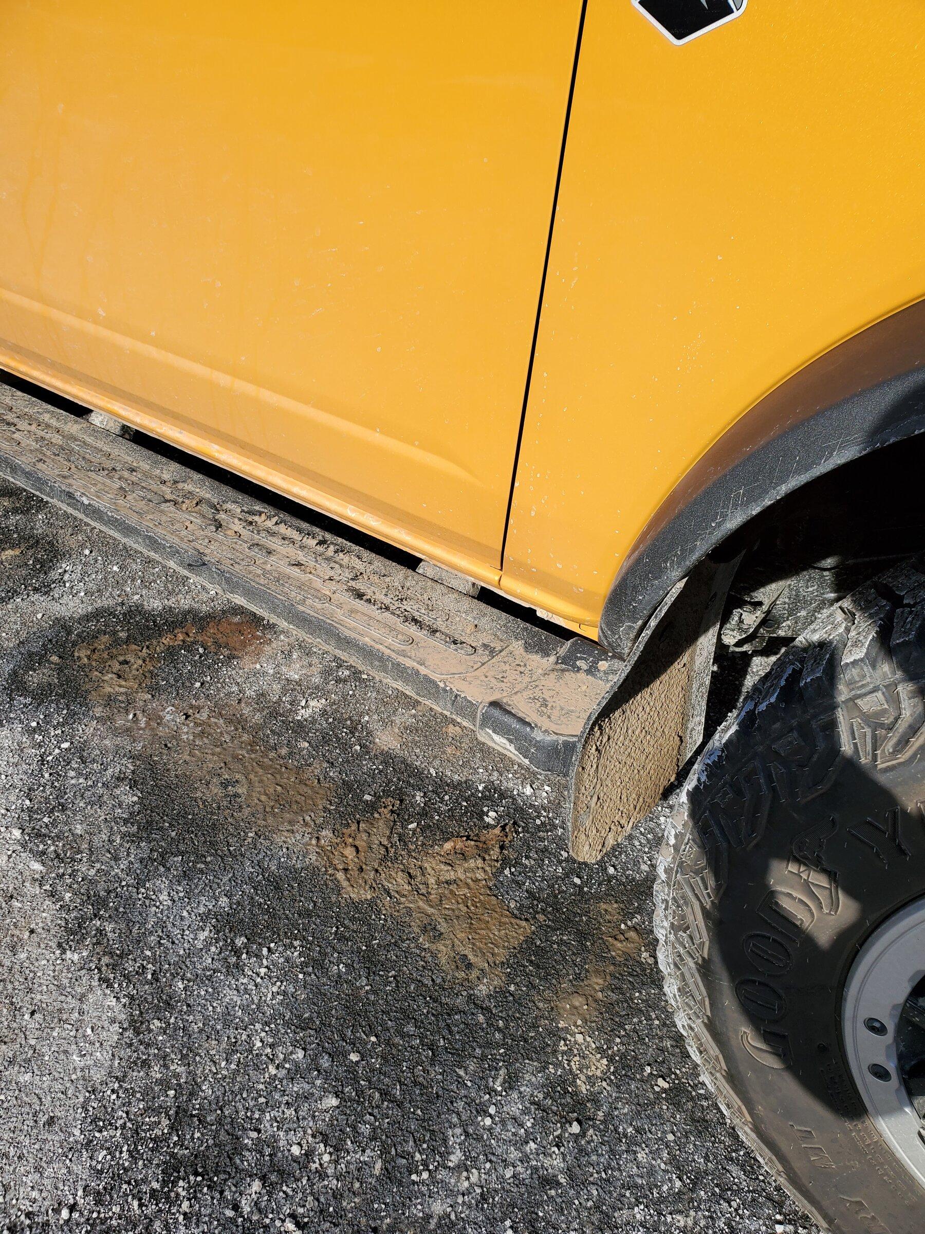

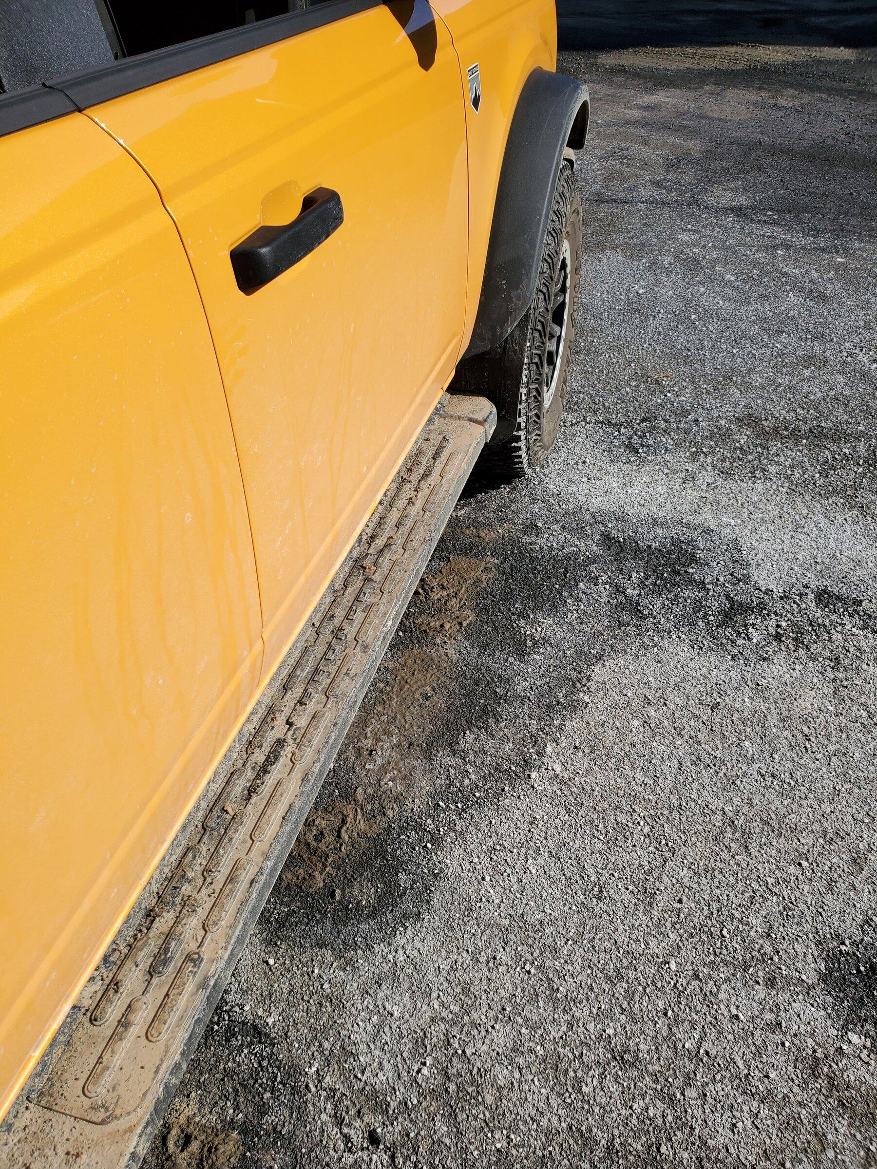

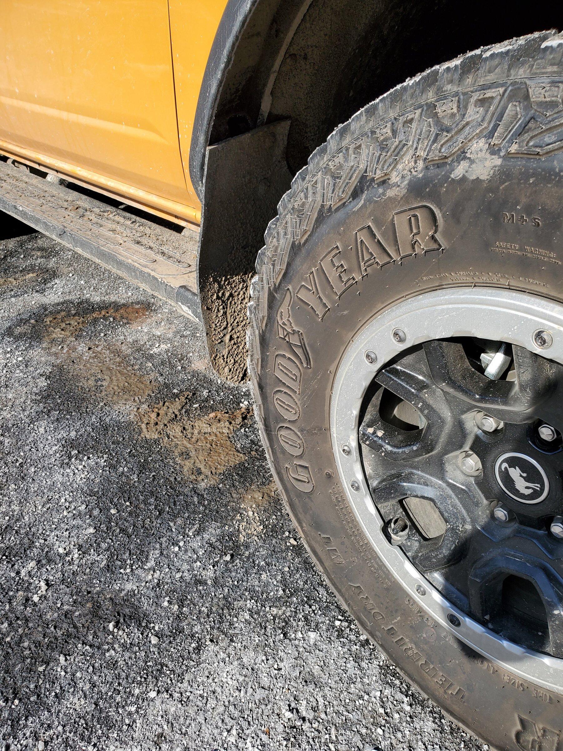

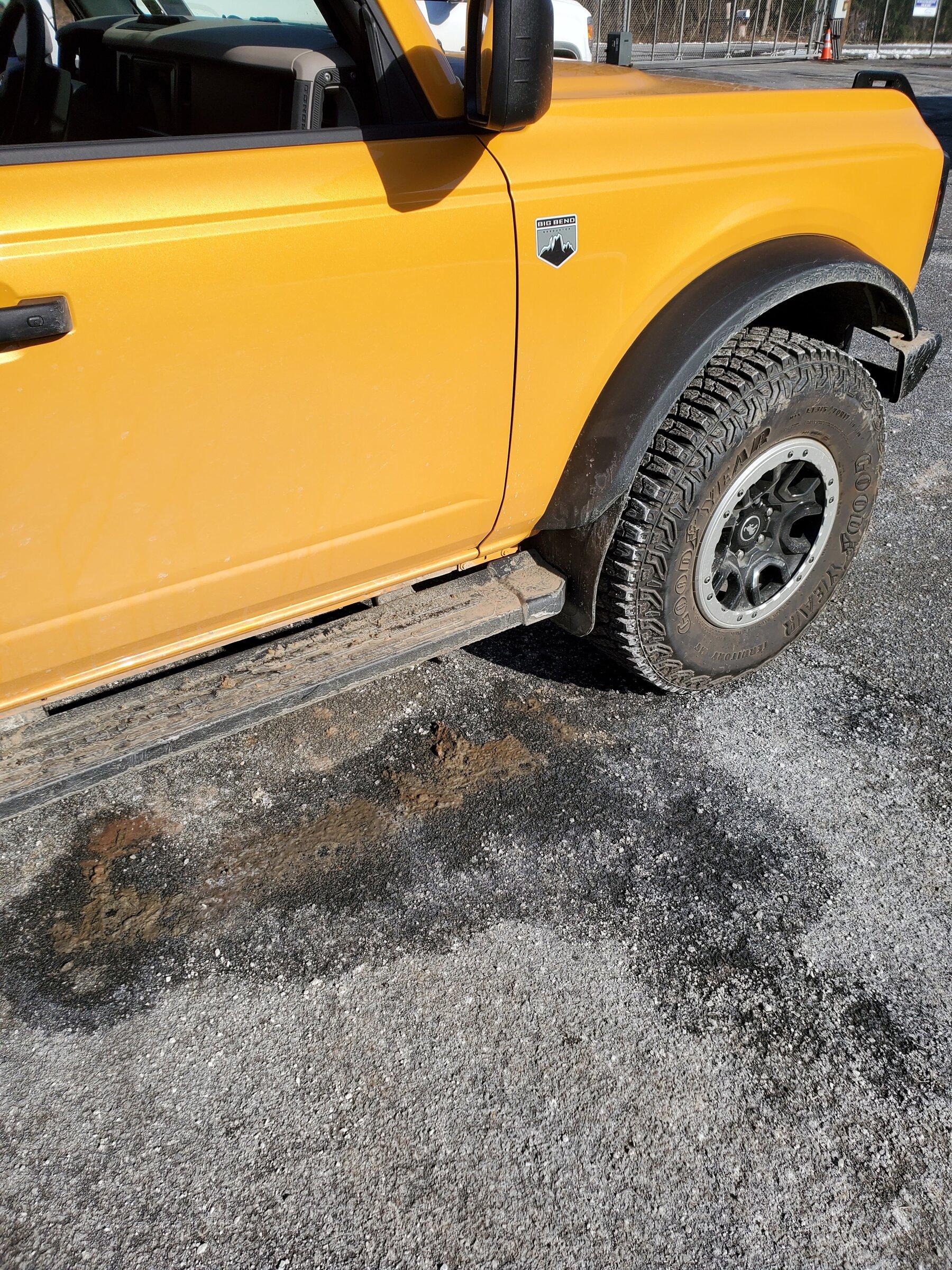

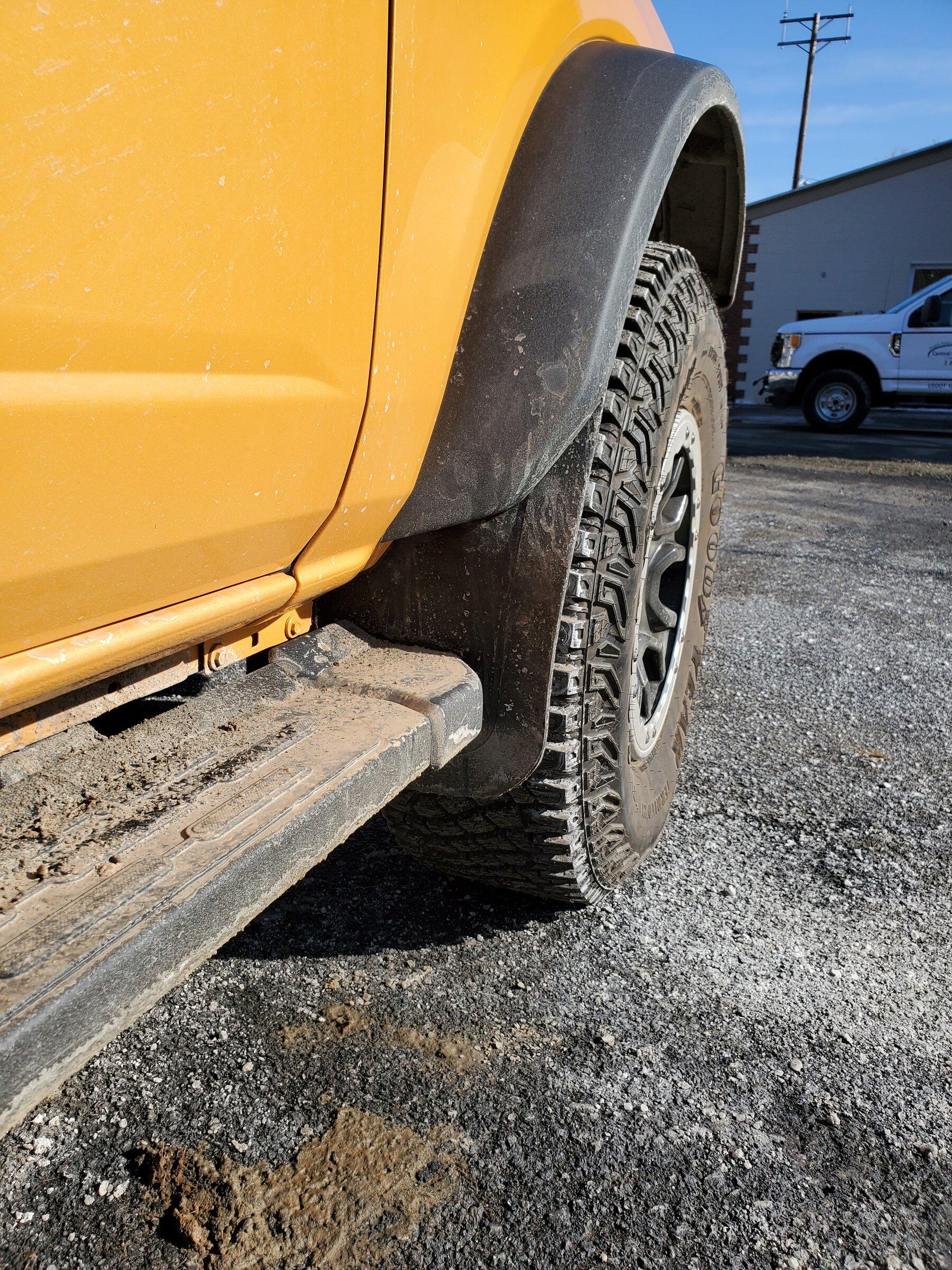

Hey everyone this is my first time posting here. I've had my big bend sasquatch for two weeks and can definitely say it throws some debris. I had seen all the talk about the issue. I have running boards so mud flaps are a little more difficult. I like to try and do as much hands on as I can so this was my attempt. Bought some heavy truck mud flaps. They come as a big square I think mine were 24 x 24. About 15 bucks each. I cut them in half and trimmed the top down. Removed four lower push pin rivets holding inner fender, drilled the mud flaps to fit hold placement and installed longer plastic push pin rivets. Seems to be keeping the mud and snow and rocks down alot. Not afraid to hit some nasty spots any more. These pictures are after 3 days of driving though a 6 inch snow with sanded and salted roads. Also a 5 mile drive on a all dirt road. I still need to get the rears done in a similar way. Hope this may help some people with similar set ups.
Ford Bronco Weather Tech Mud Flaps for Wildtrack installed 20220314_155355
Ford Bronco Weather Tech Mud Flaps for Wildtrack installed 20220314_155349
Ford Bronco Weather Tech Mud Flaps for Wildtrack installed 20220314_155340
Ford Bronco Weather Tech Mud Flaps for Wildtrack installed 20220314_155328
Ford Bronco Weather Tech Mud Flaps for Wildtrack installed 20220314_155321

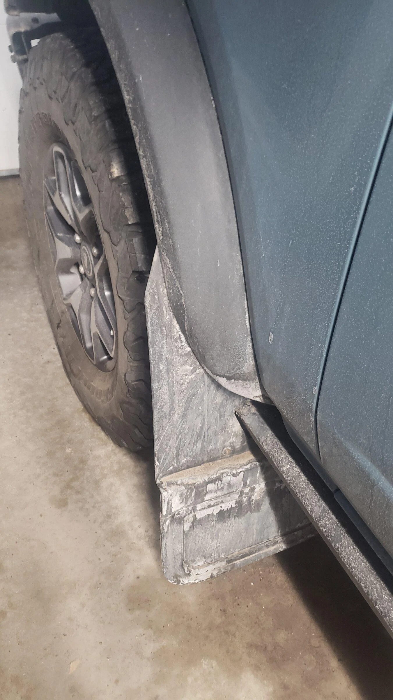

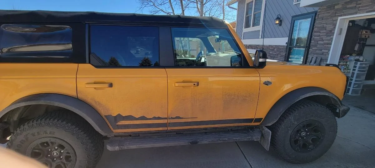

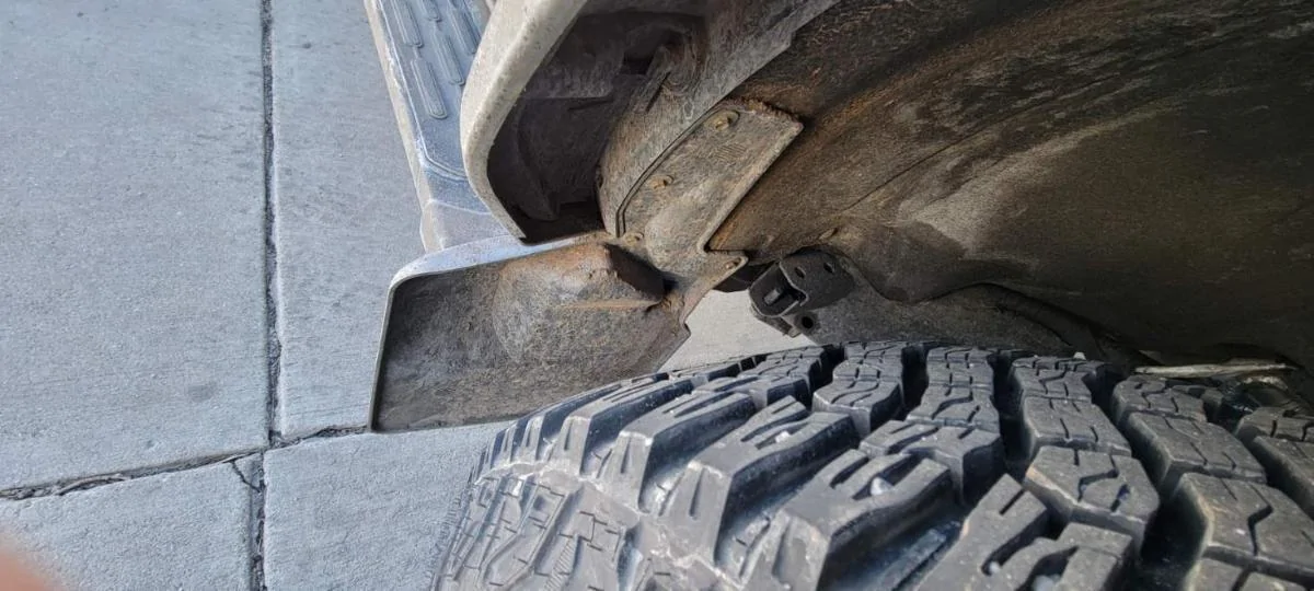

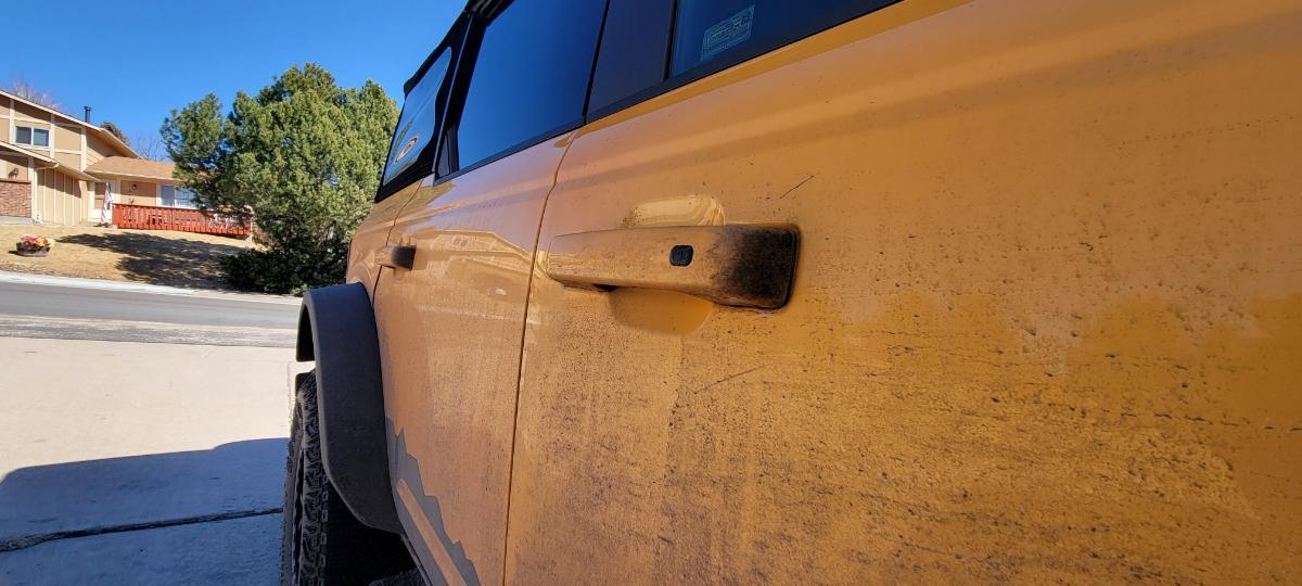

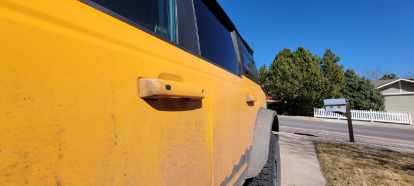

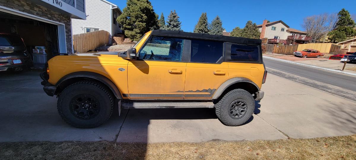

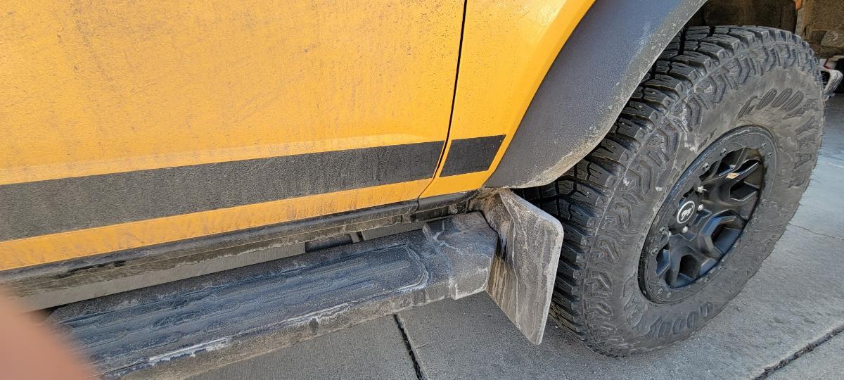

Have had mine on a few weeks with snow and sand on the roads. Not hearing any loud bangs on the underside from rocks being thrown. I will take some pix with 2 weeks of slush driving on them. As stated earlier, no dirt on the door handles.
Ford Bronco Weather Tech Mud Flaps for Wildtrack installed mud flaps 1
Ford Bronco Weather Tech Mud Flaps for Wildtrack installed mud flaps 2
Ford Bronco Weather Tech Mud Flaps for Wildtrack installed mud flaps 3
Ford Bronco Weather Tech Mud Flaps for Wildtrack installed mud flaps 4
Ford Bronco Weather Tech Mud Flaps for Wildtrack installed mud flaps 5
The dirt you see is spray and not actual mud/sand being thrown up by the tires.

Good illustration, Cat. Unless the tires are spitting stones at a standstill, light spray is about the only thing exiting the gap.
