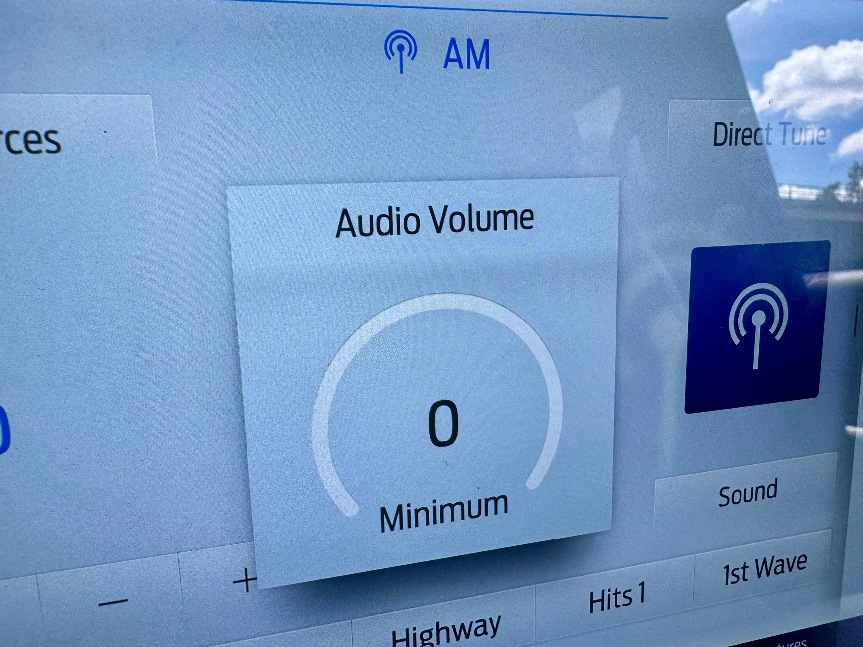

The volume control was working fine when I got home. Woke up the next morning, started the Bronco up, and it won’t work anymore. No matter which way I turn the knob it just sits at zero like in the below picture. I have tried adjusting it on the dash and steering wheel. It doesn’t matter if I use CarPlay, FM/AM radio, or SiriusXM. I tried doing the Sync reset and even unhooking the negative terminal of the battery and rebooking it back up. Nothing has worked. Did I blow a fuse or something?
You didn't spill beer in there, didja? lol
