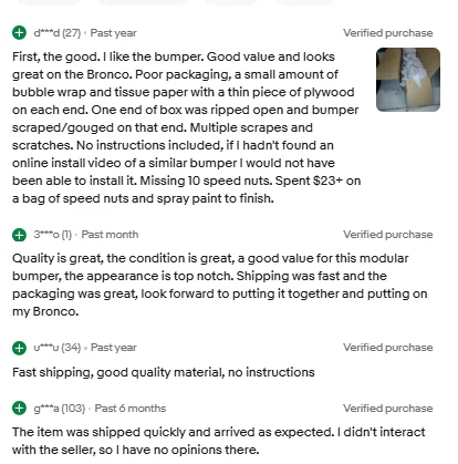

Give it shot... seller accepts returns.
Did you look at the reviews?
