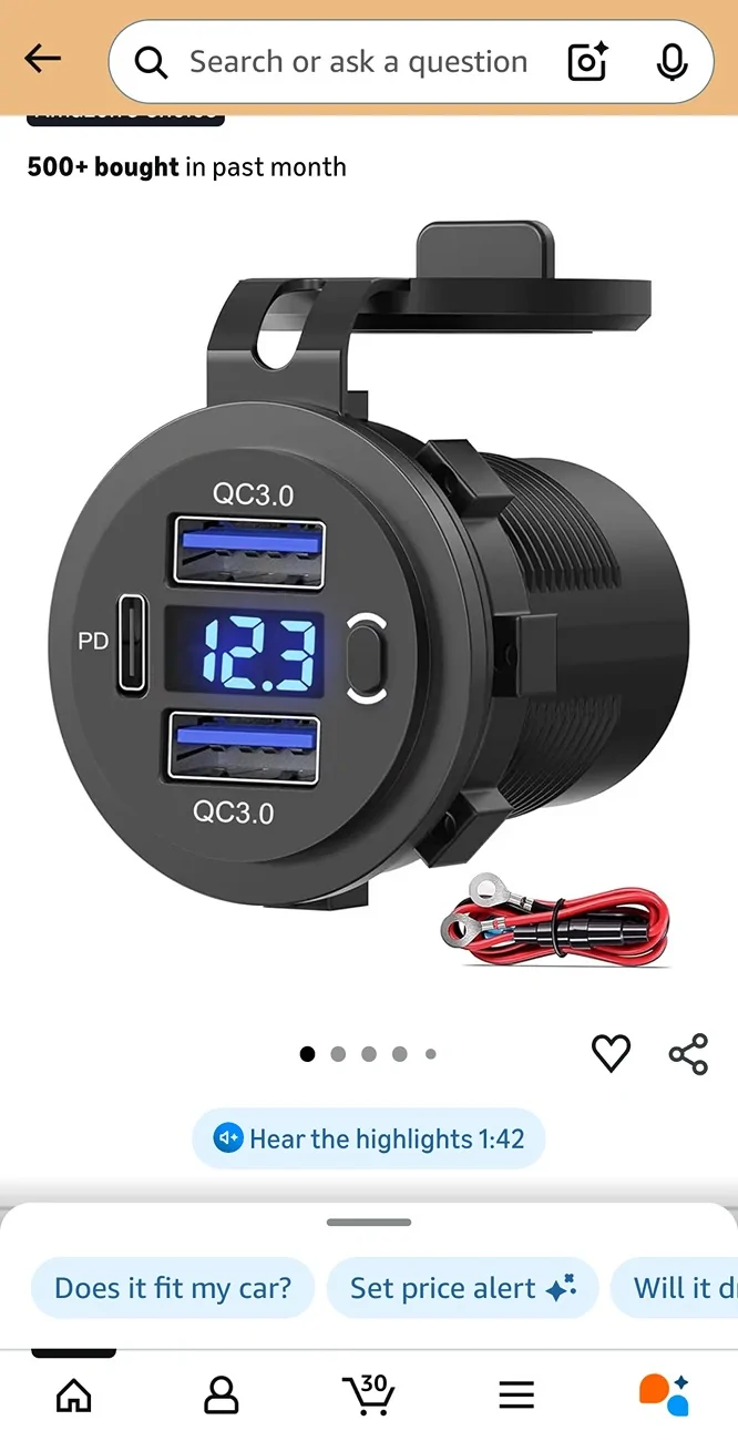

Yeah, I replaced the usbs by the windshield with this

I installed something similar to this one, replacing the factory part.
How complicated was it?

As far as I remember it was easy. Just pop up the center dash panel then remove and replace the factory part with the new one.
Definitely gonna try that this week. Thank you.
