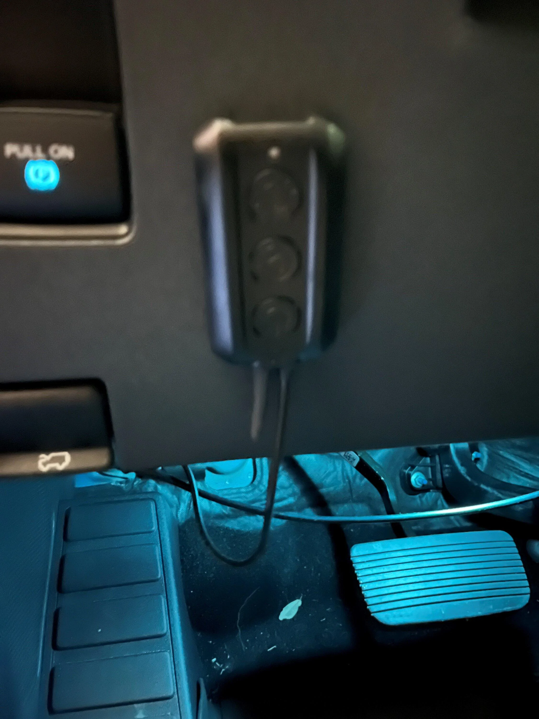

same ones we got, but rbg. we wanted as little cables as possible underneath. my installer hooked it up to an aux switch and we keep the switch on. we do have to turn the lights on from the remote as they go off when the bronco is turned off or from aux to start, if we have them on when in aux. he mounted the remote just beside the hood release.
as far as your recommendation for simple solutions, sorry i cant answer that. i dont have that knowledge. :) sorry for the blurry picture, but you get the idea.
Exact same issue I have. Aux switch is basically just a kill switch because even though you leave it on, the remote resets and you have to mess with the remote to turn on each time. I know there is a way to avoid this at least with a single color light but trying to keep the wiring as simple as possible.

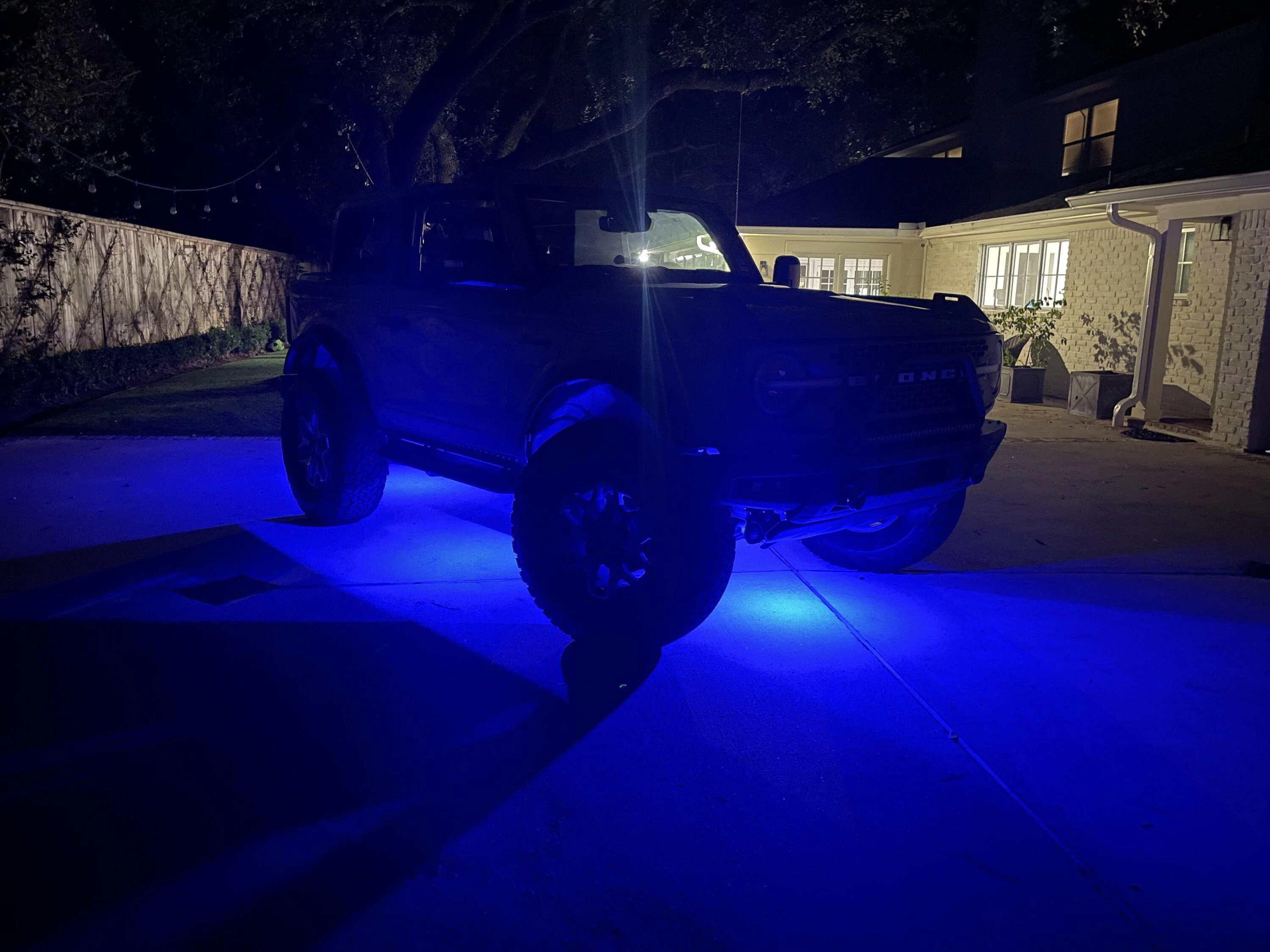

I’m really happy with how my lux lighting 8 light kit turned out. Good coverage and really bright. And as promised my shop wired it to aux 5 and when I start the car and flip the aux switch, the light remembers the last setting. Just what I wanted. Only snapped one night picture before we left out of town.
